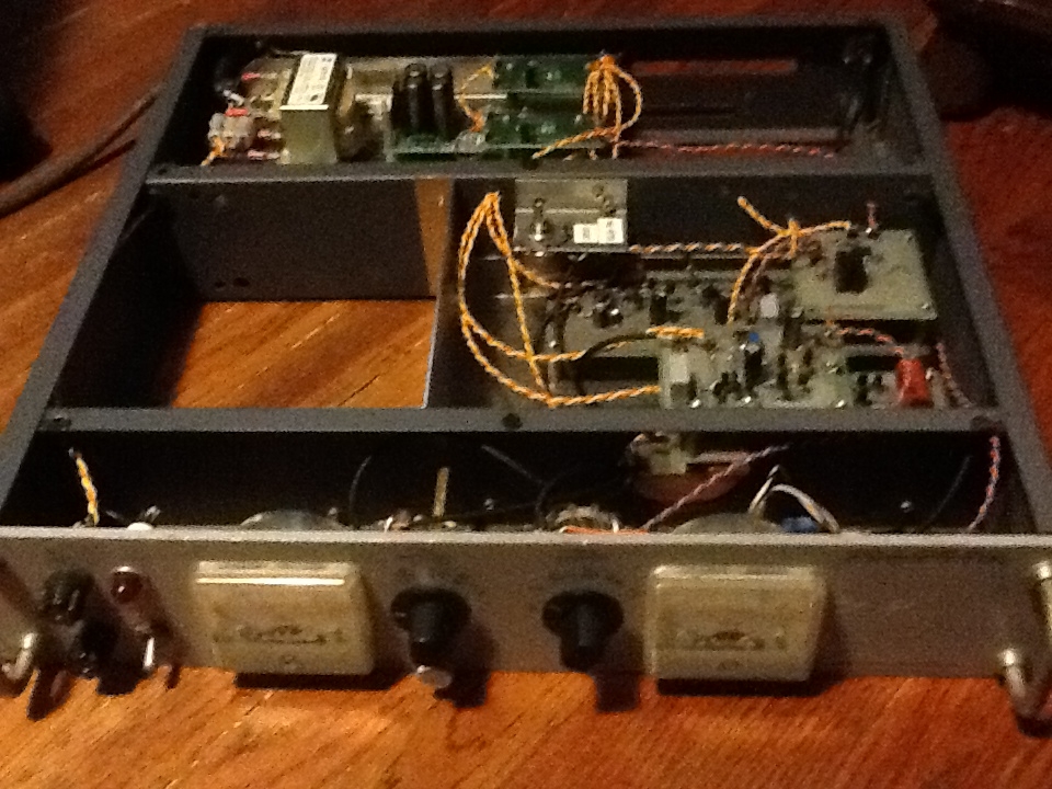

I also have a 5173. Did you get any of the socket adapters? Mine came with one and I built another. My manual has no documentation on the adapters. I would really like to figure out one for dual transistors but I see no way to implement it in the box.
I have an IC Adapter (shown below) and the transistor adapter:

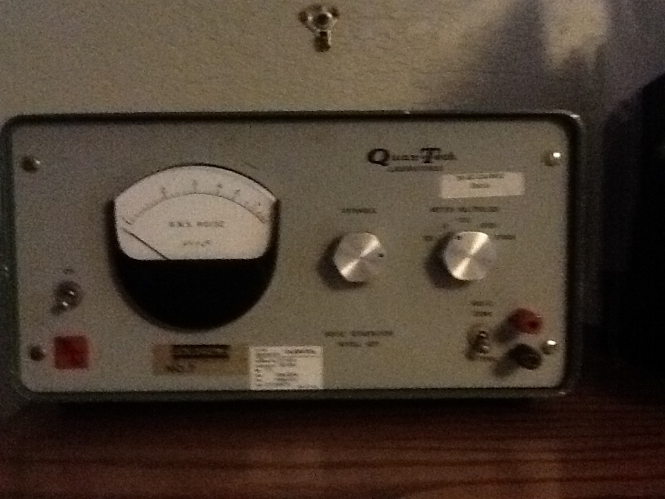

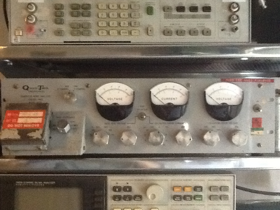

since we're sharing photos, mine are older than yours :D
Order left to right, 2173c, 420 noise generator, 2181 self made into old Harris lab supply chassis.

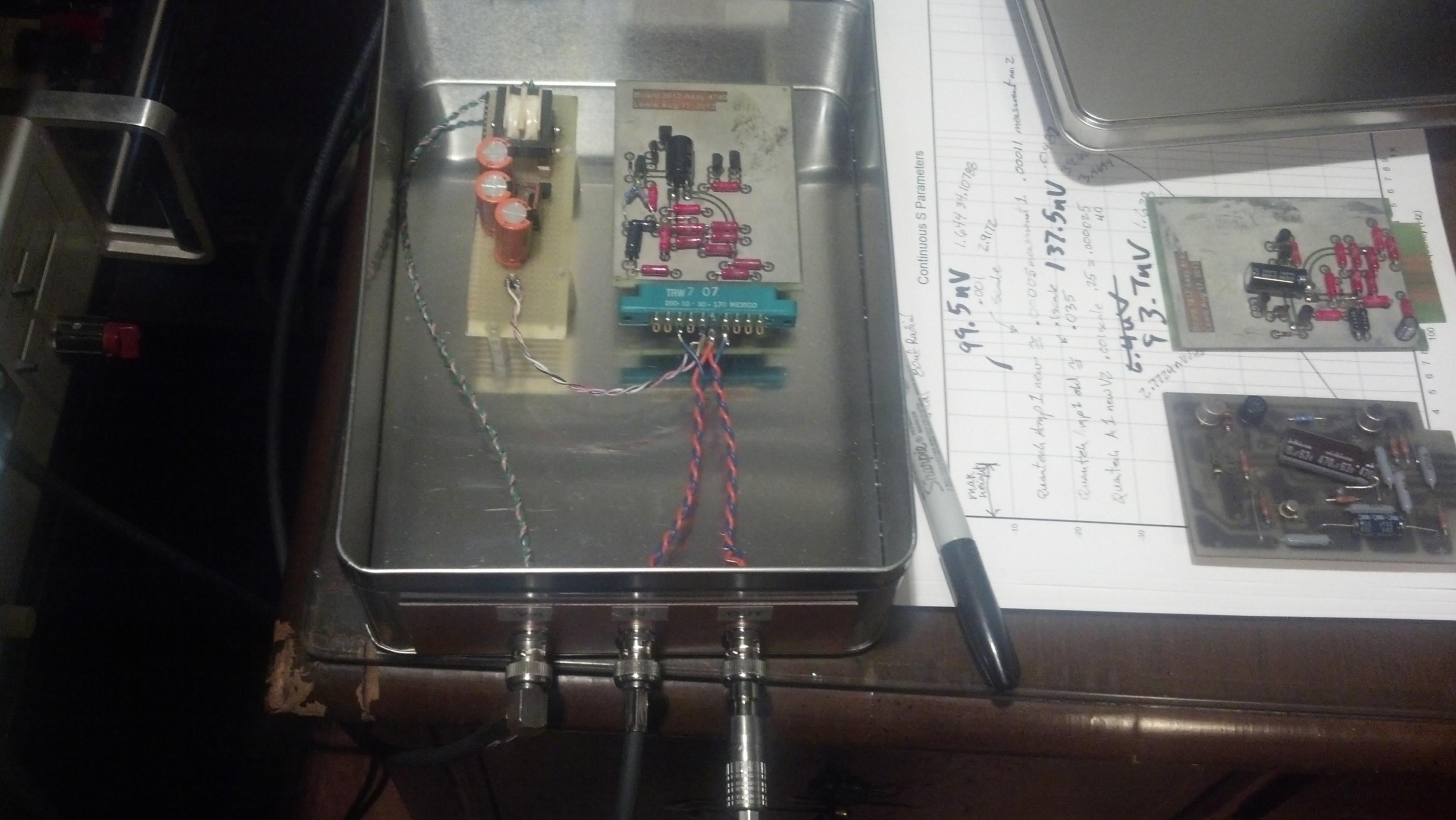

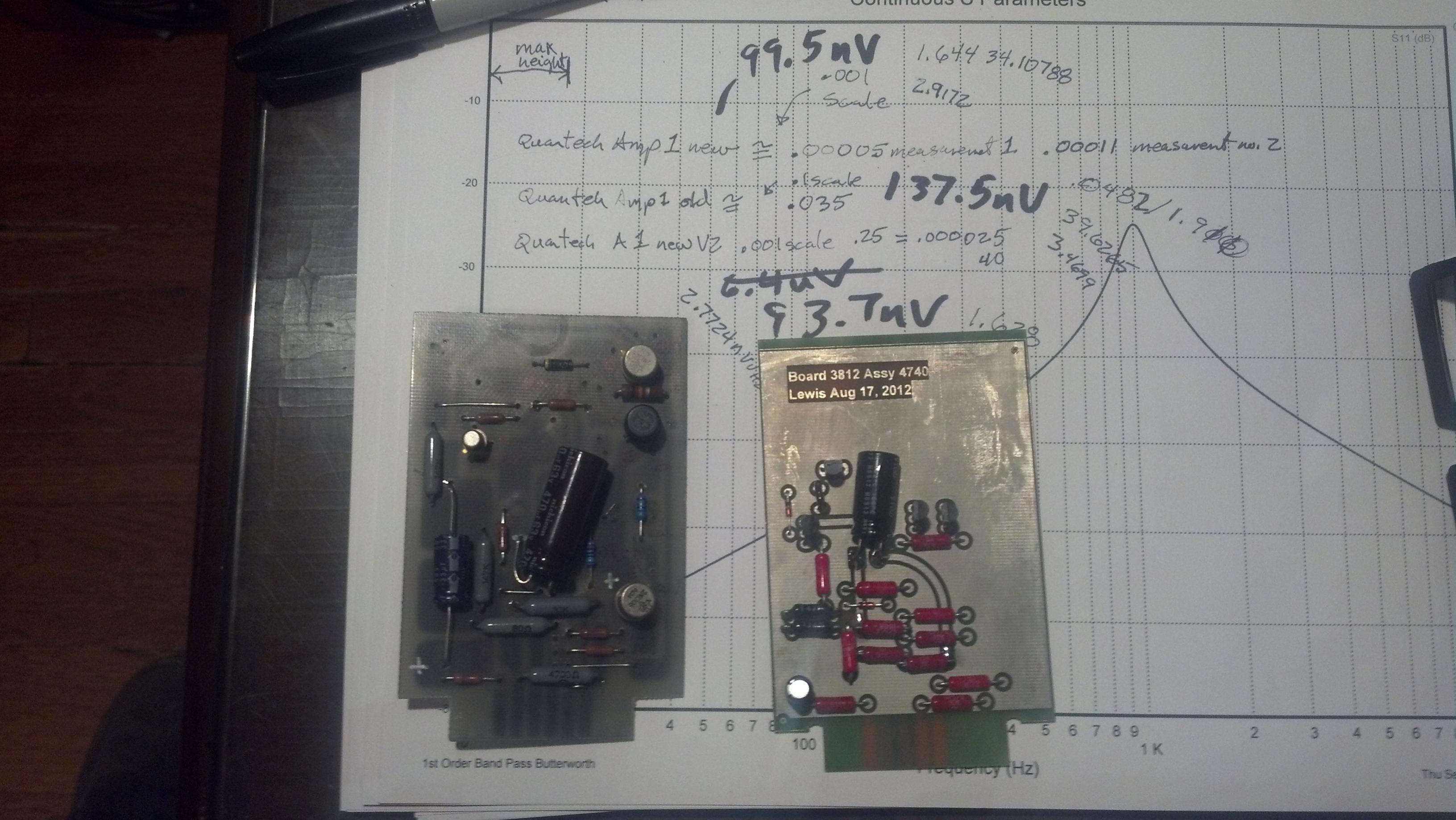

Thought I would post an update on the progress with the quantech 2171c. I made replacement boards for the Amp 1 - (similar to schematic in post 78 except next newer of the 2173c) I used a 2sa1015 for Q1108, a 2n5089 for Q1109, a 2n3906 for Q1110 and a 2n3904 for Q1111.
The spectrum for each looks similar. I measured the noise for each at 1kHz with the input terminated with a 50ohm BNC. (I can't find a 0 ohm BNC terminator) I divided the noise by the gain - measured the gain separately for each -
The original with the carbon resistors replaced by dale RN55's = 3.47nVsqrtHz self noise.
The new version 2.77nVsqrtHz.
I purchase replacement caps for the power supply and will implement the JFET switch next.
