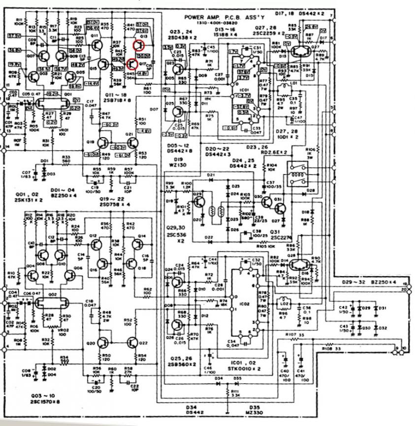

How did I blow this fisher BA6000
I have this fisher BA6000 with the stk0100ii power amp chip.
That amp came to me with a dead stk chip, I pulled the good chip and put it in he other ba6000 I had and sold that.
So now I needed 2 stk0100ii's which I got and installed in this amp.
It worked for about 2 hours at about around 1/3rd-1/2 volume. Then I saw 1 meter was not working, so I tapped like you knock on a door :smash: on the case just on top of that meter. I heard a pop in the speakers and the amp is dead.
The stk's have been removed and the safety relay clicks. There is no obviously burnt spots in the board. I can replace the stk's but is that all there is to it ?
This is the schematic. I have a feeling one or more of you guys would knock this out of the park like you did with my nad meter pegging issue.
Thanks guys.

You don't say who you dealt with to replace those "hybrids". If they were pulls from scrapped amplifiers, it's likely they were marginal or already blown in one transistor, as you describe above. There is no real guarantee that pulls are fully functional and many that have been bought over the last 10 years or so, to nurse old amplifiers back to life, have to be returned for credit - not really a viable way to do business.
If the power supply rail voltages are correct and remain within acceptable limits under load, only thermal runaway or any DC above the correct marked bias level at R52,62/R51,61 would cause failure of these Darlington output stages (which is all the Hybrid modules are) unless they are driving a significantly heavy load or there is a short at the output. The protection circuits themselves are simple current limiters (Q25,26/23,24) and DC speaker protection (Q27-31), for both channels) so it is just a matter of time for this amplifier to fail due to unusual speaker loads, faults, intermittent shorts etc.
Check the voltages marked on the schematic of the upper channel. If there are significant differences in DC readings at the output (R95,96), for instance, it will be a failed module as you say. Then go on to compare DC measurements between relevant areas of the channels as they are shown - I can't read them on this attachment, perhaps others can. If everything up to the hybrids is OK within a few % and they were correctly fastened to the heatsinks, you only have the hybrids themselves or the output wiring and load to blame. There are other possibilities, but without other indications, this is more likely, I think.

The schematic is pretty awful, but it looks as if the power meters are really just looking at the output voltage from the power amplifier. So they'd connect to any amp really. The peak LED's appear to be driven by a comparator type circuit monitoring the voltage drop over one of the output emitter resistors (eg R77).
What may be confusing is that there are two sets of power supplies, +/-58V for the output stage and +/- 66V for the input stage. That's used to get the maximum drive from the output transistors. You could easily ignore that on a replacement amp and just use the 58V supplies.
That sort of power level is out of range for chip amps really. So you'd be looking for a circuit that's at least 2 pairs of output transistors per channel, something advertised for +/- 55v supplies - the extra few volts wont make much difference.
The protection circuit is nothing special - it is just a DC detect circuit. Plenty of kits to do that, or roll your own. Maybe reuse the existing relay if it's in good condition.
You can't use the STK4046 in the way youre thinking - the 4046 is a complete power amplifier that takes a line level input, and the STK0100 is just an output stage. As Ian points out, you COULD make a replacement for the STK0100 fairly easily - the datasheet shows it's equivalent circuit, it is a triple darlington type output stage.

Looking @ the circuit of the amp: stk0100ii - 0 and 1 get audio input. Pins 3 and 8 produce the output which is merged into 1 with resistors etc and sent to the protect circuit.
4, 5, 6, 7 are essentially not required. They are externally capacitored - internally ... no idea.
2 and 9 get B+ and B-.
