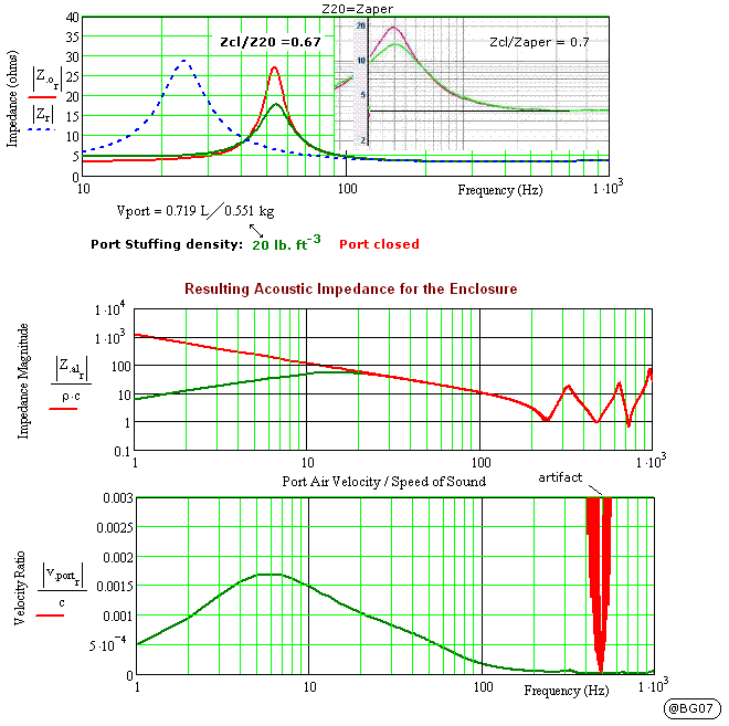

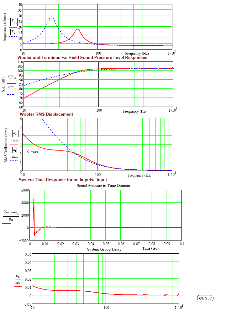

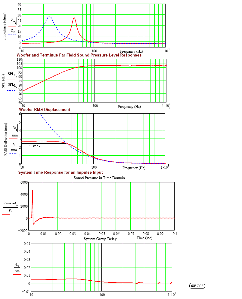

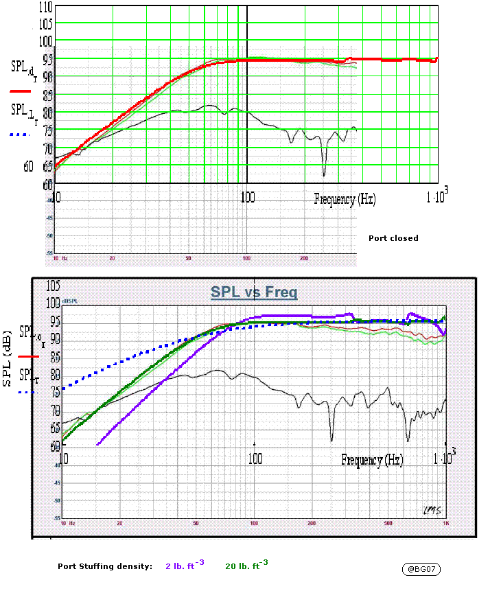

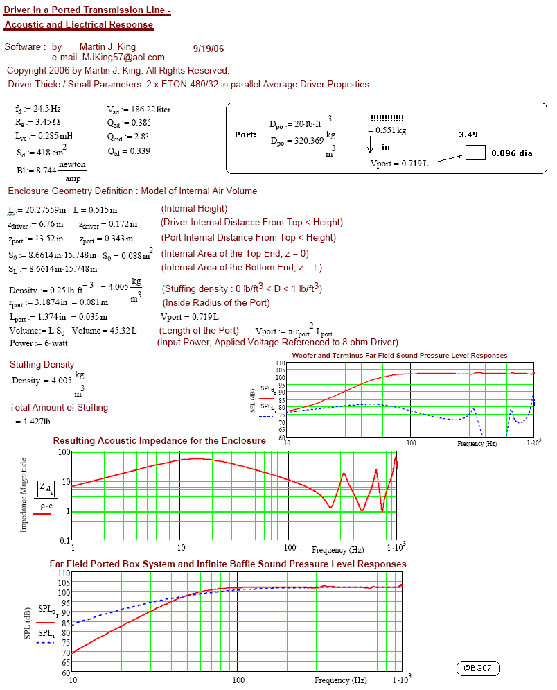

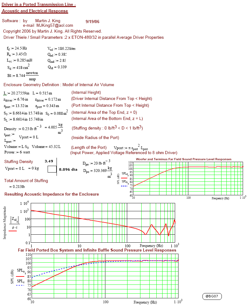

FYI; I’ve used Dave T: s speaker’s data and definition with one of MJK: s programs in order to find out if it’s possible to simulate an aperiodic port.
MJK: s graphs overlaid on Dave T: s plots fits very good but I must admit there could be a mistake when using damping material with higher densities (up to 20 lb/ft^3) than what MJK: s guaranteed limits is = 1 lb/ft^3 maximum and how limited this damping coefficient function is for accepting other input numbers than recommended.
My simple method was to step the density until the speaker impedance at box resonance lowered to about a comparable value that you have shown us in your plots.
There is a linear proportional behaviour when stepping the densities and in reality this is exactly what you can observe when measuring different stuffing densities in an aperiodic port, especially if the damping material is denser than normal box stuffing.
Nevertheless the plausible result is there even if this increase in density affects the damping coefficient a lot and could as been said; be completely wrong. But who knows?
See the first three plots I’ve made overlaying Dave T: s the MJK: s and then the remaining 4 that are plots of the closed and aperiodic boxes.
