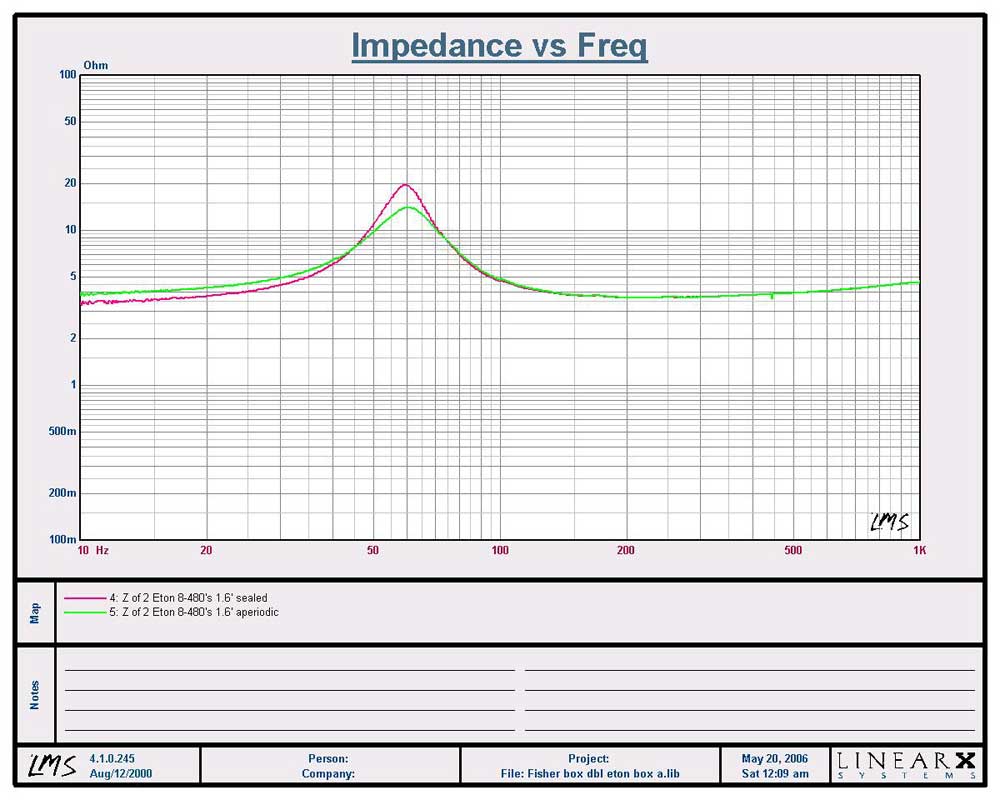

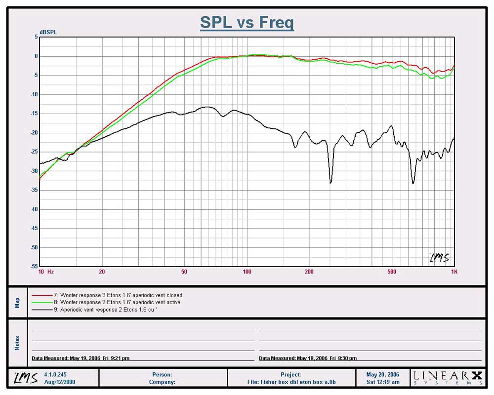

O.K Anli here it is. I dug it out and re-tested today.
The box: An old fisher xp-7 box which I rebraced, re-baffled and tightened up a lot. By the time I was done, I decided it would have been better and easier to just build new ones. It is 1.6 cubic ft. net. - after the drivers, bracing etc. It is also packed with egg crate mattress pad foam. There is a hole cut in the back of the box for a 3" cardboard tube vent. I reinforced the rear wall, so when left bare, the hole is 1-3/8 deep by 3-3/16 wide. (I wish the U.S. would convert to the metric system). Over this the aperiodic frame is placed when in use. The frame is much wider than the vent hole, to be used in other applications.
The drivers: 2-Eton 8-480-32 hex. They are wired in parallel, and acousticaly they are not separated inside the box. In other words wile the box is in sealed mode, if you push on one, the other will move out. IMO this is almost the perfect situation to use an aperiodic. Both drivers in this box are simply two much for it. They need at least 1cu. ft. each when sealed. Between the loads of stuffing, and the aper. vent, I was trying to make this box as "effectively large" as i could.
The testing: L.M.S. by Linearx was used. On all graphs it was set for the max of 800 data points, and set between 10hz to 1khz, to get as much resolution on the low end as possible.
[See next post for Z graphs]
On the z graphs, you can see that the frequency of the impedance peaks are almost the same, but not quite. The aper. graph has a peak about 2hz higher than the sealed graph. Obviously the Z peak is reduced about 6 ohms with the aper. vent in use. That may not seem like much, but keep in mind the box is stuffed more than your average turkey, so when sealed the Z peak will be about as low as you can get it. Notice on the left side of the aper. graph, it runs about 1/2 ohm higher than the sealed box, all the way down to 10HZ.
On the S.P.L. graphs, you can see that they are very close, but there is something going on that I can't explain: The left part of the aper. graph runs about 1db lower than the sealed graph. I hope other people here, can take a stab at explaining that one. I've tried a few aperiodic enclosures, and this happens every time. Can it be as simple as phase cancellation by the aper. vent? The black graph is the aperiodic vent, close miked, at the exact same distance as the woofer (about3/8".)

Dave,
Thanks a lot for your long report about your experiments! I have a food to think now
My humble English prevents me to understand all. Can you clarify some details?
- how do drivers located against each other? As I can understand (one is ON while the other is OFF), at this case internal volume is constant, and variovent influence must be reduced very significantly,
- have not understood "the hole is 1-3/8 deep by 3-3/16 wide". Does it mean something like "1 _and_ 3/8 inches" ans "3 _and_ 3/16 inches"?
