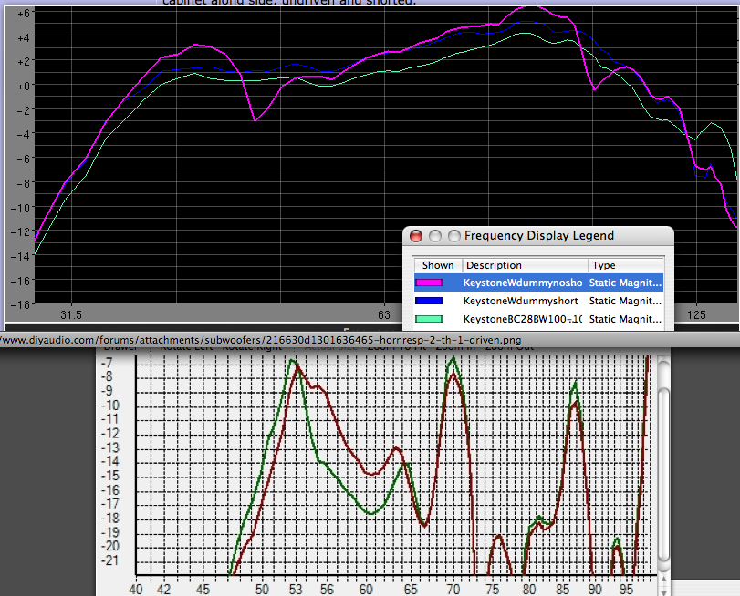

Brian,
The response curve changes of our THs with an adjacent, un-shorted, un-driven cabinet are perhaps of interest in this discussion.
LF corner boost, followed by upper dip, then another boost.
The effect seems to be more dramatic with your indoor test due to the tight scale you use, but the results are actually pretty similar when compared to the frequency response.
At a glance, this seems to be a Helmholtz (vented box), rather than a horn type attribute.
Have you done outdoor measurements of your POC TH in singles and multiples ?
Art

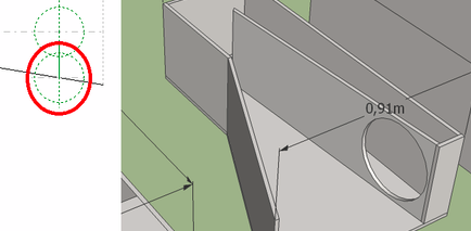

Have anybody idea what is going to happen if I set driver out of line? effect to a frequency response? There is a way to make box with in line driver, but there is more complex shapes of the box.
Your red circle would require the driver sticking half way out the side of the horn mouth, not what your cabinet drawing shows. The cabinet drawing also shows the driver being as close as possible to the mouth, while the diagram with the red circle shows it almost 1/2 driver width from the mouth, in other words L45 is longer in the simulation compared to the cabinet drawing.
Changing a circular Hornresp simulation to a rectangular shape will never result in an exact frequency response match, but I don’t think your particular box shape measured response will be much different than what the Hornresp model predicts (if you get the model cross sectional areas and driver position the same as the cabinet), other than the usual variations between predicted and measured.
Art
I would not be surprised if the effect shows up with horns as well.
I've done outdoor measurements, but alas, I only have one POC TH :).
They were just examples. There is no connection between these two pictures.
