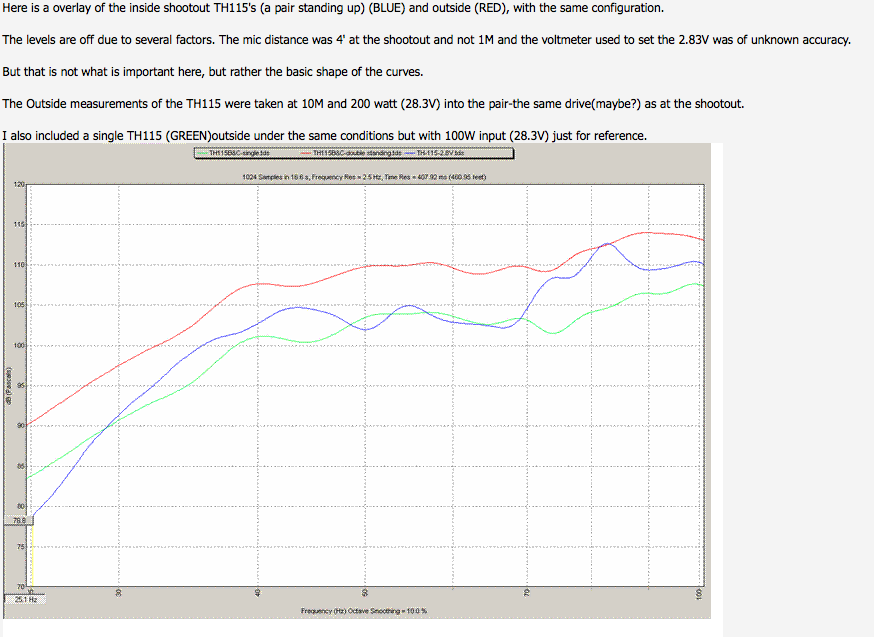

Ivan Beaver, presently working for Danley Sound Labs took the TEF measurements below right of a single and two DSL TH-115 outdoors, the results clearly show the increase of 6 dB with no LF corner change.
They also show an in room response at the NYC Pro Sound sub shootout, also using TEF, showing how that room changes the response.

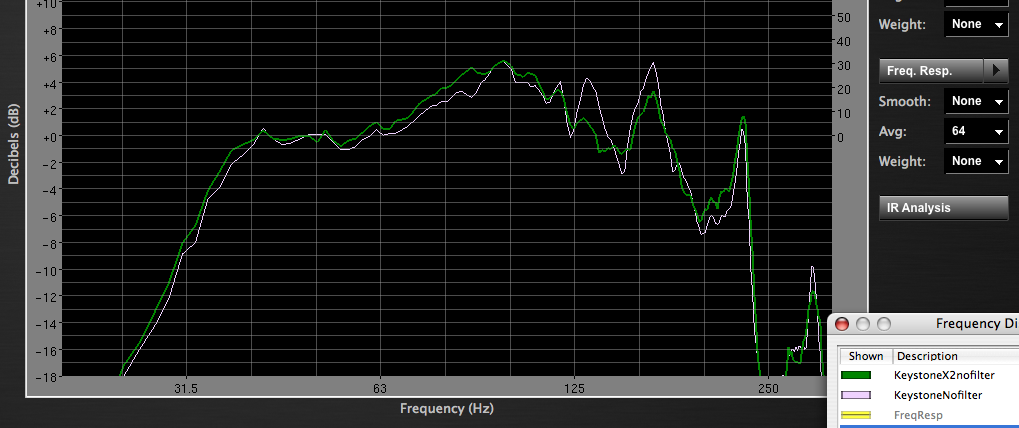

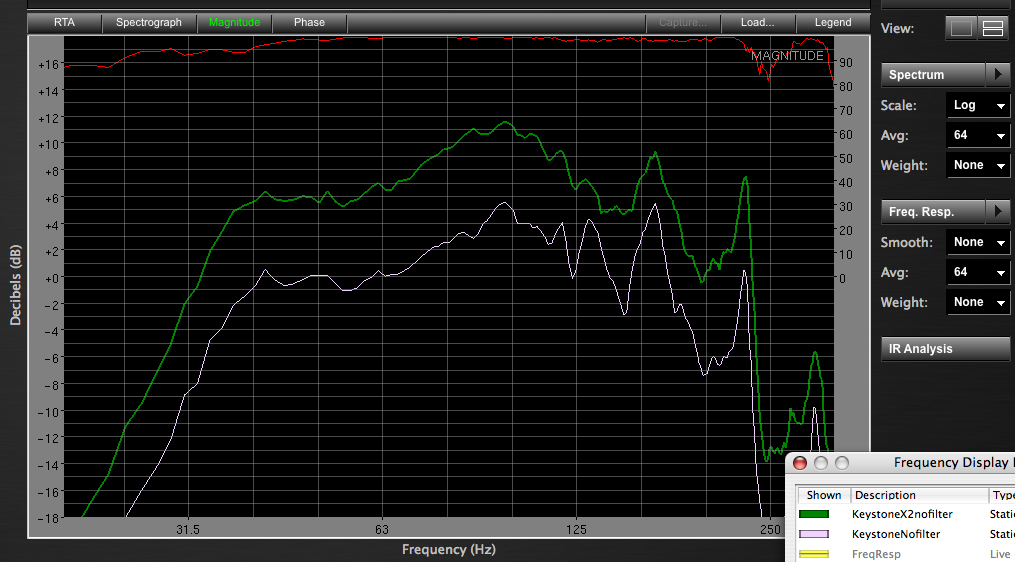

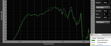

I tested my Keystone TH, slightly larger than the DSL TH-115, the results of one vs. two are posted below. The same tests with the X2 results reduced by 6 dB more clearly show the LF response overlays almost exactly, other than some slight wiggles due to wind.
My outdoor tests used a Bruel & Kjaer 4004 microphone into a M-Audio Project Mix using Smaart V6 on a MacBook Intel Core 2 Duo.

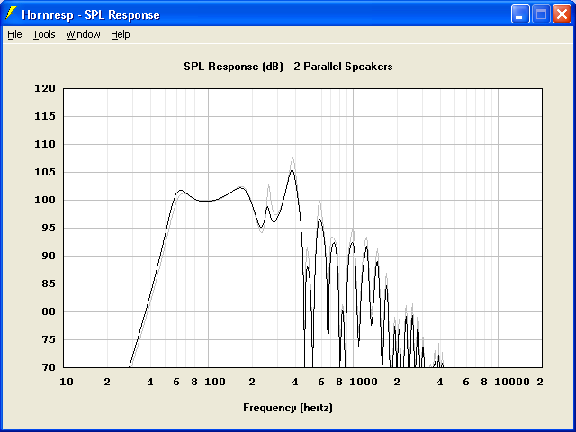

Hi Art,
The attached Hornresp screenprint compares the SPL response for a single William Cowan 60 hertz tapped horn (gray trace) against that for two similar horns connected in parallel (black trace). Eg has been adjusted accordingly to normalise the midband levels of the two traces. It seems to me that the results are really not that much different to those measured by you - the multiple speakers bass performance in each case is extended marginally.
I would be reluctant to modify the Hornresp multiple speakers model just to accommodate tapped horns :). The present model is very robust theoretically, and should be equally valid for any speaker type - it does however assume that multiple horn mouths are tightly coupled. Perhaps this is not actually the case with your test measurement setup.
Kind regards,
David

Hi Art,
Kind regards,
David
The horn mouths of my test and Ivan’s test were closely coupled, they show the LF corner has dropped perhaps 1 Hz going from one to two cabinets.
The William Cowan 60 hertz tapped horn LF corner appears to have dropped around 3 Hz going from one to two cabinets, four cabinets would perhaps drop by about 6 Hz in the model.
The model is tough to read because of the scale. I am away from the PC for a few days, so can’t do any models to verify the exact numbers.

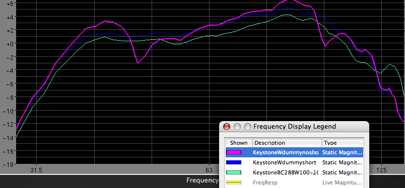

Oliver,
Looking at the overlay picture in Post #1771 again, there is actually no decrease in the LF corner frequency whatsoever using a second cabinet.
The overall forward gain has increased by the same amount, about 1 dB as it does with the second cabinet along side, undriven and shorted.
In the screen shot below, the green trace is a single cabinet output, using a 28 Hz BW24 HP and a 100 Hz LP, the same filters are used for all three traces with the same drive level.
The blue trace shows two of the same cabinets side by side, the second speaker shorted out (a wire between the + and - terminals), so the additional cabinet is just a "dummy", increasing frontal area.
The increased frontal area adds about 1 dB gain overall.
The lavender trace shows the addition of the second cabinet with the speaker not shorted. The addition of the second cabinet in this case increases the 40-45 Hz area, then causes a sharp dip, followed by more rising response, and another dip.
I found the difference the second un-powered cabinet made to the response curves rather interesting.
