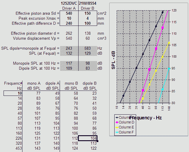

If you're referring to the Linkwitz sheet I think you are, isn't that to calculate max output based on volume displacement? That is different than calculating the frequency response. It will likely take different voltage inputs at various frequencies to reach the levels calculated in the Linkwitz sheet while hornresp is calculating the response for a constant voltage at all frequencies. You could try to compare them by calculating the response in hornresp and then running the max spl calculation.
Yes, that's because it requires more and more displacement as frequency decreases to maintain a constant SPL level. If you look at the excursion plot in Hornresp, you'll see excursion is not constant for a constant voltage input. If you are saying that the max spl calculation in hornresp does not match the linkwitz sheet, you have to make sure you're running the calculation after you calculate the combined response.

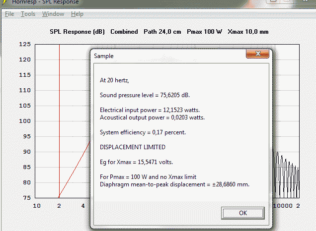

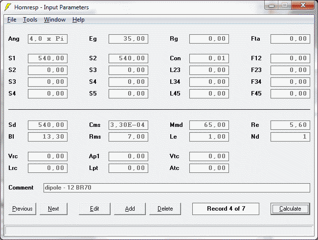

I did mean the max SPL calculation and I did do the combined response before, yes. I entered the same (dipole) distance in both calculators: 240mm in the sheet and 24cm path length difference in Hornresp.
I did some screens of both:

The hornresp number is power limited instead of xmax. It says your xmax is 28.7mm instead of the 10mm you have in the Linkwitz sheet. So it's exactly as one would expect. SPL=67+20*log10(28.7/10)=76dB. Compare that to 75.6dB - pretty close.
Edit - on second look that is not exactly what hornresp is saying.... But something is wrong, and it probably has something to do with the xmax that is assumed.
Hi John and vadi,
For the example given, Hornresp assumes that the rear of the diaphragm is the 1.24 metres from the listener and that the mouth of the 0.01 cm long cylindrical horn is 1 metre from the listener (in this case the dipole speaker is actually being modelled as a back-loaded horn system).
For the same example, the Linkwitz spreadsheet assumes that both the front and rear sides of the diaphragm are 1 metre from the listener. The 24 cm path length difference is taken into account when combining the two signals, but not when calculating the absolute SPL at the listening point.
This is why the Hornresp and Linkwitz combined response SPL results are different.
Kind regards,
David
