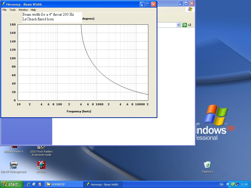

I used HornResp to simulate the beamwidth of a 200 Hz LeCleach flared horn (see attachment). One question in order to check whether I understand this right:
Let's say I wanted to build a conical tweeter horn to match the 200 Hz LeCleach horn at 1500 Hz (crossover point), then - if I understand the simulation correct - I should build a conical horn with 60 degrees dispersion for the tweeter.
Or alternatively, if I wanted to build a conical tweeter horn to match the dispersion of the 200 Hz LeCleach mid horn at 900 Hz (crossover point), then the dispersion of the conical horn should have 80 degree dispersion.
Am I correct?

Hi Peter,
You are interpreting the Hornresp Beam Width chart correctly. For the example you have given, at 1500 Hz and 30 degrees off-axis (60 degrees beam width), the SPL is down 6 dB from its value on axis. Similarly, at 900 Hz the SPL is down 6 dB from its on-axis value at an angle 40 degrees off-axis (80 degrees beam width).

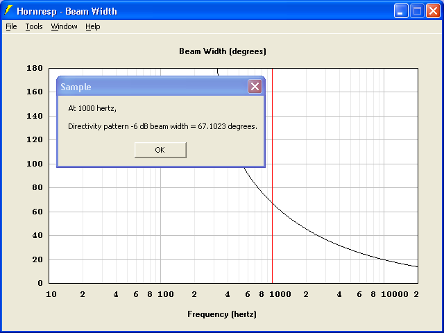

1. From the Beam Width chart you can see that the -6 dB beam width at 1000 Hz is 67.1023 degrees. For the purpose of the exercise we will assume that the beam width is actually 68 degrees, equivalent to an off-axis angle of 34 degrees.

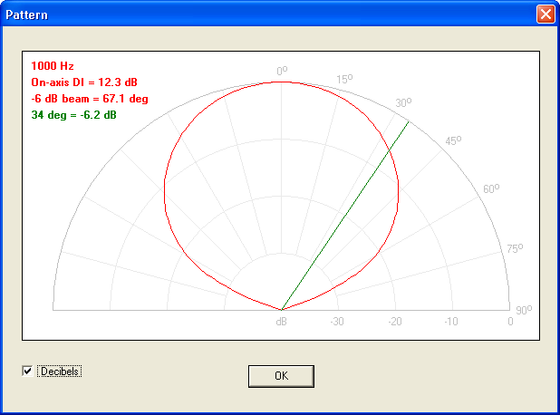

2. Now look at the 1000 Hz directivity pattern. The "-6 dB beam" is given as 67.1 degrees, which is consistent with the value obtained in 1 above. 34 degrees off-axis the SPL is down 6.2 dB from the on-axis value. This is also consistent with the earlier result - the value would be exactly -6 dB if we could sample at precisely the half-beamwidth angle, rather than at the 34 degree approximation.

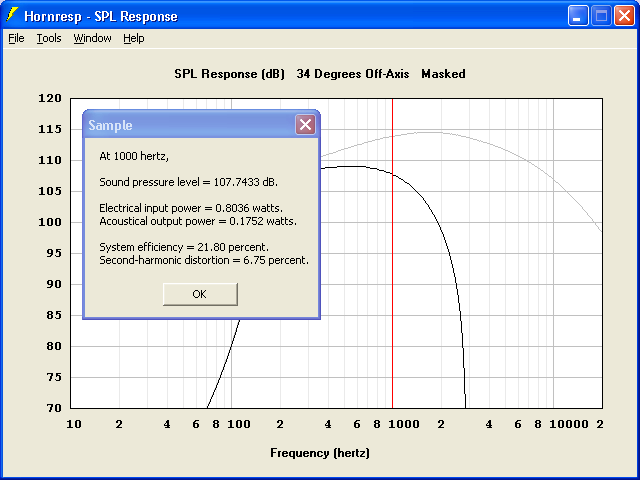

3. The attached SPL response chart compares the response 34 degrees off-axis (black trace) to the on-axis response (gray trace). At 1000 Hz the off-axis response is 6.2 dB down, consistent with the value obtained in 2 above. At 1000 Hz and 34 degrees off-axis the SPL is 107.7433 dB.

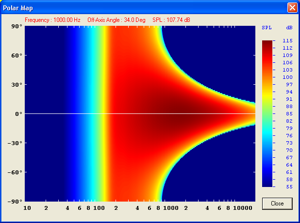

4. If you now check the polar map, you will see that at 1000 Hz and an off-axis angle of 34 degrees, the SPL is 107.74 dB, the same value (rounded to two decimal places) as given in 3 above.
Hope this helps to clarify the Hornresp directivity results.
