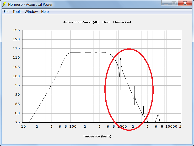

Without wishing to complicate the issue it is perhaps worth noting that Hornresp can model a chamber component taking resonances into account, or alternatively, as a pure acoustic compliance. When modelled as a compliance any resonances that the chamber would normally produce are masked.

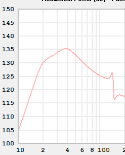

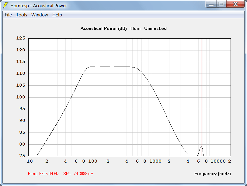

Attachment 1 shows the default record with the chambers modeled as pure compliances. Any chamber resonances are masked.
Attachment 2 shows the default record with chamber resonances taken into account. Notice the resonance spike at around 6600 Hz due to the presence of the throat chamber. (The throat chamber axial length is approximately half a wavelength at 6600 Hz).

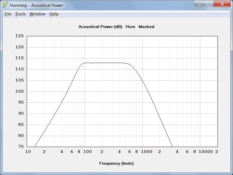

Double click on the graphs to show every 3 dB's.
Just to clarify, double-clicking on the chart itself activates the Sample tool. It is necessary to double-click in the vicinity of the chart Y-axis labels to change the dB scale.
Switching from the default 5 dB to 3 dB or 6 dB scale increments actually makes very little difference to the overall chart resolution. With 5 dB increments the chart range is 50 dB and with 3 dB or 6 dB increments it improves only slightly to 48 dB.

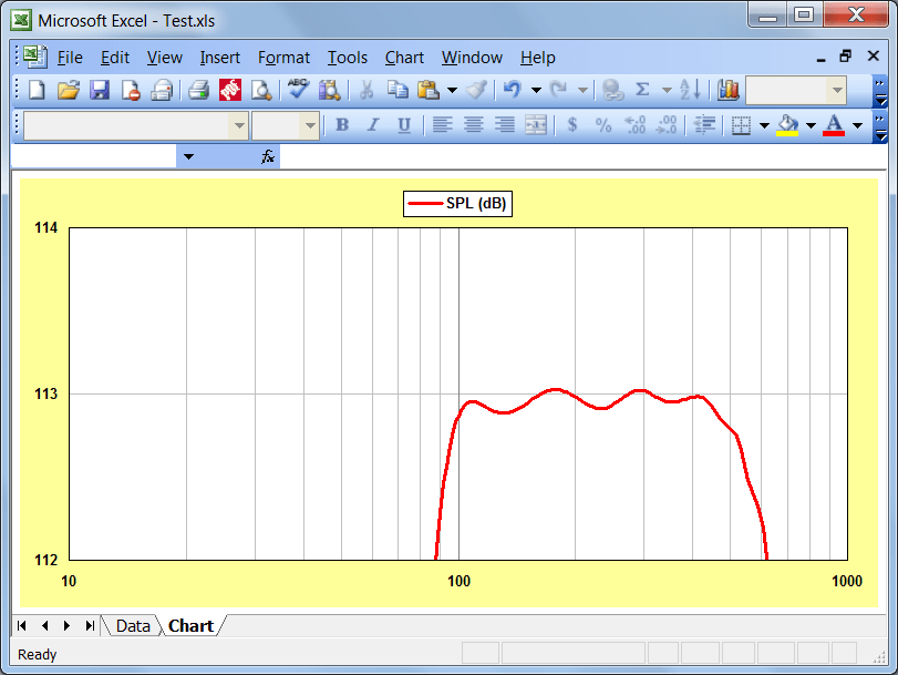

Sometimes I am trying to tickle a few db between designs and it can be rather difficult to show people that there is actually a difference between the two.

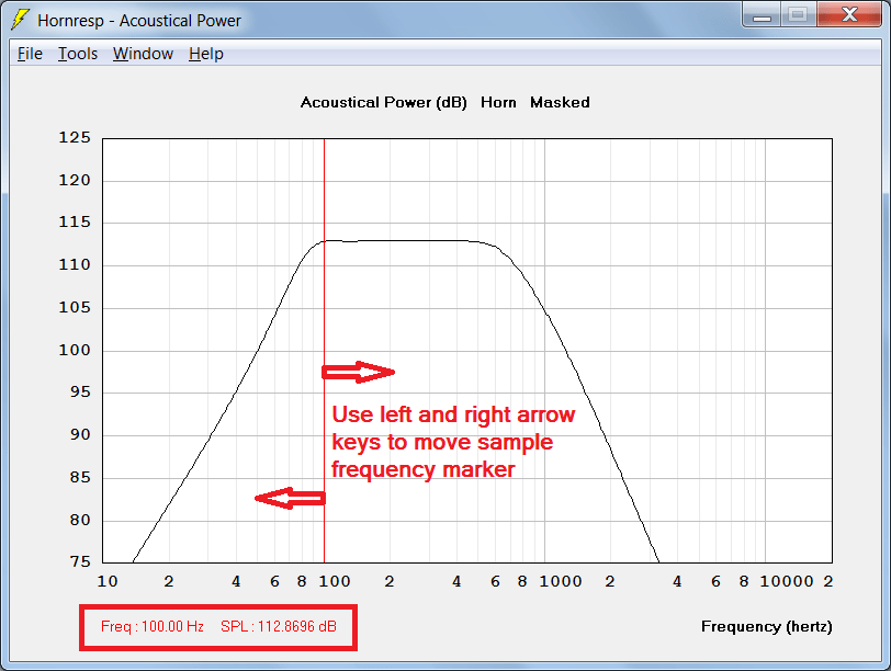

The Sample tool can be used to reveal small variations in response as the frequency changes, as shown in Attachment 1.
Alternatively, the chart data can be exported and plotted with an appropriate range in Excel or similar, as shown in Attachment 2.
Further to the above, no rear chamber resonances are shown because they are damped out by lining material specified in the default record using the Fr and Tal parameters. If the lining material is removed however the rear chamber resonances become obvious, as shown in the attachment.
Thanks David. I have never used the sample tool. Now I will be!The Sample tool can be used to reveal small variations in response as the frequency changes, as shown in Attachment 1.

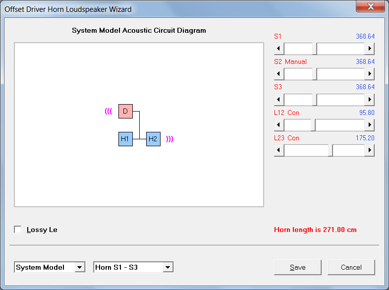

I can understand why it might seem a little confusing .

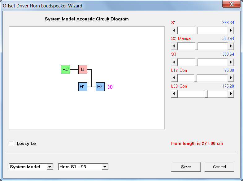

The closed-throat first horn segment can certainly be considered to be a chamber if you wish.
It is necessary however for Hornresp to use a horn segment component rather than the rear chamber component because it is simply not possible for the rear chamber to be specified in the position required in the offset design. It can only be located on the rear side of the driver.
Hopefully the attach screenprints will make things a bit clearer.
Attachment 1 shows the system model for the offset design shown in the video.
You can consider segment H1 to be a chamber if you wish.
Attachment 2 shows the system model for the offset design shown in the video but with the rear chamber component included.
Notice how there is now only one sound output from the system, not two.

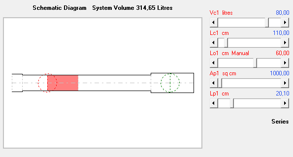

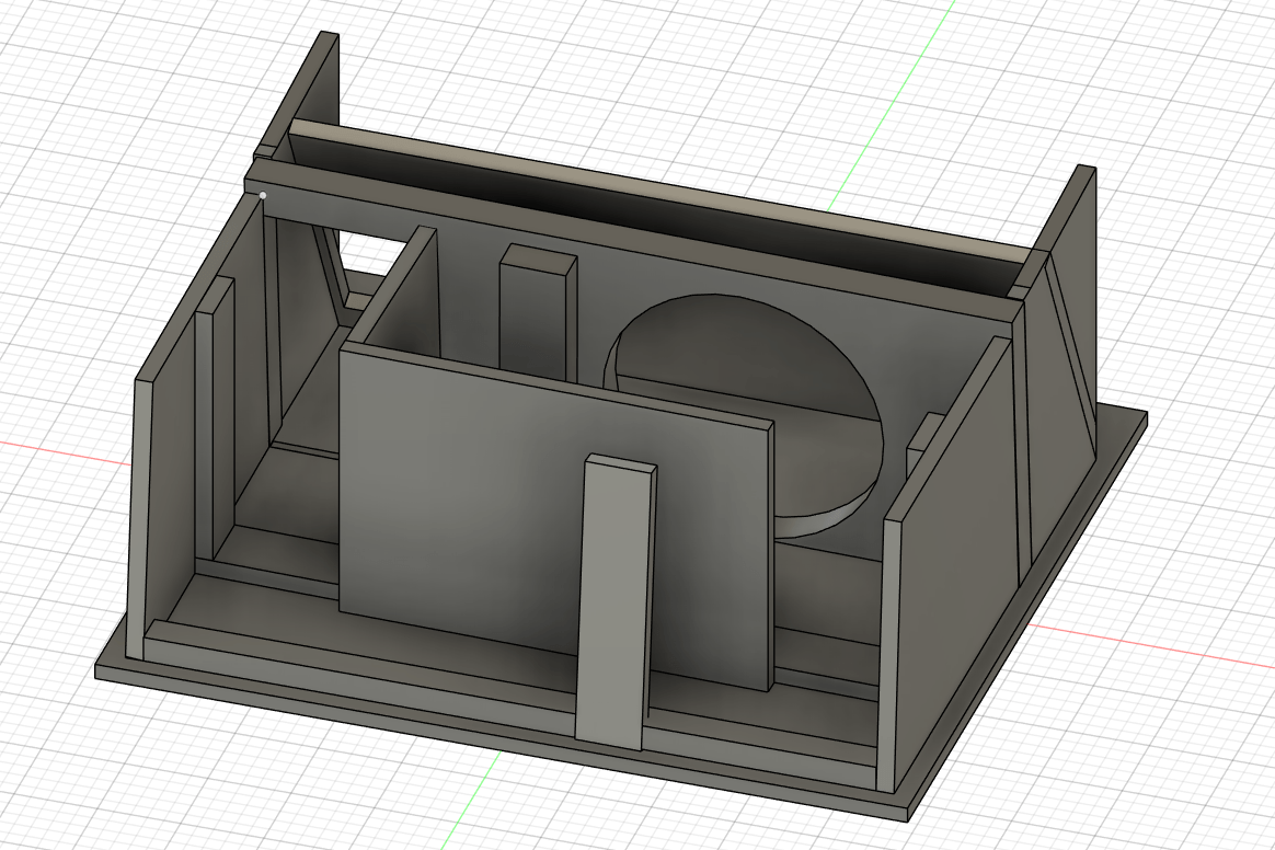

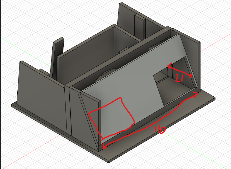

Hi, can someone help me model this more accurately?
It's a series tuned 6th order enclosure, shown without the top and rear panels and front port length.
It's in a trunk so that's why the odd shape and size constrains.

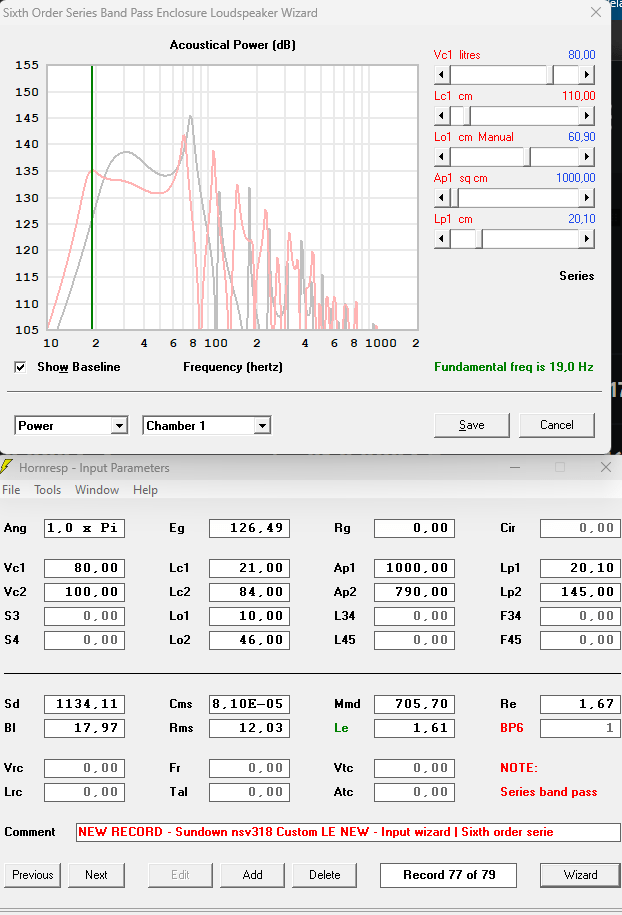

Here is how I've modeled it in Hornresp, but I'm not sure how the model would change if I move the front port to the right side instead.
As this is my initial design but I was told It'll play better with the rear port loading off the front wall instead of going straight to the front port.
But as the front chamber is so thin and wide, if I change the front port location to the other side, is that the same as changing the Lc1 (chamber length) to the width (110cm in red) instead of the front enclosure depth (21cm average in gray):
Because if this is the case, I'd have to drastically change my design because the tuning drops from 25 to 19Hz and I lose out on a lot of SPL.
And if I just try to make the rear port shorter, it will make the rear chamber bigger and the tuning won't change that much, I just lose out on port loading more.

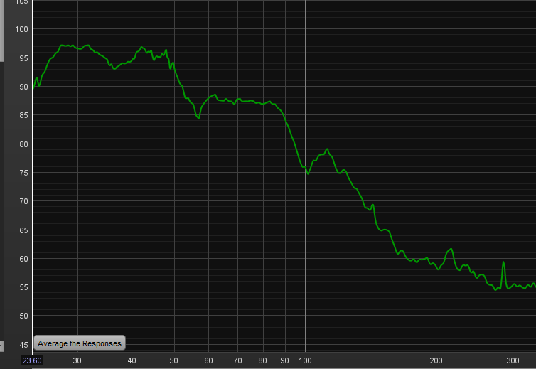

Here's a measurement of a 15" in the same external enclosure, just with 200l rear chamber and 100cm long 24cm diameter port, no front chamber:
So I know relatively well how it changes because the front chamber port will be around the same place as the port mouth was in this picture.

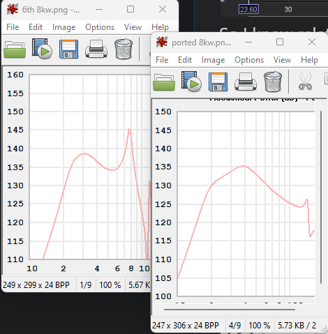

It's very hard to simulate cabin gain in Hornresp AFAIK, so I just look at the relative responses between enclosures.
E.g. here's the simulation of the 6th order with the 18" and the measured ported enclosure with the 18":
So I just see that I will get a lot more output in the 20-90Hz range with the 6th order, and that is the point of this build, SPL and bandwidth.

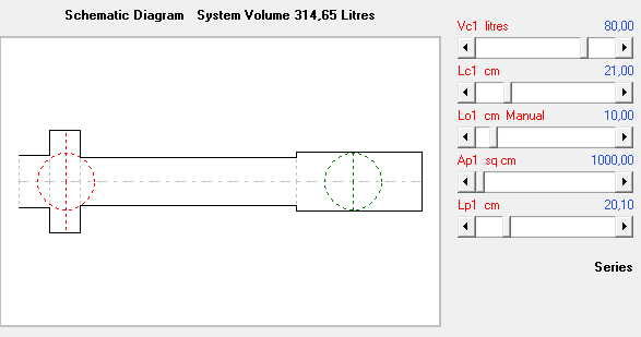

I would not have the rear port firing into the front port with this design. It's kinda defeating the BP6S principle. I'd move the front port to the red square or flop the rear chamber. The driver should fire into the front port. See the example pic.
The length of your front port is the thickness of the wood. I use 1.905cm for 0.75in wood.
For a "musical" BP trunk install, I would have a rising response to the low pass filter frequency at 2pi. The response should be flat at 0.5pi. You will loose midbass response with a flat 2pi BP enclosure. See the Devastator responses on avsforum.com. Those 2pi BP6P designs are PERFECT for car audio.
