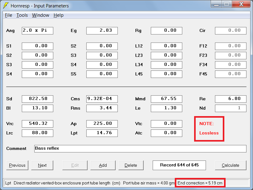

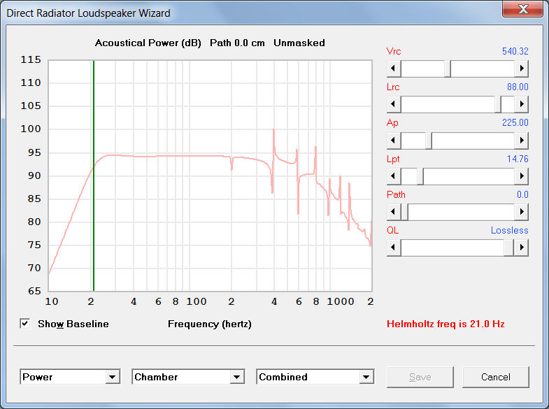

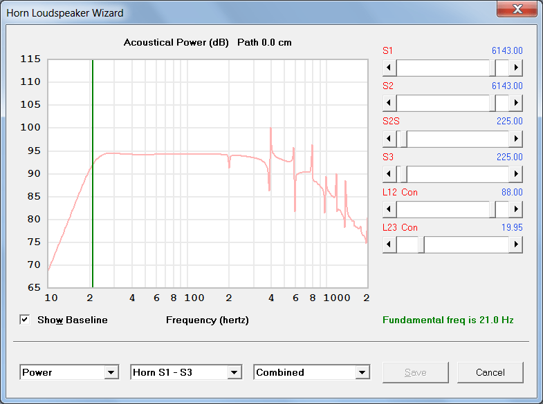

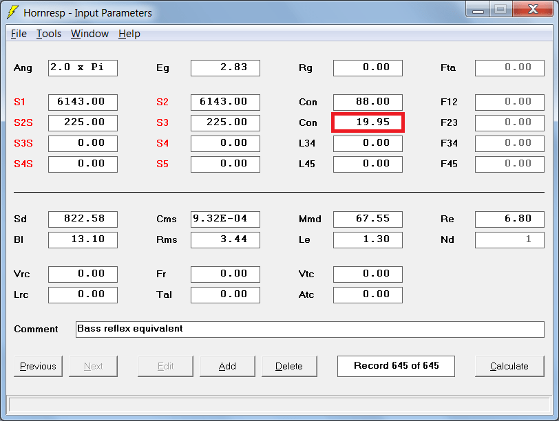

So does Hornresp simulate the effects of stuffing in a reflex enclosure?
Absorbent filling material can be added if the bass reflex loudspeaker is specified using two stepped segments, with the length of segment 2 increased to include the internal end correction.
Attachment 1 shows the input parameter values for a standard bass reflex loudspeaker design. The length of the port tube internal end correction is 5.19 cm.
Attachment 2 shows the response of the bass reflex loudspeaker with resonances not masked and QL set to lossless.
Attachment 3 shows the bass reflex equivalent design specified using two stepped segments with port tube length L23 = Lpt + EC = 14.76 + 5.19 = 19.95 cm
Attachment 4 shows the response of the two-segment equivalent design. It is identical to that of the bass-reflex system. Absorbent filling material can be added to the segment 1 chamber and/or segment 2 port tube as required.

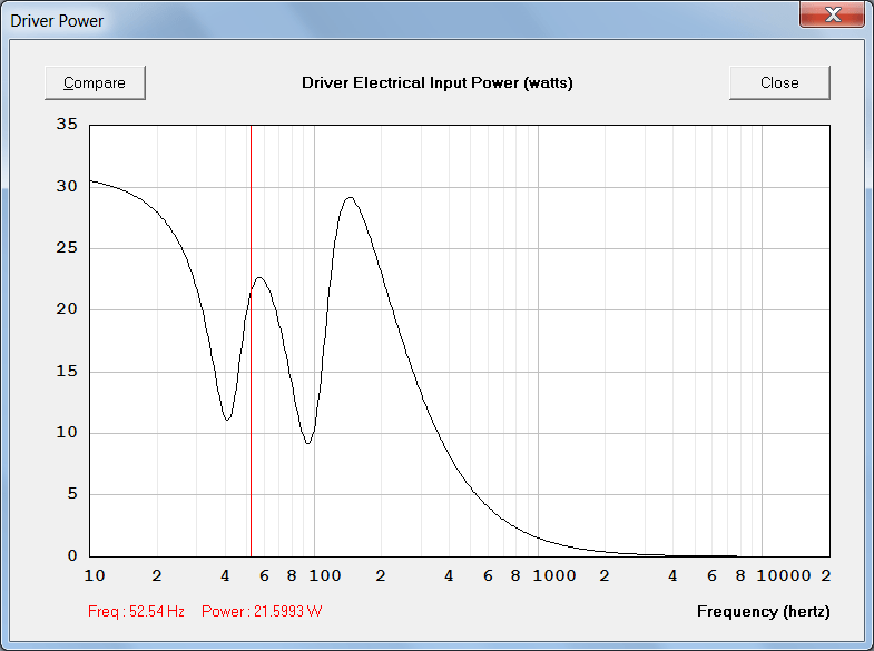

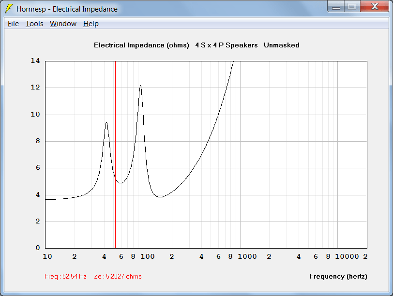

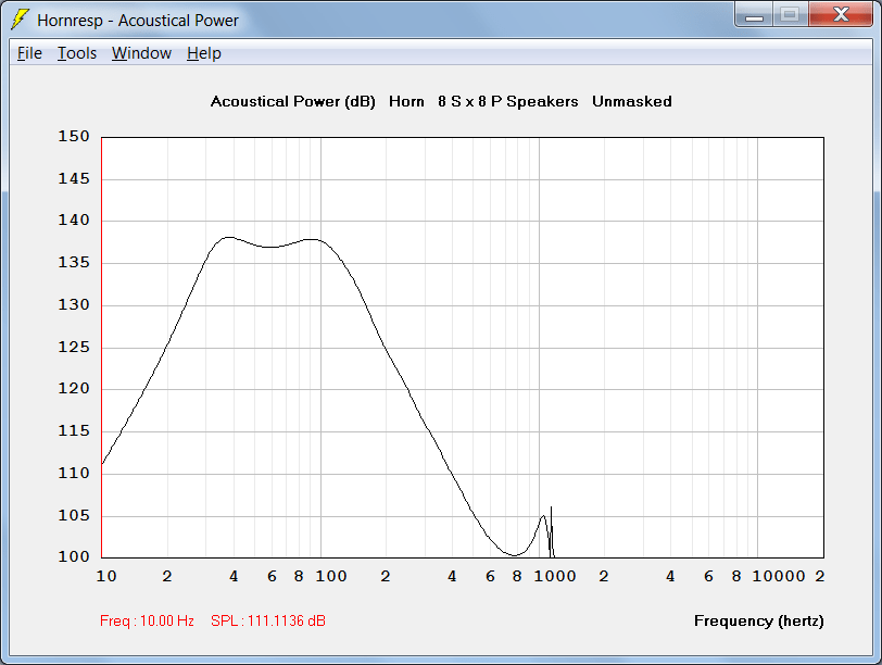

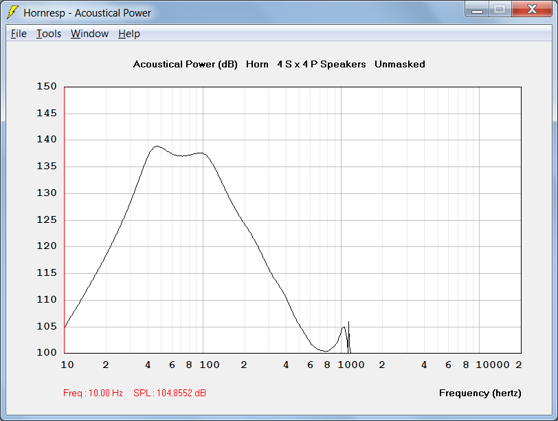

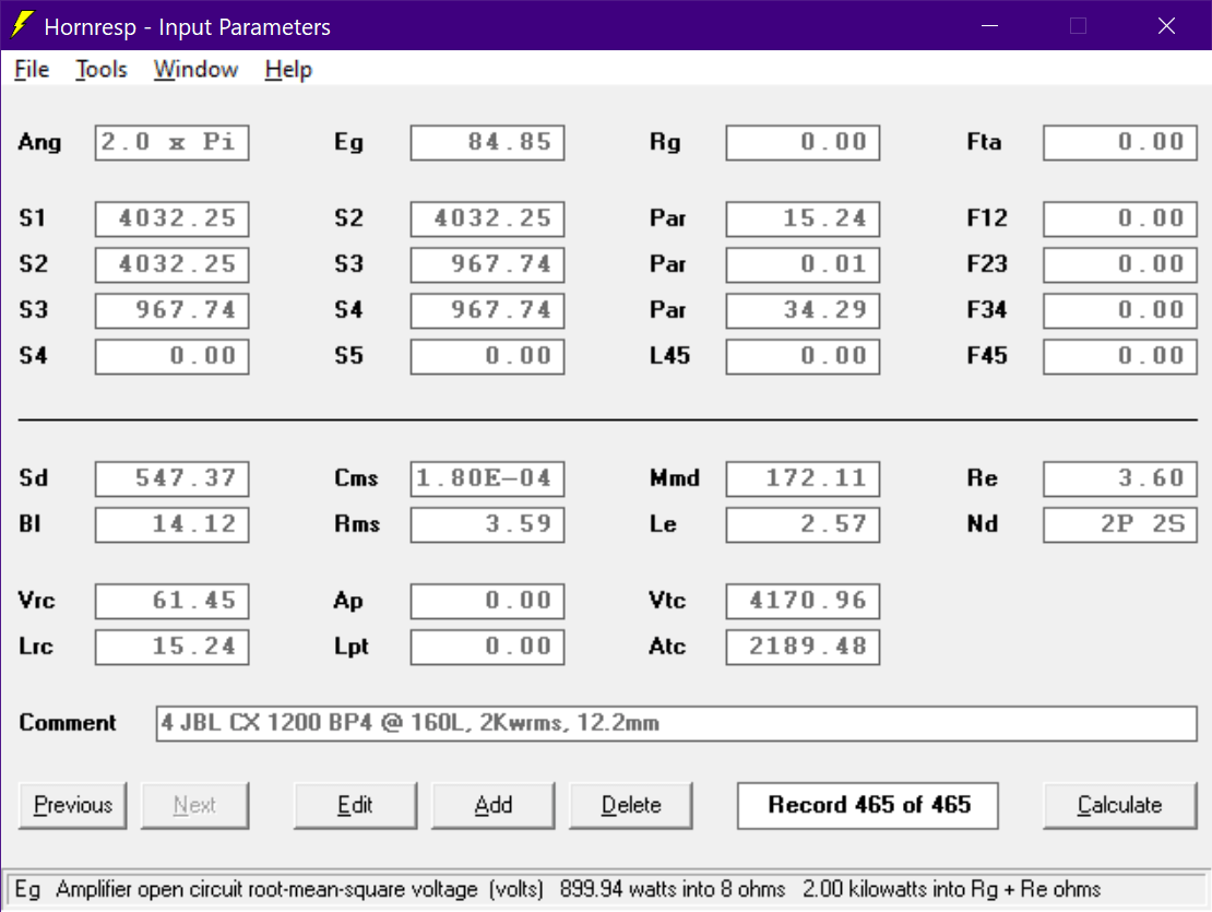

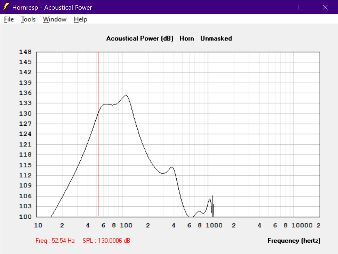

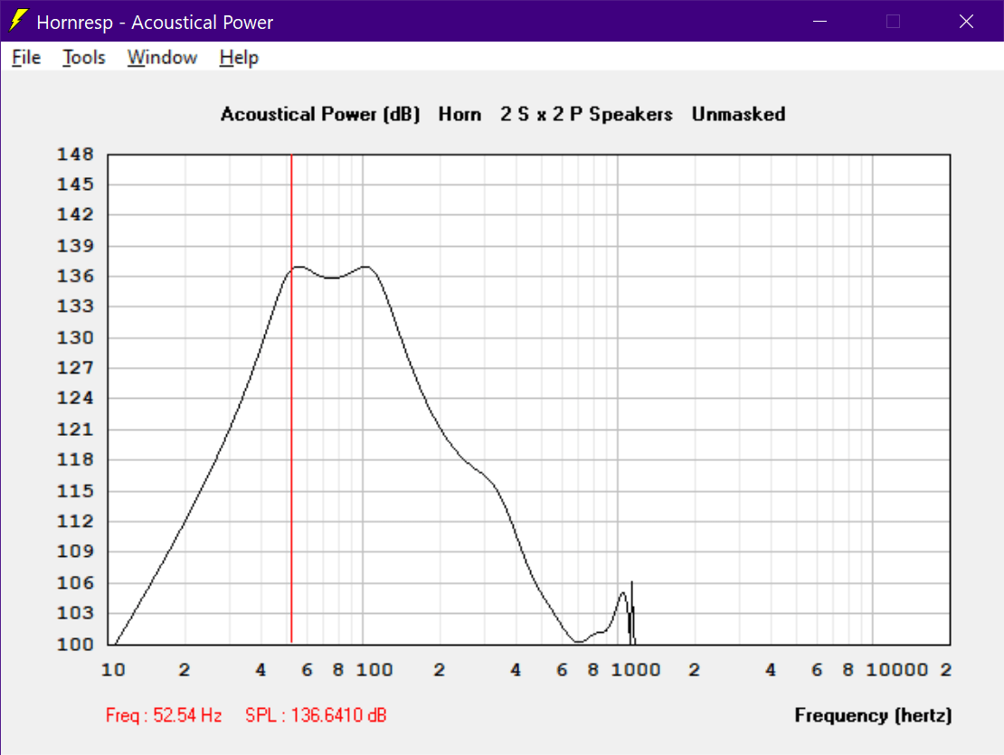

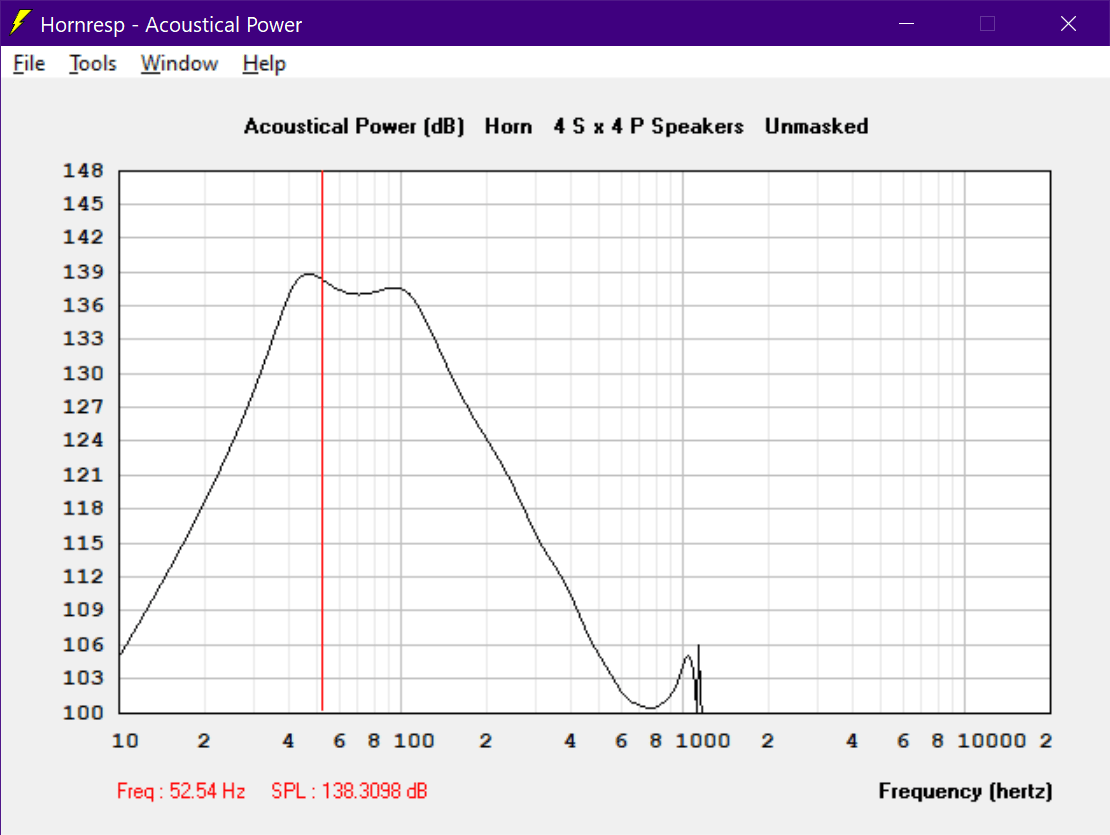

Why is the dB not going up at 52.54hz from 4S x 4P to 8S x 8P with the same 2K watts?
Your question is in essence similar to the one asked by camplo in Post #14,056, and as for that post, it would require a lot of work to identify the specific reason why the results you have observed are what they are.
I am confident however, that the multiple speaker model calculations are correct, and the simple sanity check below confirms this.
For a fixed speaker input voltage, doubling the number of speakers increases the bass output by 6 dB. (3 dB due to having twice as many speakers plus 3 dB due to having improved acoustical loading conditions)
Doubling the number of speakers a second time improves the bass by another 6 dB, meaning that going from 4S x 4P (16 speakers) to 8S x 8P (64 speakers) with no change in speaker input voltage, increases the bass output by a total of 12 dB.
Hornresp assumes however that a single signal source feeds the speaker array, so that for a constant Eg, the voltage across each speaker in the 8S x 8P array will be half that of each speaker in the 4S x 4P array. This means that instead of the difference between the 4S x 4P and 8S x 8P arrays being 12 dB in total, it is reduced by 6 dB, making a final difference of 6 dB.
For your 4S x 4P array the output at 10 Hz is 105 dB (see attachment 1) and for the 8S x 8P array it is 111 dB (see attachment 2), a 6 dB difference, as predicted above.

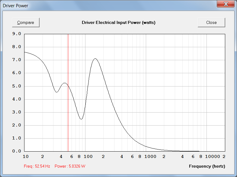

As far as input powers to the two arrays are concerned, they are not "the same 2K watts". The input power would only be 2 kW if the load was a purely resistive constant 3.6 ohms (Re). See attachments 3 and 4 for the actual load magnitudes.
The total input power to the 4S x 4P speaker array is 21.5993 watts x 4 drivers x 16 speakers = 1.38 kW at 52.54 Hz. See attachment 5.
The total input power to the 8S x 8P speaker array is 5.0326 watts x 4 drivers x 64 speakers = 1.29 kW at 52.54 Hz. See attachment 6.

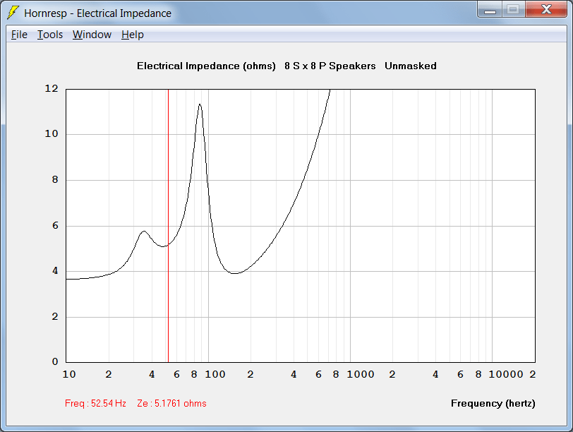

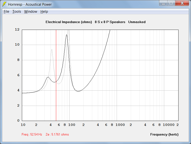

Basically, the ohm load is not the same with 8S x 8P compared to 4S × 4P at 52.54hz.
The speaker array electrical input impedances are certainly different overall, but are quite close at 52.54 Hz, as shown in the attached comparison. The grey trace applies to the 4S x 4P array and the black trace applies to the 8S x 8P array.
The results at 52.54 Hz shown below have been manually calculated to further confirm that the Hornresp multiple driver and multiple speaker simulation models are working correctly.
4S x 4P Speaker Array:
Frequency = 52.54 Hz
Array Electrical Input Impedance = 5.2027 ohms
Driver Electrical Input Power = 21.5993 W
Power Conversion Efficiency = 29.7200 %
Driver Acoustical Output Power = 6.4193 W
Speaker Acoustical Output Power = 25.6772 W
Array Acoustical Output Power = 410.8360 W
Half Space Radiation Surface Area = 6.2832 m^2
Output Pressure = 164.6331 Pa
SPL = 138.3098 dB
8S x 8P Speaker Array:
Array Electrical Input Impedance = 5.1761 ohms
Driver Electrical Input Power = 5.0326 W
Power Conversion Efficiency = 23.9202 %
Driver Acoustical Output Power = 1.2038 W
Speaker Acoustical Output Power = 4.8152 W
Array Acoustical Output Power = 308.1748 W
Output Pressure = 142.5875 Pa
SPL = 137.0610 dB

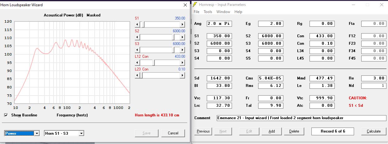

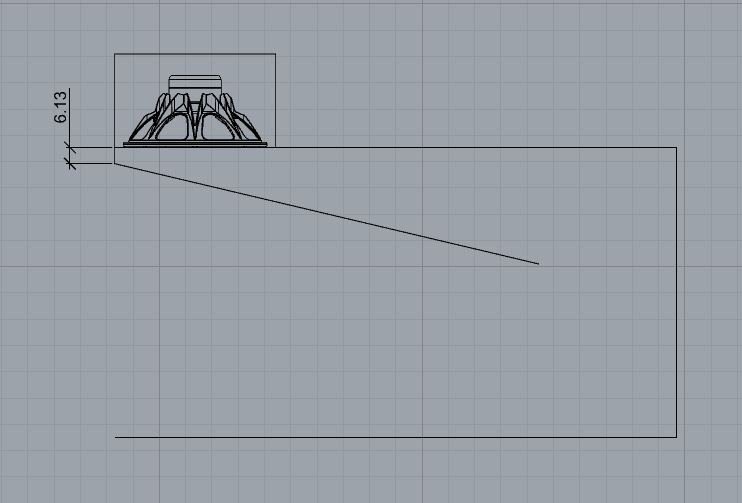

hi gang,
this is a sub bass sub, made to hug a wall. it is very simply but large, therefore it reaches low ( 25hz ) and is pretty loud. come to think of it I should have used 1/4 space instead of 1/2 space sim.. whoops. easy fix
since the start of the horn ( CSA ) is 6.12cm x 57.15cm = 349.758^2cm = S1, the entry to the horn looks more like a slot to the 21" drive unit. the little throat I am talking about becomes more apparent in the attached drawing. the driver is side loaded ( or maybe in this case top loaded? ) into the horn throat as early as possible. is the simulator asking me to make the horn throat as skinny as the bottom of the horn? in other words should I be letterboxing the driver entry to 6.12cm where the diaphragm injects into the top?
anyone more advanced than me, feel free to judge and give input on potential improvements
thanks :alien:

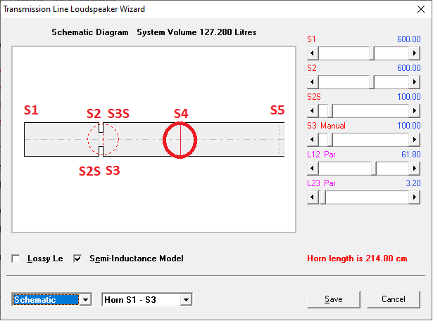

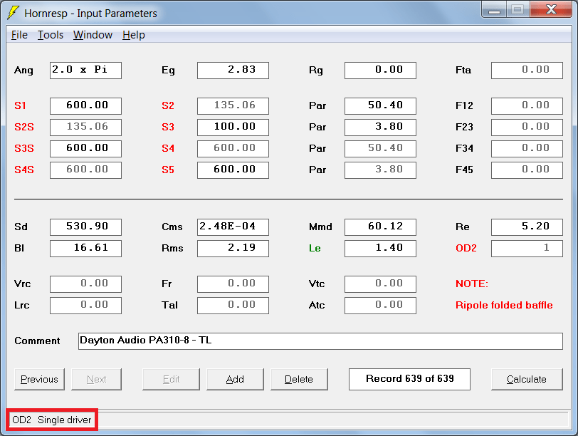

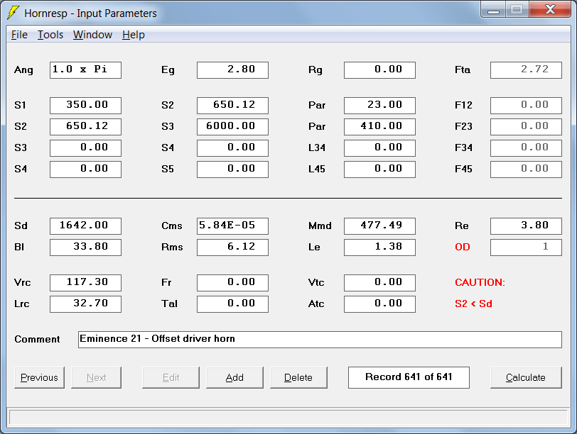

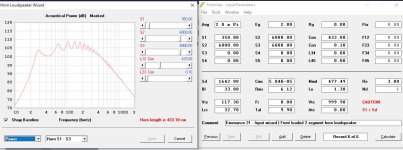

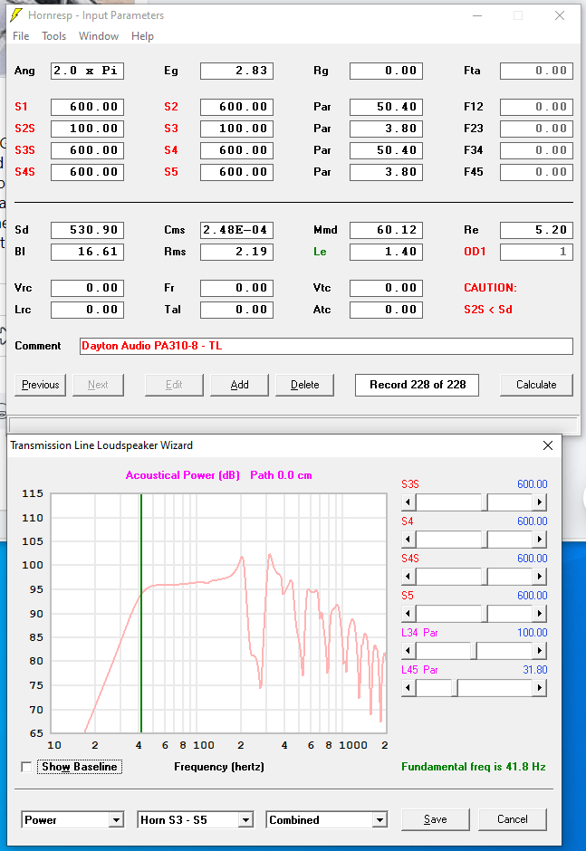

I'm trying to sim the effect of adding a restriction in a TL that's located between the closed section of the line and the driver. I thought using the "OD2" option in Hornresp, but it keeps jumping to some sort of Ripole thing when I do that. Is there something I'm doing wrong?
Hi Brian,
You are not doing anything wrong, the OD2 offset driver option does indeed specify a Ripole folded open baffle type loudspeaker. The best that you can do is to use the OD1 option to position the driver at S3, as you have already done.
What I don't understand is why in your OD2 Input Parameters window screenprint 'OD1 Single driver' is displayed in the status bar panel at the bottom of the window when it should show 'OD2 Single driver'. Also, I don't know why a run-time error should be generated after switching from OD1 to OD2. I experience no such problems. I assume you are using the latest release of Hornresp?
Kind regards,
David
Reactions: 1 user
Hi Brian,
Kind regards,
David
Hi David, I'm not sure why the program crashed at that point. Seemed to work perfectly fine afterwards.
This is what I'm trying to accomplish. Using the "OD1" option unfortunately would put the driver at S3 not S4. What I'm trying to figure out is if placing a restriction in the line before the driver could be used to filter out a particular resonance frequency. I thought "OD2" puts the driver at S4, but that doesn't seem to be the case.
Reactions: 1 users
