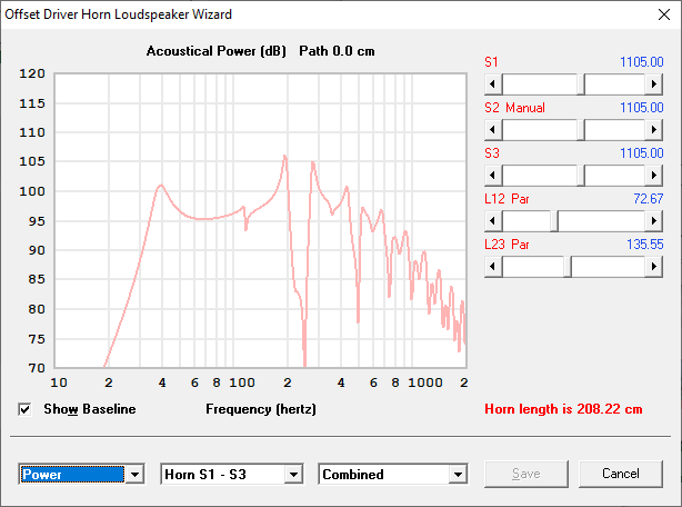

If you do that, I think you'll find that the "optimum" box volume and tuning ( i.e. to provide a maximally-flat alignment with the smallest box volume and lowest F3 for a driver given its t/s parameters and a Ql of 7) is given by equations that I provided earlier, e.g. Vb=20*Qts*3.3*Vas. The origins of those equations are stored in my e-mail archives somewhere, but they're basically curve-fits based on the LDC tables, using the most optimum alignment predicted by them.[snip]

The equations you provided earlier seem to work fine for non-tapered systems, which is why I included them in Hornresp . However when I substitute them for the Vance Dickason table in Method MK 2021 and specify a taper, the performance suffers. The volume of the system given by the Vb equation appears to be too small for good results in this case.If you do that, I think you'll find that the "optimum" box volume and tuning ( i.e. to provide a maximally-flat alignment with the smallest box volume and lowest F3 for a driver given its t/s parameters and a Ql of 7) is given by equations that I provided earlier, e.g. Vb=20*Qts*3.3*Vas.
Hmm, ok something seems a bit off, because it's my understanding that the volume of the "ideal" volume for a TL for a given driver shouldn't change much, if at all. It's basically the length of the TL, and its taper rate (adjusted to keep the box volume the same size as that of a "straight" TL) that sets Fb.

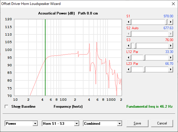

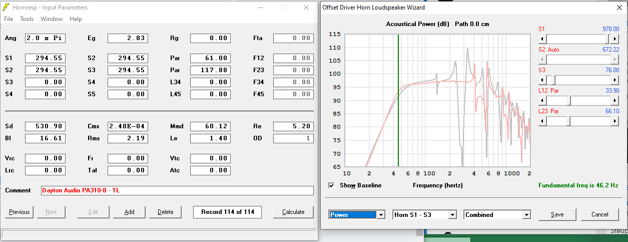

In other words, the design process could be like this (probably needs to be checked!):
1. Start with the optimum size and length for the straight TL (let's call this Vb and Fb) using the equations I provided, then
2. Choose the usable bandwidth, BW of the TL (defined by ratio BW=Fh/(6*Fb where BW >=6*Fb) . In other words BW is always 1 or greater.
3. Calculate the required L of the TL from L=6*c*100/(4*BW*Fb)
4. Determine the starting CSA using S1=S2=S3=Vb/L
5. Now, setting S2 calculation to automatic, increase S1 and decrease S3 by the same amounts until the required Fb is achieved. This can be done by a goal-seek routine in Hornresp.
The end result should be a tapered TL with an Fb and low frequency cutoff very similar to a straight TL of the same volume. In fact, a quick Hornresp sim suggests that the response might actually improve (likely an end-correction issue - I really haven't looked into it.)
Here's an example - a Hornresp sim starting with a straight TL (grey response curve) and then adjusted like I outlined above (red response curve). The net volume, Vb, has not changed, but the passband response is improved with the use of a taper.

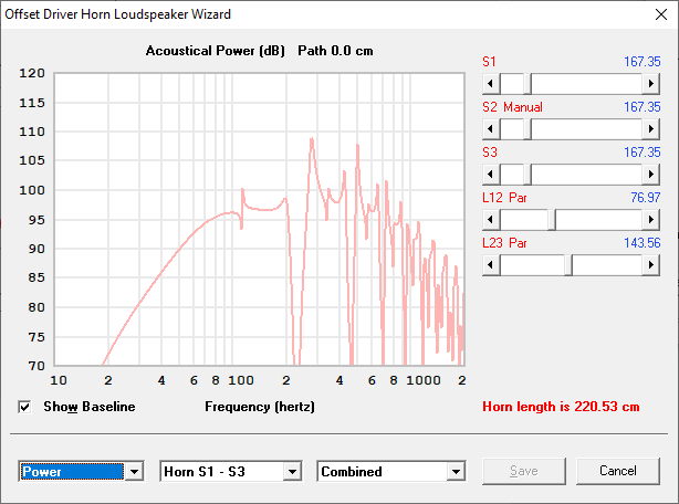

On another note, I tried using my sample driver in a few of the suggested TL designs...
Here's the MK2006 result. At 230 litres, that box is way too big for this driver, and it shows in the response curve.
Here's the MK2021 result. Now the box is way too small...!
Here's the result using my method for a straight TL...
...and here's a tapered TL of the same volume Vb and resonant frequency, Fb, BW set to around 1.79

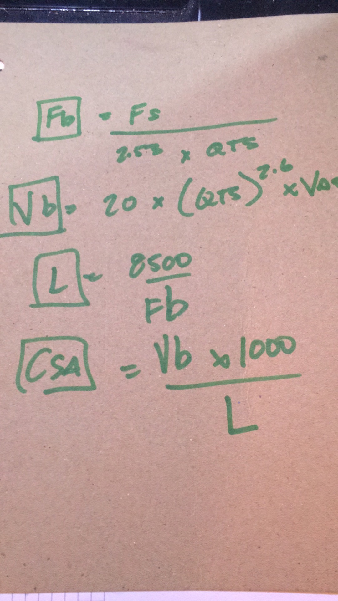

Just to clarify - is the volume equation Vb = 20 * (Qts * 3.3) * Vas, or Vb = 20 * (Qts ^ 3.3) * Vas?given by equations that I provided earlier, e.g. Vb=20*Qts*3.3*Vas.

Sigh, it's 20*(Qts^3.3)* Vas
At least, that's the curve-fit one for the optimum vented enclosure Vb for a particular driver (based on its t/s parameters).
I've also tried 20*(Qts^3)* Vas, which gives a larger box and lower tuning and seems to work for a number of drivers as well.
