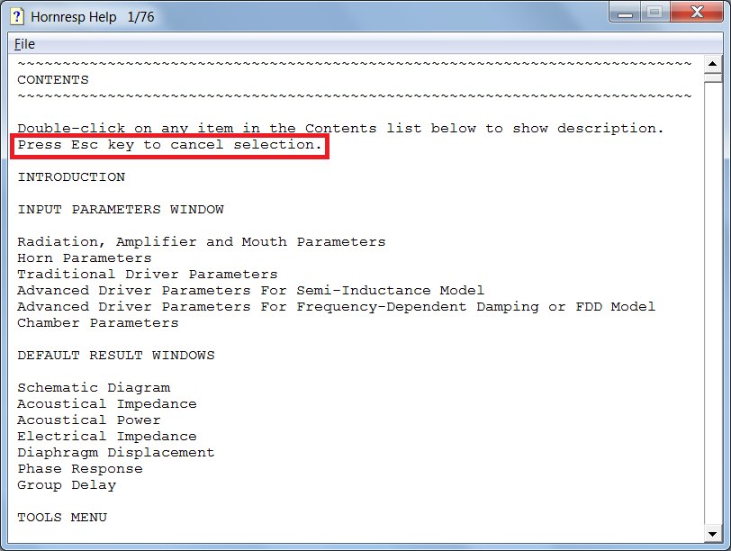

Haven't used the HELP file in awhile, but seems to me I could highlight/double click to reach my destination multiple times without needing to close/reopen each time in this latest update. A 'bug' or my HP Win7pro laptop and/or my faulty memory or download? Seems to work fine otherwise.

Hi GM,
The Help file functionality has not been changed. Double-click on any item in the Contents list to immediately jump to that section of the Help file. To choose a different item from the Contents list, first press the Esc key to cancel the previous selection.
Use the File > Find tool to search the Help file for multiple instances of a given text string.

Right, thanks! But it wasn't working, i.e. for whatever reason, 'Esc' didn't make any difference, so rebooted, reloaded HR and now it does for whatever reason. No clue, but a buddy commented that my laziness re regularly rebooting [may go months], especially when doing installs might be the culprit.
