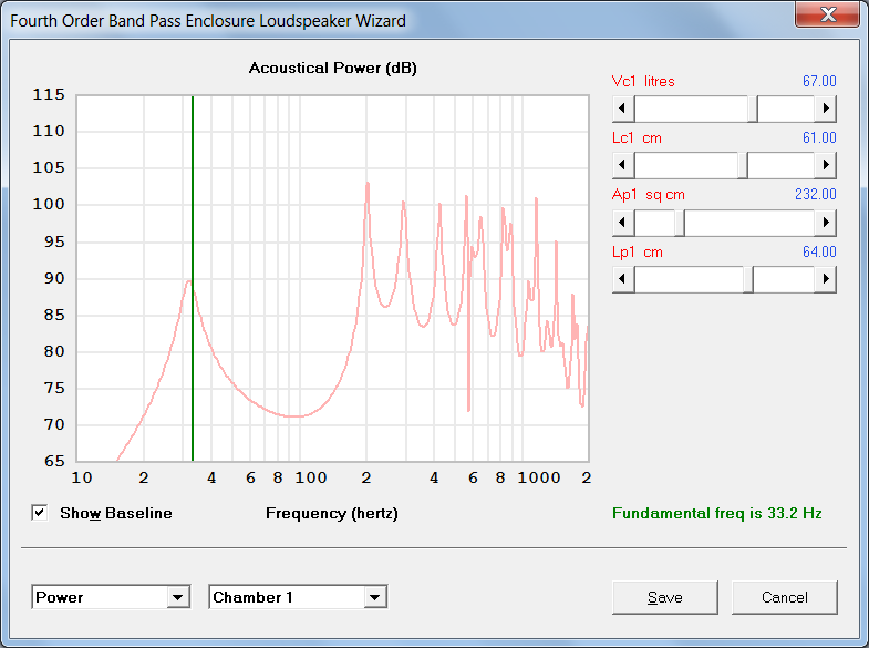

Almost .

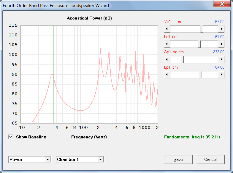

As far as Hornresp is concerned, the only difference is that the BP4 includes an end correction at the port inlet, whereas the FLH does not have end correction at the horn throat. This is why there will be a tuning difference in the results when comparing a BP4 against an equivalent FLH, as shown in the attachments.

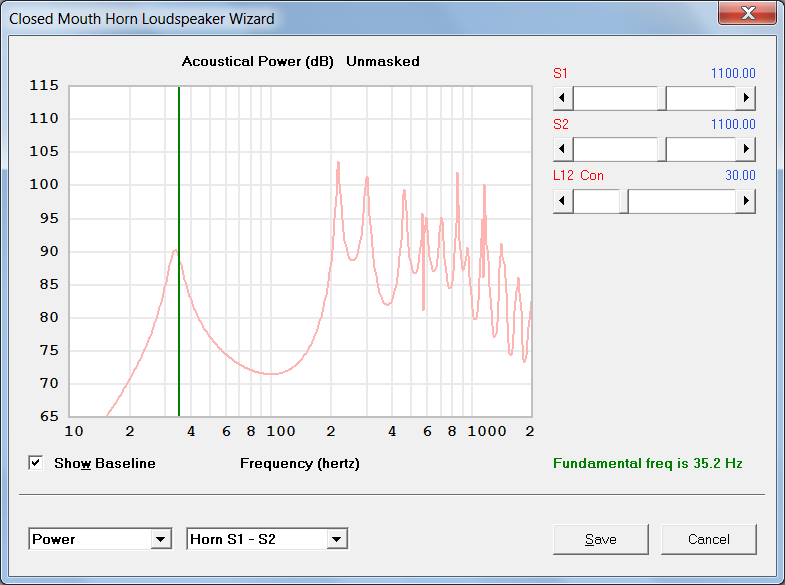

Less than 10% error in tuning frequency!

I felt that it was more important to highlight the difference between the simulation models - one includes an end correction (BP4), whereas the other does not (FLH). If the end correction is set to zero, the results become identical.
I leave it to you to compare a positive flare port FLH against a straight flare port BP4, if you feel that it would be a worthwhile exercise to undertake .

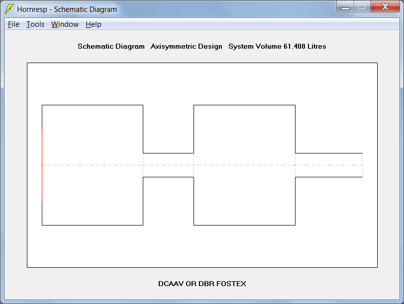

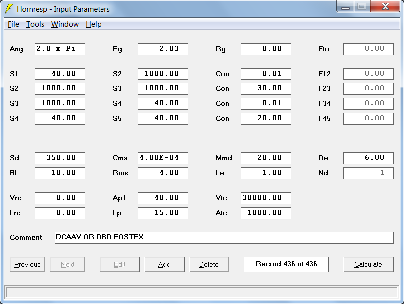

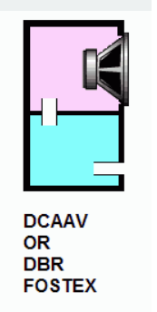

Hi Dan,

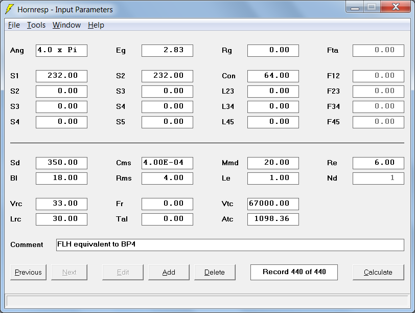

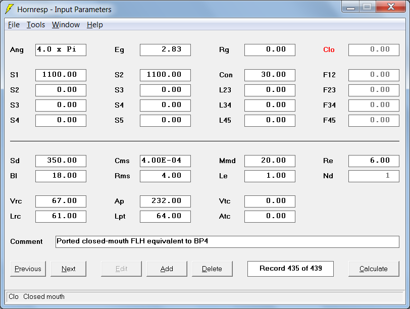

Just to complete the picture, the "DCAAV OR DBR FOSTEX" system shown in Attachment 1 could be simulated without end corrections, as shown in Attachments 2 and 3.

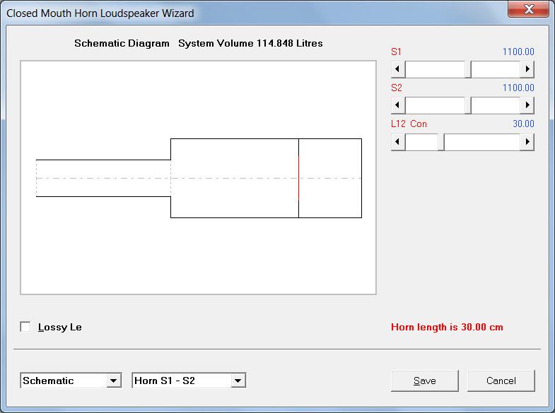

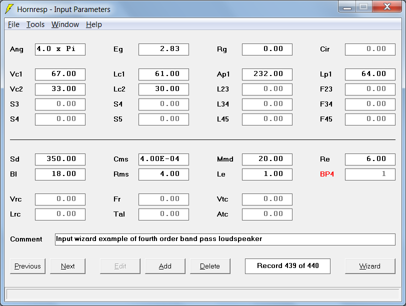

The internal end correction value for the port tube in a BP4 system was not being calculated correctly. This has now been fixed, and as a consequence the fundamental tuning frequency of the BP4 test example given in Post #8567 increases from 33.2 Hz to 35.2 Hz (see Attachment 1), which is closer to the fundamental frequency of 36.2 Hz previously calculated for the equivalent FLH system used in the comparison.
As a further sanity check, the above BP4 test example has now been compared against an equivalent closed-mouth FLH having a vented rear chamber (the port tube specified using Ap and Lpt has an internal end correction applied automatically). As should be the case, the results for the two systems are identical - see Attachments 1 to 4.
