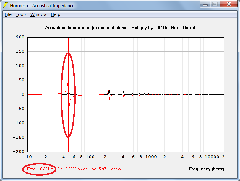

i'd like to calculate the fundamental frequency of an empty(no dampening) negative expanding parabolic horn by an equotiation.
Eg:
S1=1000cm^2
S2=100cm^2
L12=100cm
Fb=?
Any advice is welcome, thanks in advance!
rertrobaer
Hi rertrobaer,
As indicated in my earlier email reply, I very much doubt that there is a simple equation that will give you what you want.
The throat (S1) acoustical impedance for your given example is shown in the attachment, assuming 2 Pi radiation conditions at the mouth (S2). The fundamental resonance for your example would therefore appear to be about 48 hertz.
Thanks, interresting. In "Louspeaker Wizard", 46,9Hz are shown in the "acoustical power" window. Is this because it is a pre-calculation?

Hi Rertrobaer,
I used Ang = 2.0 x Pi in my example. It would appear that you are using Ang = 1.0 x Pi.

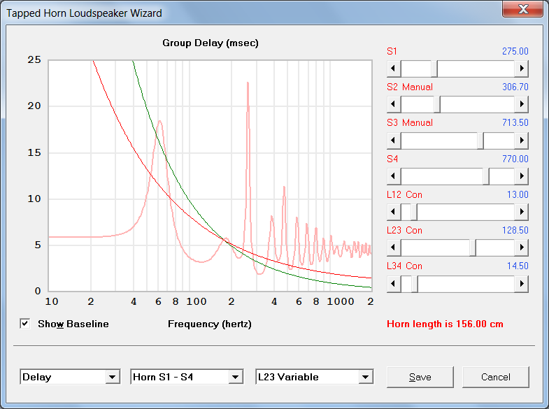

Hornresp Update 4520-180612
Hi Everyone,
CHANGE
1/f and Claus Futtrup guideline limits can now be added to the loudspeaker and filter wizard group delay charts.
Double-click anywhere on the group delay chart Y-axis vertical scale to add a green 1/f limit line. Double-click again to add a red Claus Futtrup limit guideline. Double-click a third time to remove the 1/f limit line and double-click a fourth time to remove the Claus Futtrup limit guideline.
The Claus Futtrup audible group delay threshold limit guideline in milliseconds is given by the expression:
GDlimit = 1000 * 1.1606 / (5.6413 * f ^ 0.81511 - f)
Where f is the frequency in hertz.
Kind regards,
David

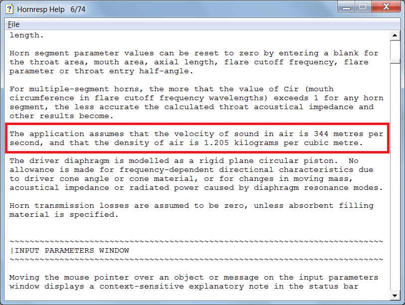

Hi Retrorbaer,
Hornresp assumes that the velocity of sound in air is 344 metres per second, and that the density of air is 1.205 kilograms per cubic metre. It's all in the Help file :).
An end correction is not applicable because Hornresp takes into account the actual acoustical impedance loading the horn mouth. (The purpose of an end correction is simply to approximate the effect of a terminating impedance).
Kind regards,
David
