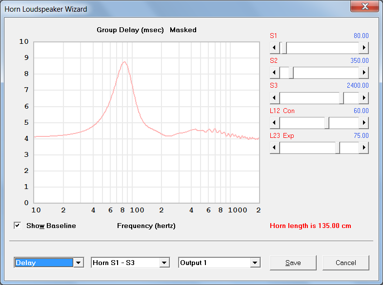

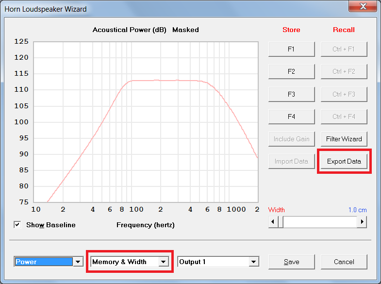

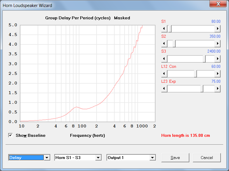

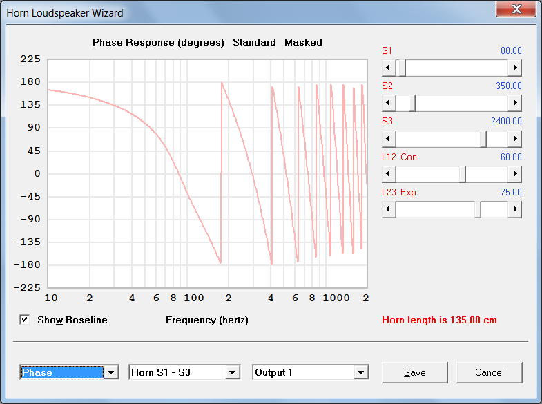

Hornresp Update 4250-180222
Hi Everyone,
CHANGE 1
Phase Response, Group Delay and Group Delay Per Period charts have been added to the Loudspeaker Wizard, and to the Filter Wizard when selected from the Loudspeaker Wizard. Attachments 1 to 3 refer.
CHANGE 2
1. With the Loudspeaker Wizard Power output option selected, SPL magnitude and phase values can be exported to a .txt or .frd file by either clicking the Export Data button in the Memory & Width window or by pressing the F9 function key.
2. With the Loudspeaker Wizard Impedance output option selected, electrical impedance magnitude and phase values can be exported to a .txt or .zma file by either clicking the Export Data button in the Memory & Width window or by pressing the F9 function key.
3. With the Loudspeaker Wizard Displacement output option selected, diaphragm displacement values can be exported to a .txt or .csv file by either clicking the Export Data button in the Memory & Width window or by pressing the F9 function key.
Attachment 4 refers.
CHANGE 3
The Help file Efficiency description now makes it clear that the power conversion efficiency value does not include the effect of filters. Post #8047 refers.
BUG FIX
The Group Delay Per Period chart in the Filter Wizard was not taking into account the delay due to the filter. Changing the filter settings made no difference to the results. This has now been fixed.
Kind regards,
David

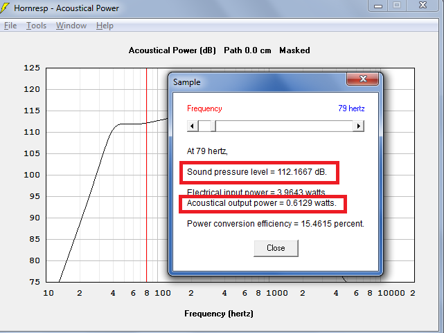

...long time Hornresp user here. Thanks again for the program!
I have a question that I've been researching with no luck.
In efficiency, the acoustic power used to be 112.17db = 1 acoustic watt (for 2 pi space).
Now it is showing 0.61 acoustic watts at 112.17db. This obviously gives very different efficiency results.
Could someone explain this or point me to where this was changed and the rationale?
Thanks in advance!
attachment.php

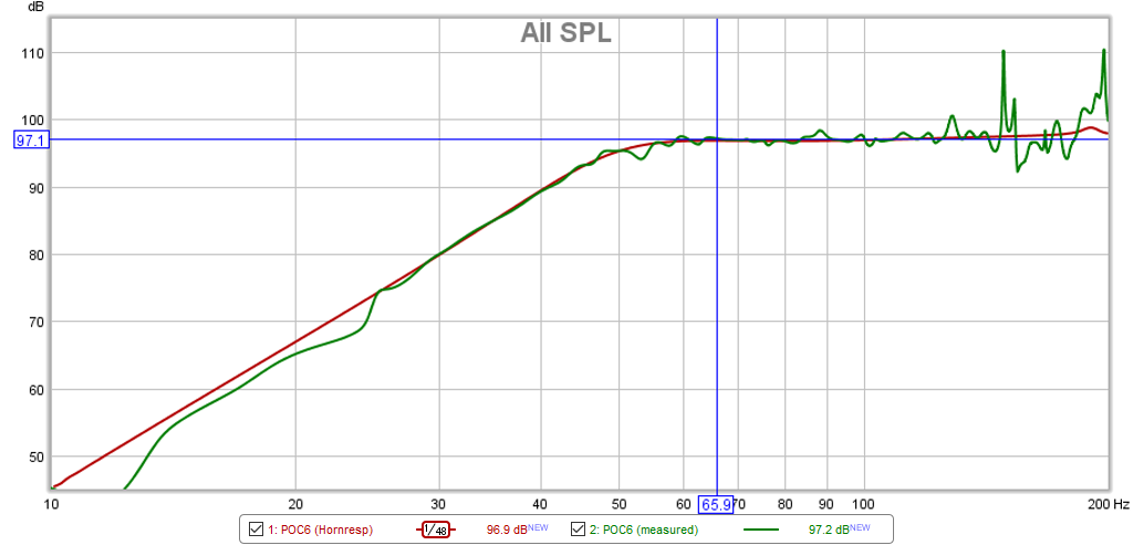

Thanks for this David. I'm now able to compare the measured response of my stuffed POC6 with the corresponding Hornresp sim. Considering the limitations of the measurement (transfer-function approach that introduced a bit too much noise above 150 Hz and below 35 Hz), the result is almost identical for the passband I was aiming for.
Note that I did line up the curves SPL wise, so there is the possibility that the POC's actual response is a dB or so what Hornresp predicts, but even then, the correlation is so close that I'm going to try to repeat the measurement again this weekend just to confirm it LOL.
Thanks!

Awesome!
Nice to see a measurement line up with a simulation Brian.

Hi Brian,
Thanks for the feedback.
The comparison looks almost too good to be true - it would certainly be worthwhile checking that the result is indeed repeatable :).

Hi publius,
It was a bug, reported by Sabbelbacke in Post #4179, and subsequently fixed. It applied to combined responses only.
http://www.diyaudio.com/forums/subwoofers/119854-hornresp-418.html#post3810728
Kind regards,
David
Just to clarify - system efficiency was changed from 'total acoustical output power' / 'total electrical input power' to 'net acoustical output power' / 'total electrical input power' with the release of Product Number 3300-131130. The error reported by Sabbelbacke was inadvertently introduced at that time. The change from total to net acoustical power is the reason why the old value of 1 acoustic watt is reduced to 0.61 acoustic watts in the example provided by 'publius'. The power difference seen is not caused by the bug, which was quickly fixed.

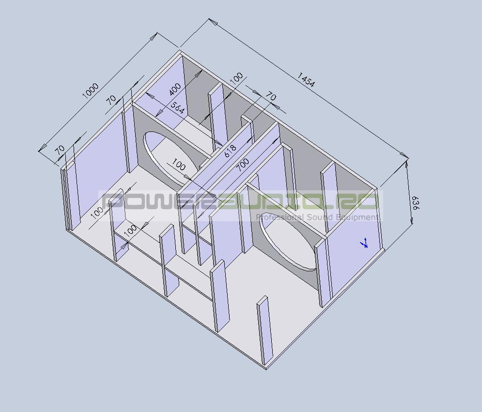

Then David ...
It took me a while to respond, due to some unforeseen
But anyway, maybe I was not so clear in my doubt. With respect to Annexes 1 and 4, yes, they fit as Tapped Horn's. As for annexes 2 and 3, they are horns with ducts in series, where:
Annex 1 is a version of Planar Horn, modified by a designer here in Brazil.
Annex 2, is a medium horn with duct at the mouth of the throat.
I would like to know how to configure Hornresp for the soft stuffing of this duct in series on these horns. Here are some new photos attached to these same models.

Hi M1 Audio,
Sorry, but I am not sure how to interpret the information contained in your post :).
As far as adding filling material is concerned, it can be specified using the Loudspeaker Wizard tool.
With regard to the design configuration shown in your Attachment 1, it would probably need to be simulated using AkAbak. There are limits on what Hornresp can do.
(If anyone else can help out with answers for M1 Audio, then please do not hesitate to do so).

Based on the area circled in red you could conceivably model this in hornresp.
The drivers are close enough to each other that they will essentially behave as a composite driver until the reproduced wavelength is shorter than that of the cone area. You can model one half as a driver horn combination by modeling one driver and the corresponding mouth area occupied by one of the drivers in the stack. In other words divide the driver mouth area into three and model a driver into that amount of horn area. Then you could use the multiple driver tool to model them as a composite set of drivers. It would get you in the ballpark of what the true output could be.
Hornresp will be next asked to model the sound of a butterfly flapping with only one wing ;)

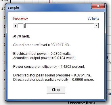

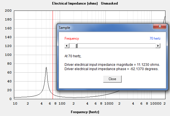

Thank you.
Now, I am stumped on the input side, electrical input power. I thought Real AC power was defined:
P = e^2 / Z * cos(theta); where cos(theta) = Re/Z
which reduces to e^2 / Z^2 * Re
but that gives significantly different results than what is shown in Hornresp, so I must have the wrong equation.
Putting some numbers to it:
e = 1.84
Re = 3.4
Z at 70Hz = 11.123
plugging into the above equation gives P = 0.0930 watts
Hornresp indicates 0.2802 watts electrical input power at 70Hz.
Where have I gone wrong?
