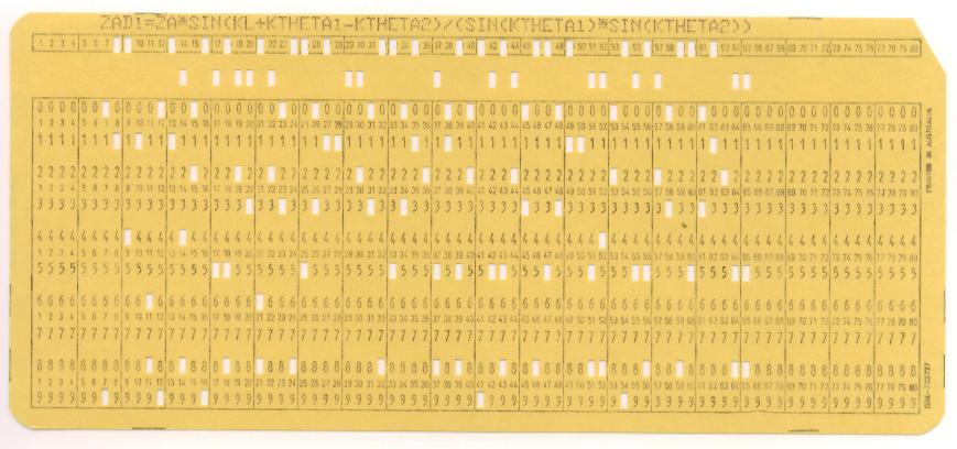

How long ago did you first start working on the HR program?
The very first version was written in late 1969 / early 1970 in the Fortran IV language. The attachment shows one of the 80-column Hollerith input punch cards from the original source code listing.
Have you thought about having a donations link on the download page? I'm sure many of us would be inclined to contribute a bit as thanks towards your efforts.
Just knowing that Hornresp serves a useful purpose and is appreciated by users, is enough for me :).
Kind regards,
David
