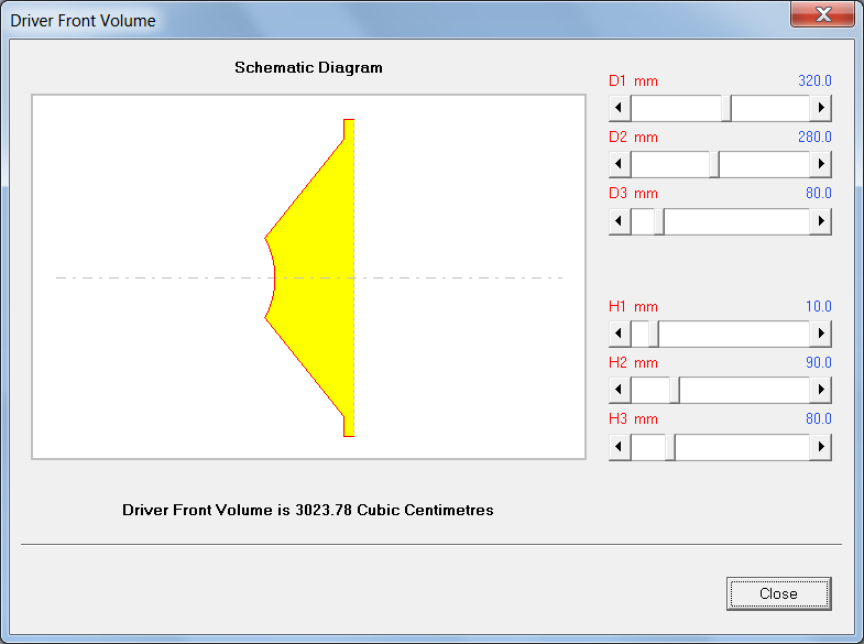

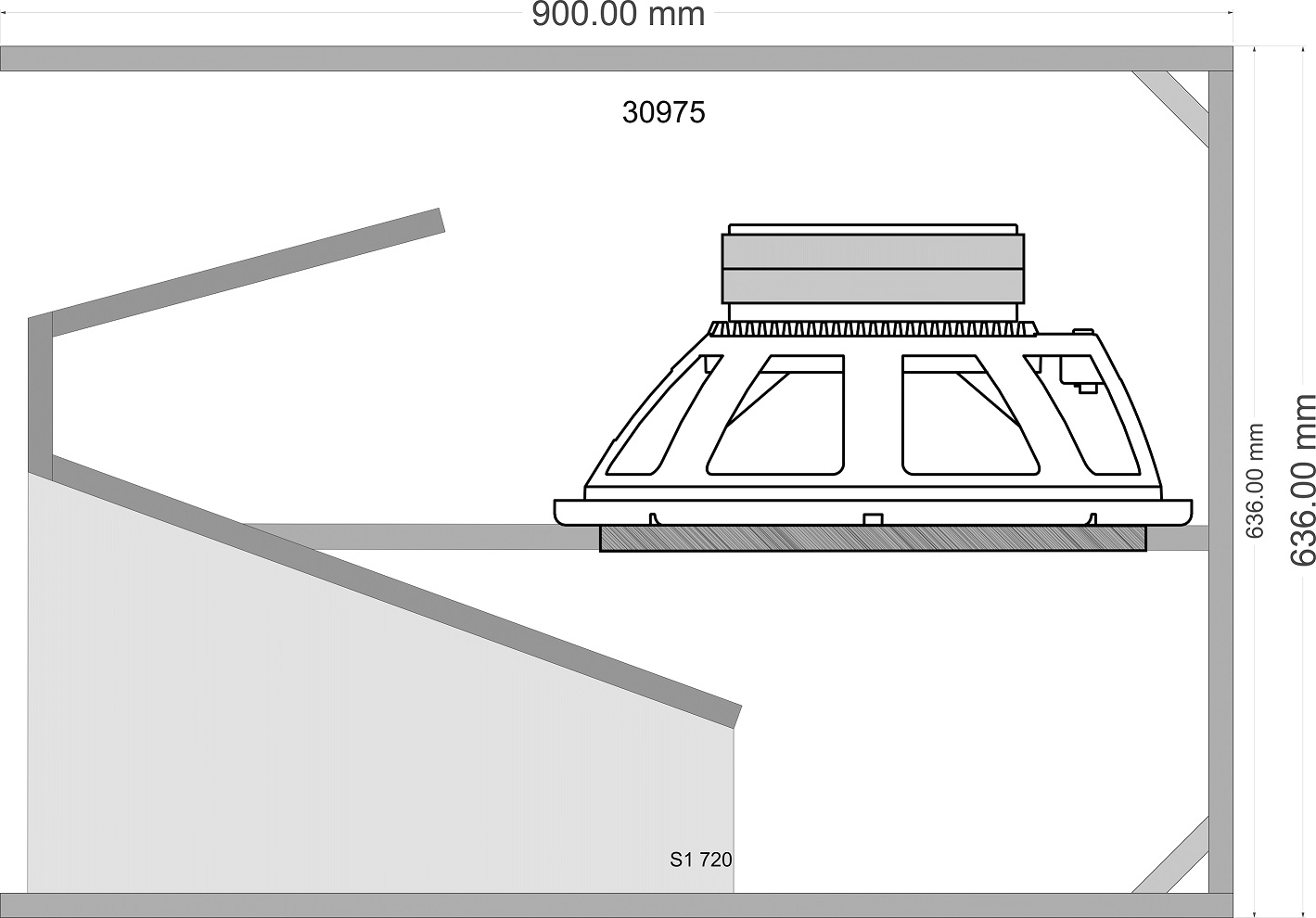

I have designed one compound horn box.
Need guidance about input in Hornresp.
Atc & Vtc still confuse me.
Hi jayam000,
For your design set Atc = Sd and Vtc = the air volume in front of the driver cone.
The required Vtc value can be found using the Driver Front Volume tool.
Kind regards,
David
