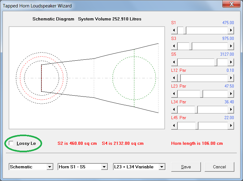

How do you decide if the tool should be used on a particular driver? What physical or electrical specifications do you consider when making the decision?

My old cutoff point was Le/Re=1. And really any driver that looks beefy and/or has very high power handling. I was certainly not aware that the adjustment makes all sims for all drivers more accurate, I haven't even thought that might be the case although it does make sense as the adjustment formula is based on a log curve based on advice from you and LTD02 so there's vastly diminishing issues with moderate or lower Le/Re. Thanks very much to Ricci for pointing this out. I'm incredibly busy now so it might be quite awhile before I can run some sims on some of the pro driver measurements on data-bass.
I also agree with Ricci that the checkbox should be called "Lossy Le". At the time I did the study and wrote the paper I was well aware of lossy inductance but I wasn't sure it was the main culprit here. It always should have been called Lossy Le.

Hi Josh and JAG,
Thanks for the feedback. Even though we adjust Bl rather than inductance, "Lossy Le" it will be .
Until I read your comments about all drivers, I thought that perhaps "Large motor" might be an appropriate term to use since it relates to both voice coil and magnet, and to the Bl parameter, and implies that the driver will be physically relatively large and "powerful", making it easier for the uninitiated user to identify suitable candidate drivers.

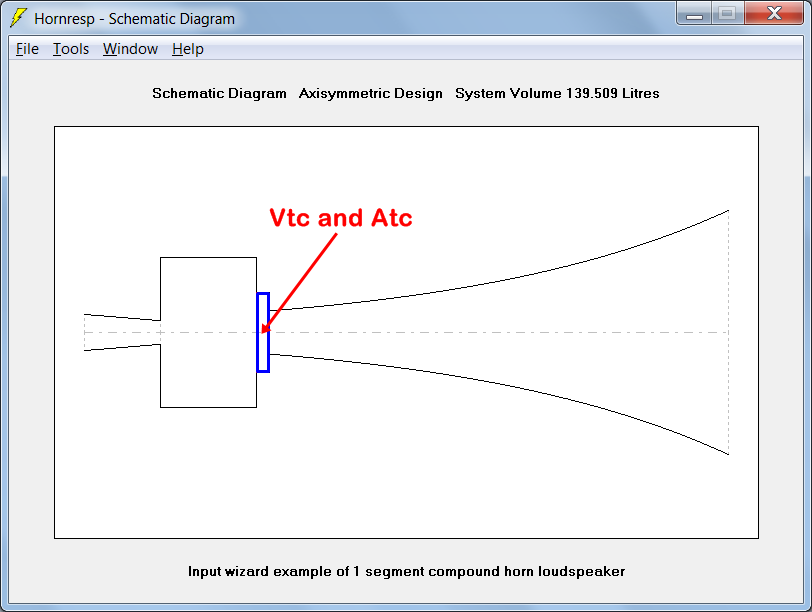

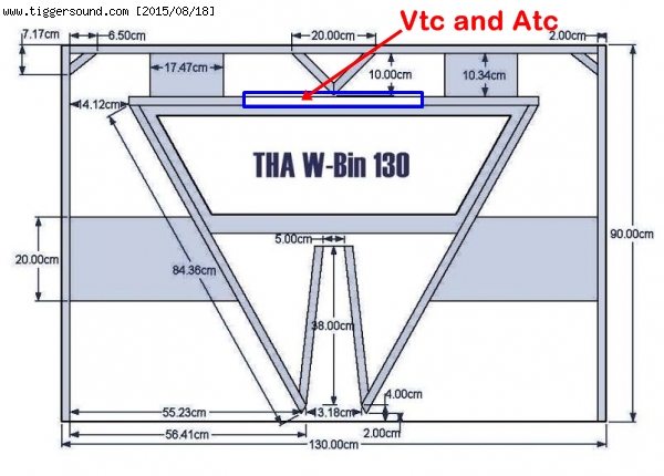

Hi jayam000,
The system you show should be modelled as a compound (CH) horn, as shown in the attachment.
Kind regards,
David
Hello david
Do I understand correctly?
Hi jayam000,
Kind regards,
David
Thanks you very much.
I will try this way.

"Large Motor" is pretty much the same as "Large Coil", in fact I was originally thinking of calling it the "Large Coil and Motor adjustment" but that was too wordy.
The purpose of the adjustment is simply to get a more accurate sim, the culprit for the accuracy issue is lossy inductance. It's Bl that we've shown can be adjusted to make the sim more accurate but that's because the lossy inductance issue presents as a weaker motor than the t/s specs would suggest. So the whole issue is about inductance, Bl being the adjustment parameter is just a consequence. So I don't think the checkbox title should reference Bl. It should just be called "Lossy Le" or "Lossy Inductance".
If you want to reference Bl and make it stand out to indicate that Bl is the moving parameter here, like I said, maybe just put a Bl = X in red in the place where you put the sealed box qtc in the wizard.
Those are my thoughts but I'm certainly open to discussion.
Hi USRFobiwan,
It seems that "Lossy Le" is the more technically correct term to use. I will try to make it clear in the Help file though, that the feature is primarily intended to be used with drivers having large motors.
The check box setting will be retained in the next update, and will also be automatically transferred to the main input form. It will also be possible to select the option directly from the main input form rather than having to use the Loudspeaker Wizard, and to permanently save the setting to the data record if so desired.

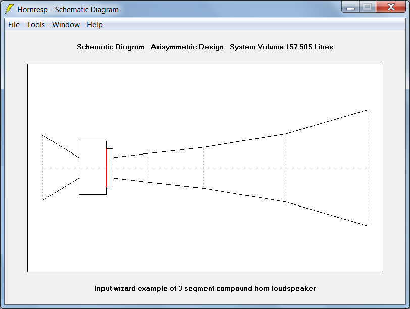

Hi jayam000,
You can of course use up to three segments, plus a throat adaptor, to specify the bifurcated folded horn.
Kind regards,
David

Hi jayam000,
Kind regards,
David
Thank you very very much.

I forgot to add that for systems like the one shown, the air volume in front of the driver cone is also normally included in the value for Vtc.
