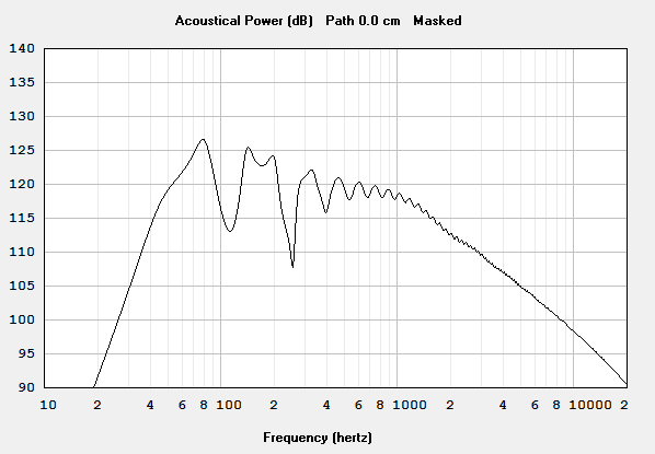

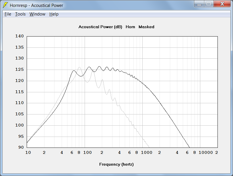

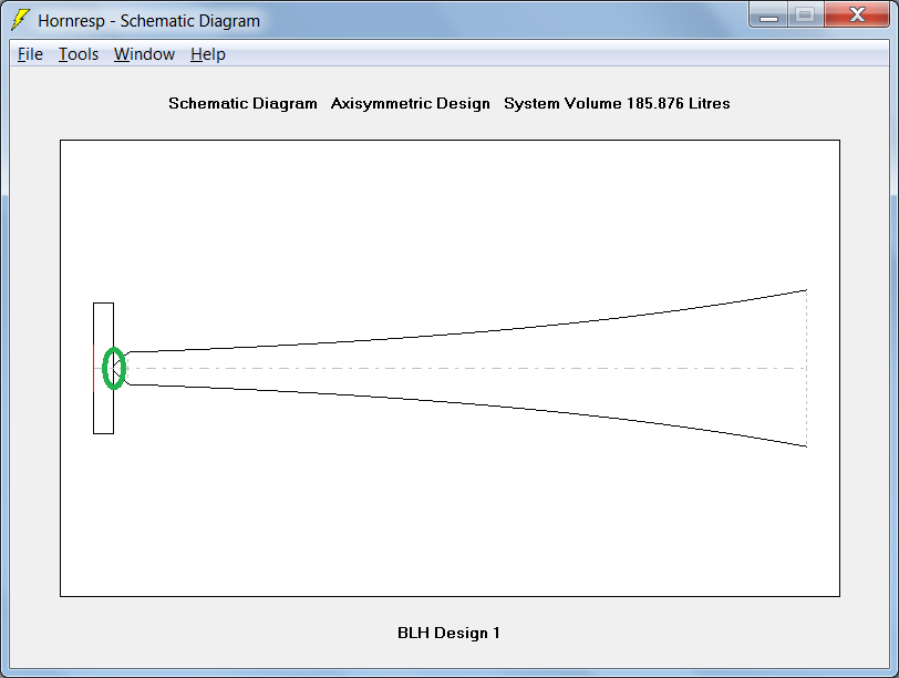

Hello,
So I posted about a week ago regarding having someone look over my data to see if it makes sense.
After spending some time fiddling in Hornresp I have just found that the Bass Reflex would be the best option. Are the curves actually this dramatic in real life?
I was expecting a BLH enclosure to be best considering that is what Fostex recommends.
Any help at all on this would be greatly appreaciated.
Craig
Hi Craig,
The three BLH designs you show all have relatively small mouths for the horn flare cutoff frequencies being used. This means that the throat impedances will be very peaky, resulting in the response curves you are seeing. Attachment 1 shows the throat acoustical impedance for the Fostex recommended BLH.
BLH Design 1 and BLH Design 2 have unrealistically small "pinched" throats (Ap1 = 1 cm^2 in each case). Attachment 2 shows the schematic diagram for BLH Design 1.
You have specified the Infinite Baffle design as a closed-box loudspeaker radiating into quarter space (Ang = 1 x Pi).
If you want to simulate a true infinite baffle, set Ang = 2 x Pi.
Use the Directivity tool if you would like to see the pressure response rather than the power response of the direct radiator Infinite Baffle design.
Kind regards,
David

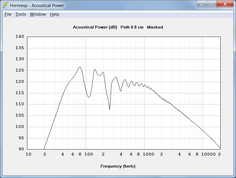

Hi David,
First off, thank you so much for replying, its rare to get such good feedback with something technical.
So have I not modelled the recommended BLH enclosure correctly?
I don't really understand the flare cut-off frequency issue as I thought this value was fixed if you have set the mouth, throat and length values? But I understand that a flare cut-off frequency of apx 30Hz is unrealistic.
Smaller throat gives the results attached. Is that not still very "peaky"?
Any help from anyone is again much appreciated!
Craig
Craig

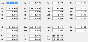

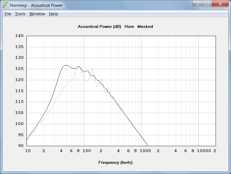

Hi Craig,
I think that you have probably modelled the Fostex recommended BLH okay - it's just that it appears to be a significantly compromised design to begin with. Because the mouth size is relatively small, the resultant impedance mis-match at that point causes significant reflections, making the duct act more like a resonant tube than a horn. The resonant behaviour can be seen quite clearly in the throat acoustical impedance chart results I posted earlier.
For your exponential horn example with S1 = 100, S2 = 2400 and L12 (Exp) = 240, the cutoff frequency F12 is given by:
F12 = c * Ln(S2 / S1) / (4 * Pi * L12)
where c = velocity of sound in air (assumed to be 34400 cm/sec)
Therefore:
F12 = 34400 * Ln(2400 / 100) / (4 * Pi * 240) = 36.25 Hz
Your revised design has the throat constriction removed, but the fundamental problem still remains - the mouth size of 2400 cm^2 is really too small for a horn with a cutoff frequency of 36.25 Hz radiating into quarter space. The value of Cir is 0.37 - ideally this should be closer to 1 to reduced the ripples in the response to more acceptable levels.
To illustrate, the grey trace in the attachment shows the horn output for your revised design. The black trace shows the output for a horn having the same throat size and cutoff frequency as your revised design, but extended in length until the value of Cir = 1.
That is:
S1 = 100.00
S2 = 17915.59
L12 (Exp) = 391.80
F12 = 36.25
Cir = 1.00
Kind regards,
David
Therefore:
That is:
S1 = 100.00
S2 = 17915.59
L12 (Exp) = 391.80
F12 = 36.25
Cir = 1.00
Kind regards,
Something else to perhaps consider.
The horn throat chamber acts as an acoustic low pass filter. The volume Vtc used in the revised design is 12 litres, which severely attenuates the horn response above about 150 Hz. I am not sure if this is intentional or not. The grey trace in the attachment shows the horn output for the original revised design. The black trace shows the output for the same horn, but with the throat chamber reduced in size.
Grey trace:
Vtc = 12000
Atc = 1700
Black trace:
Vtc = 500
Atc = 206 (same as Sd)

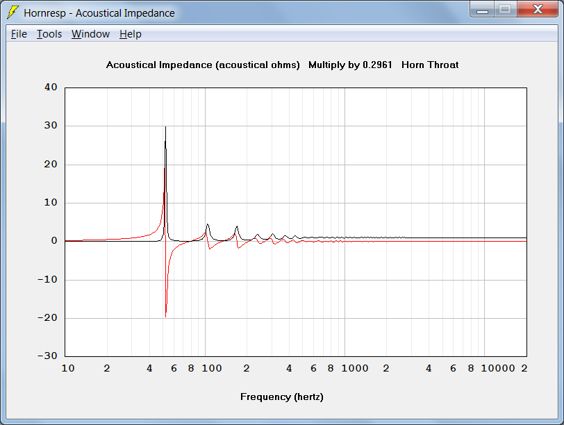

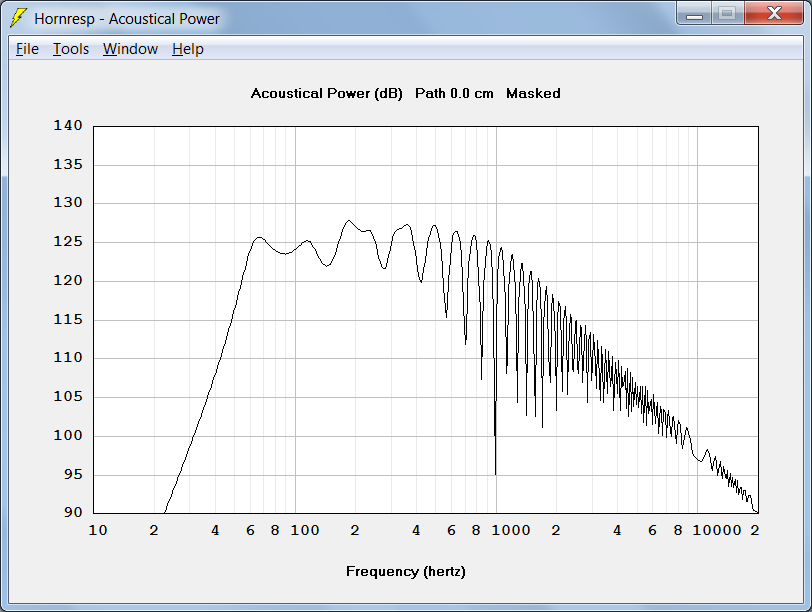

Grey trace:
Vtc = 12000
Atc = 1700
Black trace:
Vtc = 500
In the case of a back loaded horn the 150 hertz lowpass is a good thing. (Pretty sure David knows this) If it was intentional great work. If it was an accident then it will still work. Nothing is worse for imaging than having two very widely spaced sources of midrange content that are out of phase.
In the case of a back loaded horn the 150 hertz lowpass is a good thing. Nothing is worse for imaging than having two very widely spaced sources of midrange content that are out of phase.
Attachment 1 shows the predicted combined power response with the original throat chamber, Attachment 2 with the smaller chamber.
As expected, interference effects above about 400Hz are significant in the second trace.
