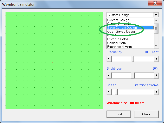

Wavefront Simulator custom designs can now be permanently saved by selecting the 'Save Current Design' option. Saved designs can subsequently be retrieved by selecting the 'Open Saved Design' option. Saved design files are stored in the 'Waves' sub-folder, automatically created the first time that the latest release is run. See Attachment 1.
The specification of Wavefront Simulator source delays has been simplified, and source delay values expressed in degrees now remain as specified when the frequency setting is changed.

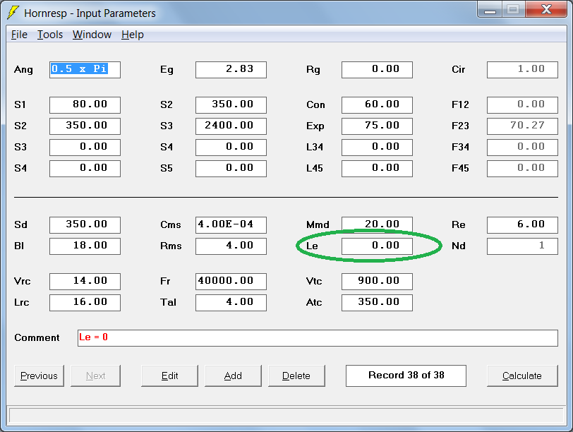

The value of driver voice coil inductance Le can now be set to zero. This change was requested by a user investigating the performance of high frequency acoustical waveguides and their associated drive units. See Attachment 2.

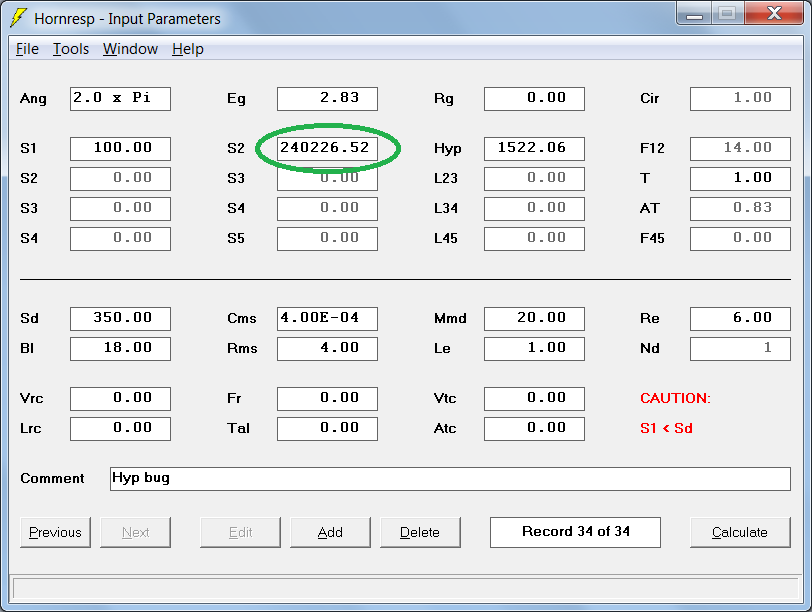

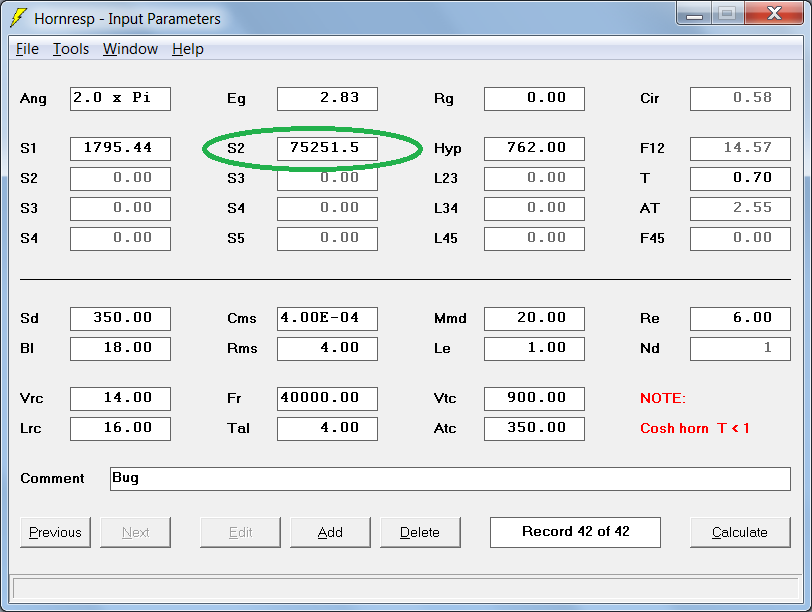

BUG FIX
Under certain conditions it was possible to enter an area value containing nine characters (format nnnnnn.nn) into the S2 input box for a hyperbolic-exponential horn. This has now been fixed so that the maximum number of characters is eight, with the S2 area format being automatically set to either nnnnn.nn or nnnnnn.n depending upon the horn mouth size. See Attachment 3.

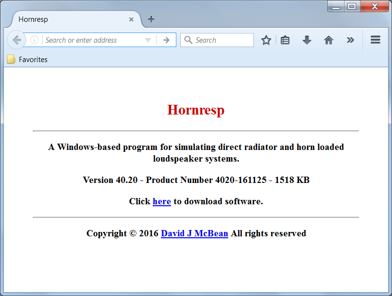

NOTE
The Hornresp download site page has been simplified to show only essential information, and now also makes reference to direct radiator loudspeaker systems. See Attachment 4.
