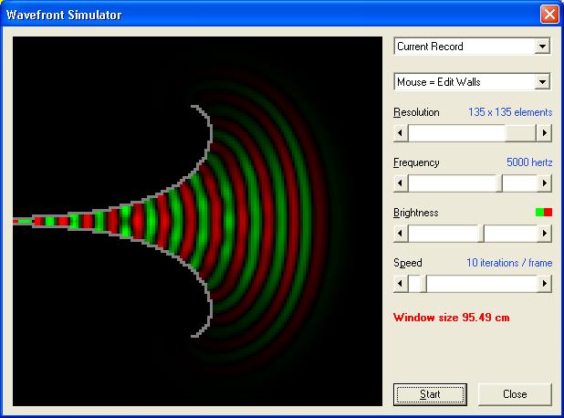

Hello,
I have try to simulate a standing wave in a tube (that's why I sent an e-mail to know the celerity of sound), but it's difficult to tune perfectly.
Anyway, it's almost possible: I have a quasi standing wave.
So, if i see a standing wave, i do not see the wave front, then it's not a wave front simulator but an acoustic amplitude simulator which does not the difference between wave front and reflected wave front!?
(my tube: 80 for diameter, 68,5 or 68,4 length for 400hz...)

David McBean said:
If I understand correctly, I think you might be trying to use the Wavefront Simulator for something more than it was designed for . It simply shows how theoretical isophase wavefronts propagate down a horn towards an open mouth - that is all. In real life, things are more complicated than that.
Hello,
If i tried to simulate something the software wasn't designed for, I will not have the desired result but I have the desired result ie a standing wave, which is not a propagate wavefront.
Or it's my reading of simulation that is not good.
With this simulation, I defined a standing wave with a center Stationary black area (0, node) surrounded by an alternating red (+, antinode) and green (-, antinode) area through the black (0).
I mean an alternating red>black>green>black>red>black>green...(+>0>->0>+>0>-...) with a (almost, depending of precision adjustment I think) stationnary position.

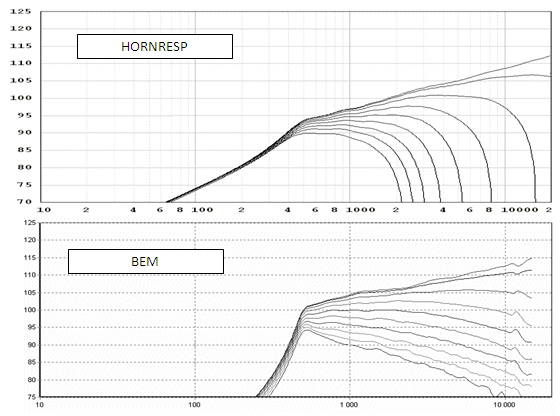

Hello David,
The question I raised, is quite independant on the ability of Hornresp to predict any frequency response at a given angle from the axis.
If, for a constant velocity source at throat, we compare BEM and Hornresp responses for different angles from axis, we can see that within an interval of frequency of 2 octaves above the frequency cut-off (illustrated case is for a Le Cleac'h horn having a cut-off of 425Hz, BEM simulations performed by Bjørn Kolbrek)Hornresp gives quite similar results until 40 degrees off axis.
The BEM simulations with a real compression driver show only a small difference with the constant velocity hypothesis.
When using the constant velocity hypothesis we allways obtain a rising on axial response of many horns (not only for the Le Cléac'h horn)
On the other hand we have dozens of axial response with the different drivers on Le Cléac'h horn or Kugelwellen horns or Tractrix horns... and they never show rising slope on-axis frequency response.
We have to explain why.
May be it is a question of distribution of pressure on the driver throat...
May be we have to question the constant velocity model used in the simulations...
Best regards from Paris, France
Jean-Michel Le Cléac'h

Re: Re: Re: Re: Re: Re: Re: Re: HORNRESP VERSION 22.10
Hi Jean-Michel,
The constant velocity diaphragm model is very straightforward, I wouldn't have thought that there could be too many problems with it.
Assuming the power response simulation is reasonably accurate, couldn't the rising on-axis pressure response prediction be due simply to Hornresp over-estimating "beaming" effects at higher frequencies - ie the actual beamwidth is not as narrow as that predicted by the program?
Would you still like a constant acceleration option to be added to Hornresp?
Kind regards,
David

thend said:In this case, where is the propagate wavefront?
Hi thend,
It doesn't really matter - isophase wavefronts can be considered to be defined by either the red, green or black lines.
Hopefully the attached example will make things a bit clearer.
Kind regards,
David
