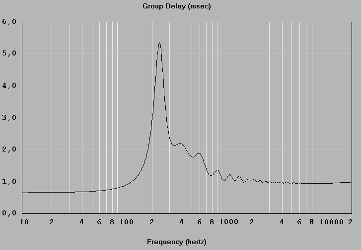

Jmmlc said:Hello David,
An easy feature you could also add to HR is on the group delay graph.
It could be interesting to have a button allowing to express the group delay in equivalent distance travelled at the speed of sound.
Best regards from Paris, France
Jean-Michel Le Cléac'h
Or in equivalent wavelengths to evaluate the magnitude of the corresponding summing error
btw: Now I know that my PA midrange horns exhibit more than one wavelength of group delay at 230Hz, this explains all the summing problems and why adding a 2nd order allpass around 230Hz with a Q around 2.2 to the bass horn improves things a lot... (This group delay is spatial loading dependent too)
Hello Eva,
It is a good idea but a bit difficult to implement as at high frequency there will be in many case a lot of noise on the group delay curve.

Hi Jean-Michel and Eva,
Group delay expressed in units of time is good enough for me .
The raw data can of course be exported and manipulated external to Hornresp, if so required.
Kind regards,
David
PS - Thinking about it a bit more, I guess I could at least add the the equivalent distance value, and possibly even the number of wavelengths, to the group delay chart Sample tool results .

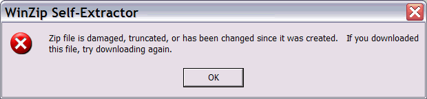

It seems that Hornresp users don�t have dial-up Internet connections.
Greets!
I can understand why, I had to use the emergency dial-up for a bit and the forum page was taking 'forever' to load, change to 'post', etc., so waited till I had DSL again before trying to post this.............
Anyway, after ~4 min. it 'completed' at only 646 kb and got this error message when I tried to open it:
GM
PS - Used HR some more and still no virtual memory, etc. problems (he says with fingers crossed).
Hi GM,
Many thanks for this. You have helped to confirm that there is definitely a problem downloading Hornresp from the new website via a dial-up connection. I will go back to my ISP and see what they can do about it.
Excellent!
I think it is probably unlikely that the two problems are related, but I have been wrong before .

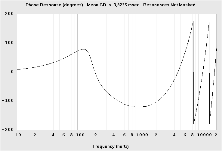

Hello David,
This new version is nearly perfect!
Here attached a very smooth phase curve for a Le Cléac'h Fc = 160Hz horn (T = 0)
Something that could be interesting to have in a future version of Hornresp should be a preset for a constant velocity diaphragm...

Hi Jean-Michel,
Thanks to you .
It looks great!
I will keep it in mind .
Kind regards,
David

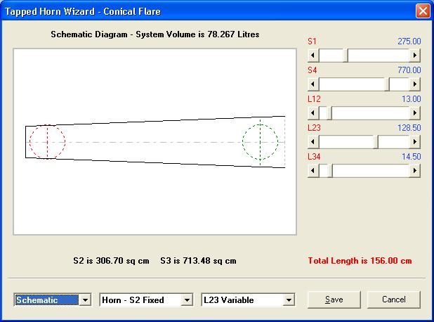

David_Web said:A little feature request.
Could you add a liter counter in the tapped horn wizard?
Just above or below the total length.

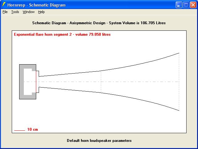

Couldn't resist :
... and also to the horn segment wizard?

David_Web said:Could you add a liter counter in the tapped horn wizard? Just above or below the total length.
Hi David_Web,
The system volume is already included in the caption above the drawing shown in the Schematic Diagram view of the Tapped Horn Wizard (see attached). This is my preferred location for the information.
Kind regards,
David
Cordraconis said:... and also to the horn segment wizard?
Hi Cordraconis,
Only if it doesn't require too much work - I'll have a look and see what would be involved. The volume of each segment is of course already given on the main Schematic Diagram when the mouse pointer is moved over the segment. The total system volume is also shown (see attached).
Kind regards,
David
