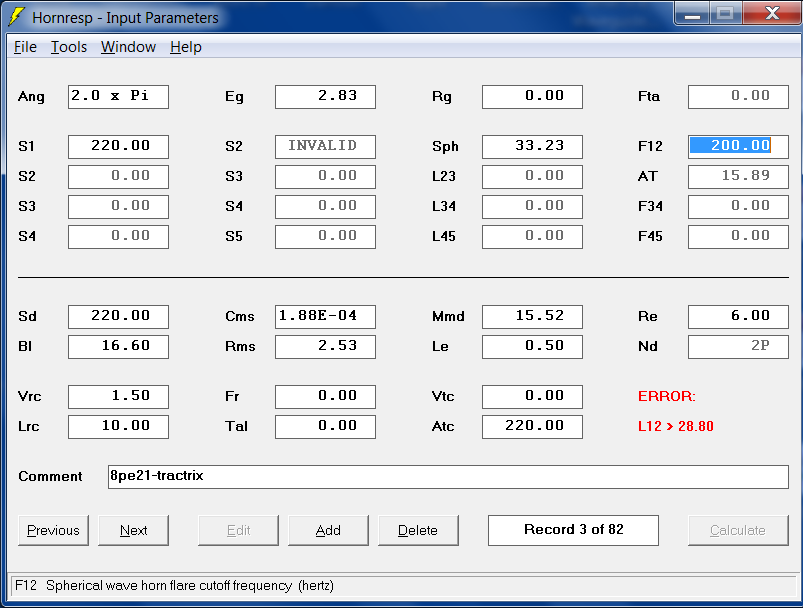

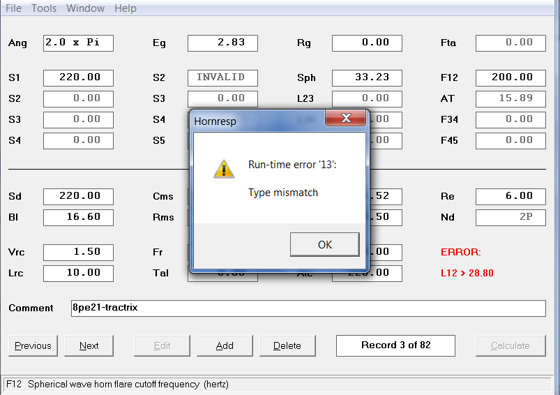

Sorry David,
A. choose a random record, d/click L12 change to S, change F12 to 200, standard warning L12 > 28.8
B. Change F12 to 180
C. D/click F12 -> Fatal.

Glad to do what I can.
Humbly, I was suspecting something with the 'INVALID' string, it's something I've done enough. Not important though.

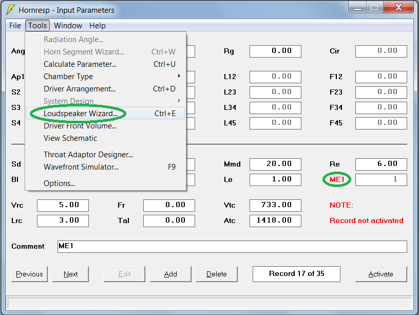

For ME1 And ME2 records:
1. The schematic diagrams were sometimes incorrect when selected from the main Input Parameters window.
2. The Loudspeaker Wizard tool menu command was enabled in Edit mode. For the listed record types, it should not be possible to access this tool in Edit mode. Attachment 1 refers.

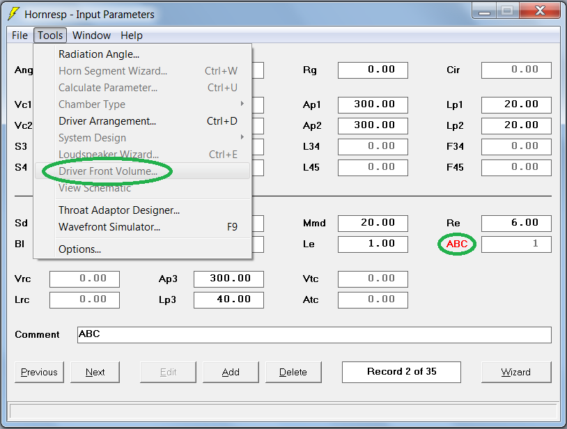

For BP6, BP8 and ABC records:
1. The Driver Front Volume tool menu command was disabled in Edit mode. For the listed record types, it should be possible to access this tool in Edit mode. Attachment 2 refers.
The above three bugs and the one reported by AllenB in Post #5832 have now been fixed.
