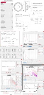

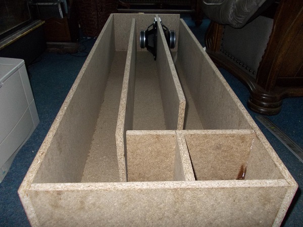

It's very hard to follow your work...Can you post the HR input Screen for Your picture: ScreenHunter_46 Feb. 02 19.36.JPG and if you also can post a picture of the 270 g Damping material when it is mounted in your box.
Whe I looked at your pile of remowed fill it looks like a Rat nest:eek:: Picture DSCN1319.JPG

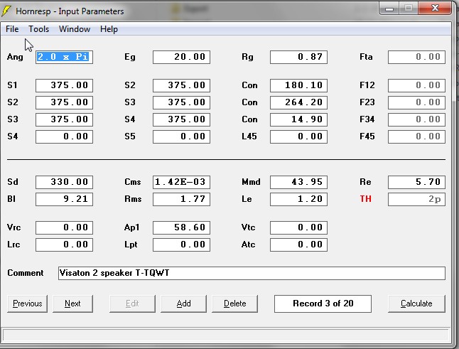

Hi Bjorno
Long time not see? oke, here are the post of the hornresp things.

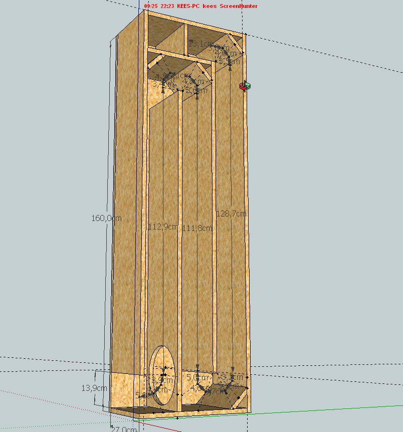

The T-TQWT has a isobaric speaker put in, these visatons have big vas.

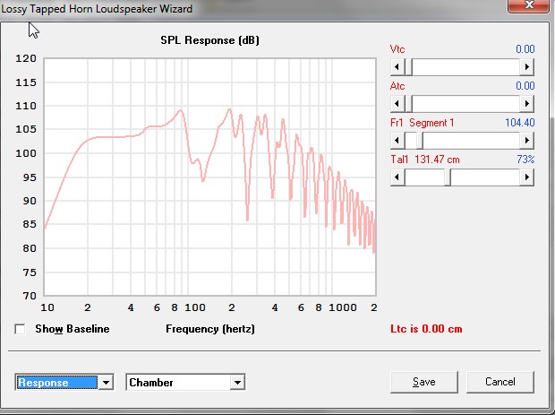

I do now now when I have a explosion on a movie, feel the keyboard of the pc shakes when I type on it that time, it is not as loud as a tapped horn but the bass is very clean and no booming things. The [peak on 100 hz wil not go completely away acept when heavy damping couse a loss in low end, the crossover however can help when choose the proper place to go over like 80 hz.
I am a little messy with things, and so sometimes difficult to follow, and afcourse mt sensitivity to a 6.5 watts wifi mast the nabure has, keeping me out of good sleep.
But now I go way offtopic.

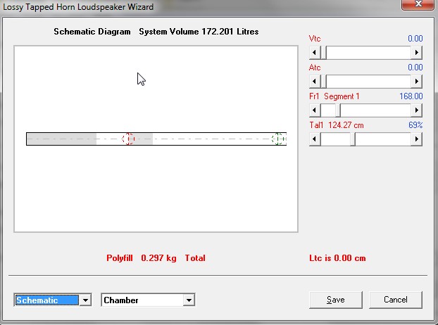

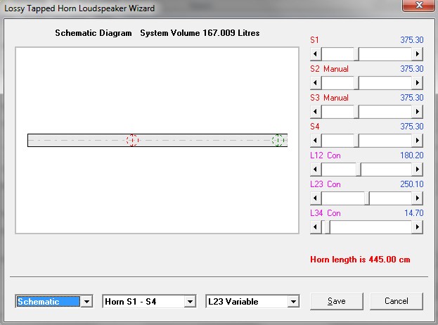

see pictures of the hornresp input and test, gray are the damping, I have no picture of the damping in the box, because then i have to open it again, I have put it on two places.
regards
kees

Actually, that's a TQWP or TQWT...straight tapped pipe or tube. There is no negative taper for the "T-".
Yes that is right, this did good on visaton, the big vas is a problem and so it is isobaric system, it do very well, fior 10 inch it go shaking deep.

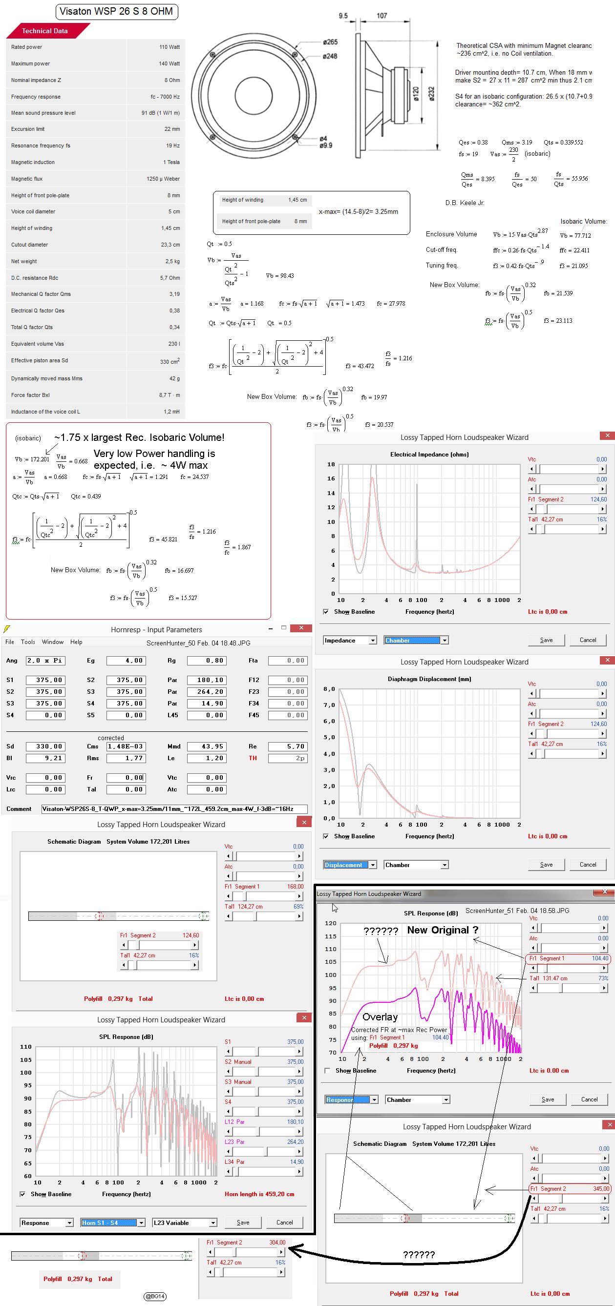

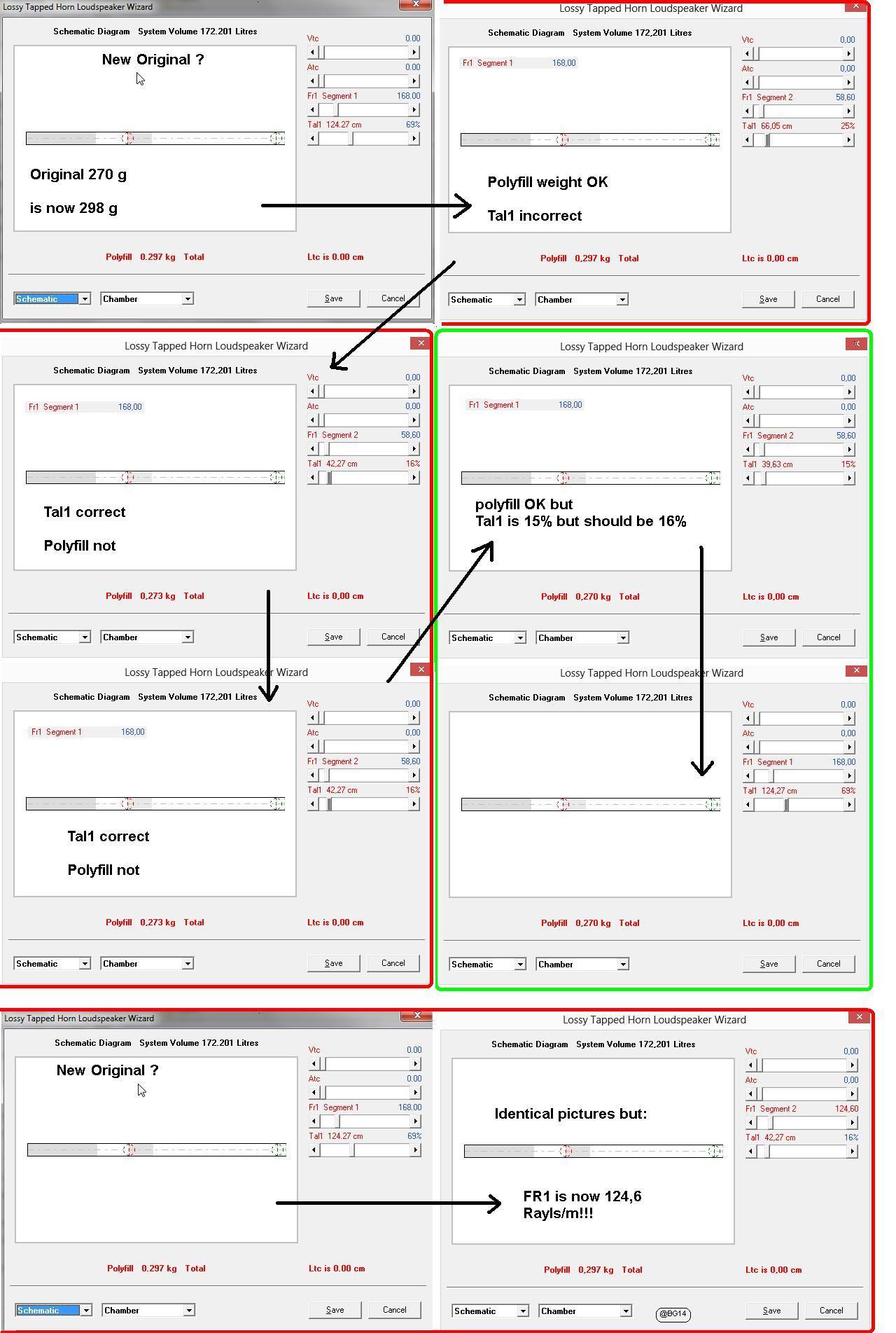

Hi Kees,
Thank you for the pictures but they were not exactly the ones I asked for. You've fiddled with the numbers again.
Have a look at my pictures where the the inconsistency are shown.
As for the stuffing:The numbers are in the ballpark but I suspect you stuffed your box at random. Rayls around 100/m is very thin and loose density that IME takes a lot of time to get right.
What Brand of damping material do you use?

Hi Bjorno
I had some screencaptures messed up, old ones with some new ones etc.
I do look at the respons of hornresp when do filling, why is some then wrong? I have put on your threat the original ibnput of hornresp of the box mentioned, that it is a straigt pipe is because the visatons did make trouble.
I can again try tapered now I can als put damping in thanks to David.
David, when I do damping in the box and save it, then reopen hornresp I get a complete filled box ? I have then to remove and retest the fillings, nice wil be when have the filling right and then a test with the crossover section of hornresp. Fr1 sits on 58.

Hi Brian,
Absorbent filling material can only be specified in the standard segments of offset driver and tapped horns.
(It is also possible to have acoustical lining in rear chambers, of course).

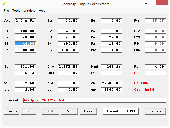

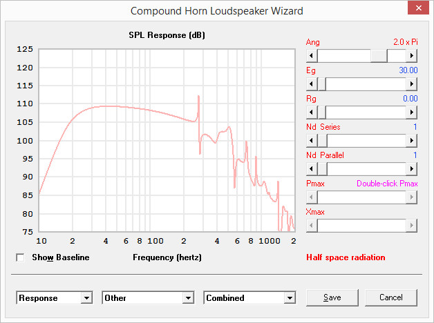

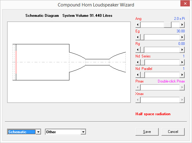

Ok, thanks. I was trying to sim the impact of stuffing in a vented alignment with a flared vent, as per diagrams below.
