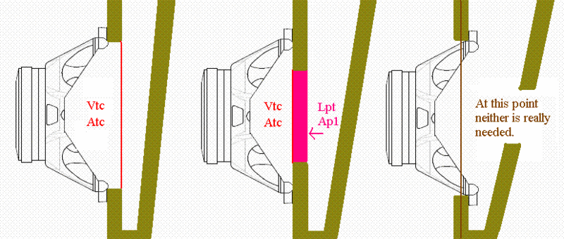

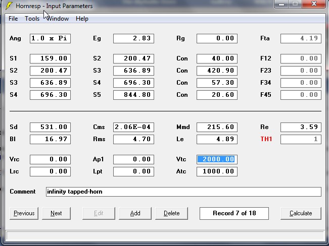

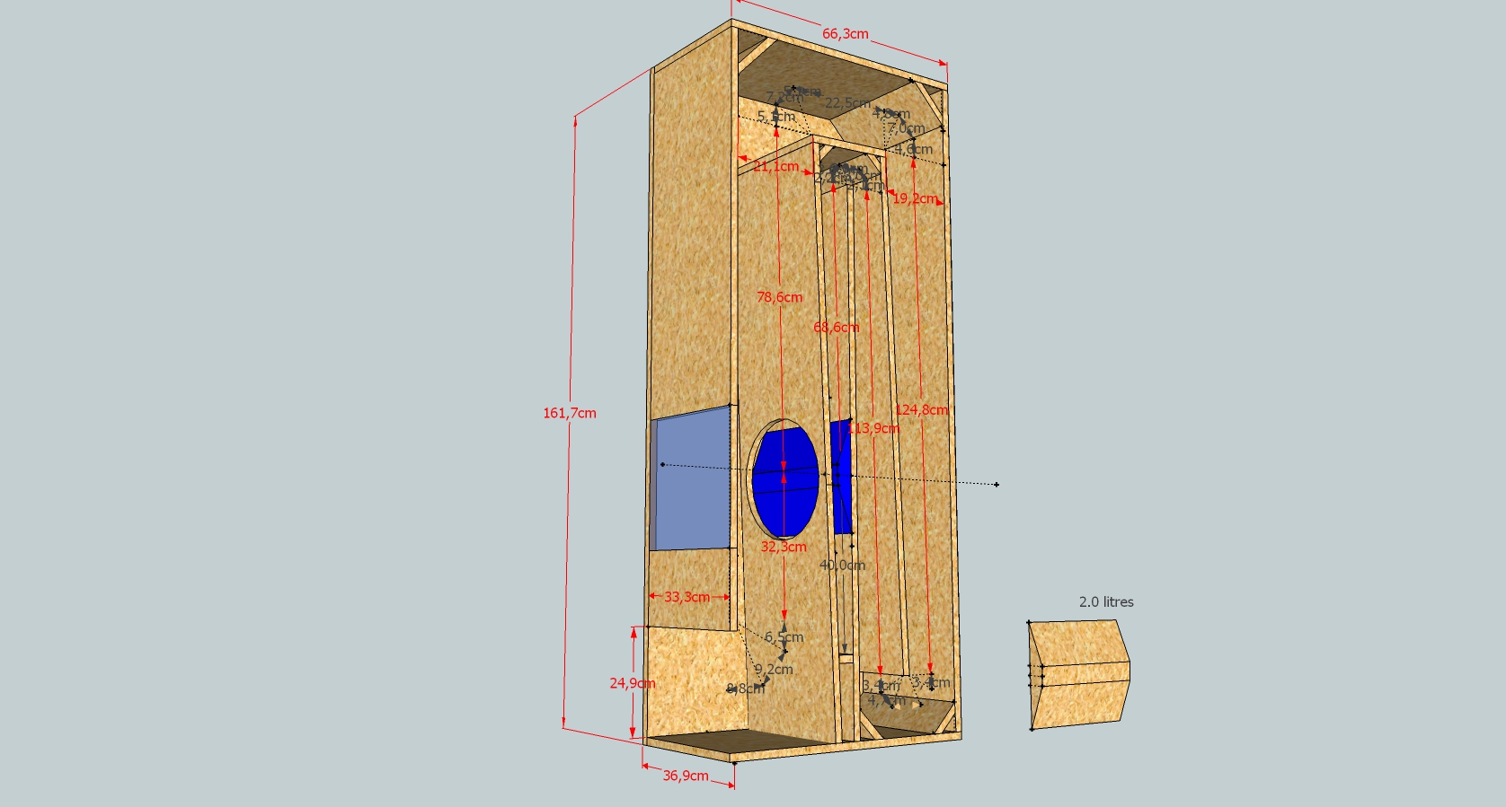

Hi David
In the past I did make this tapped horn design, still not yet tryed out yet.
I have a question because of the cone correction, I can do a try with hornresp to include that in the throat with the VTC and ATC function to put extra 2 liter to it because of the driver front volume therefore I had done this conecorrection like in photo, someone has advise me about it.
I did try the VTC/ATC function to put big volume extra, it did make the respons even better?? I think cone correction is not needed for all speakers here.
Maybe you can give a advise to me how I can do this properly, do I need always to use VTC/ATC combined or can I only use VTC? or ATC?
Do you like the response? this is a car woofer not so expensive. Where I can find damping material in hornresp?
thanks
kees

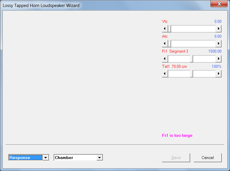

If I go above 1000 with the Fr1 glider things go wrong?, graph go away.
Maybe 1000 and above do not work anyway.

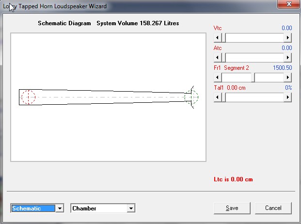

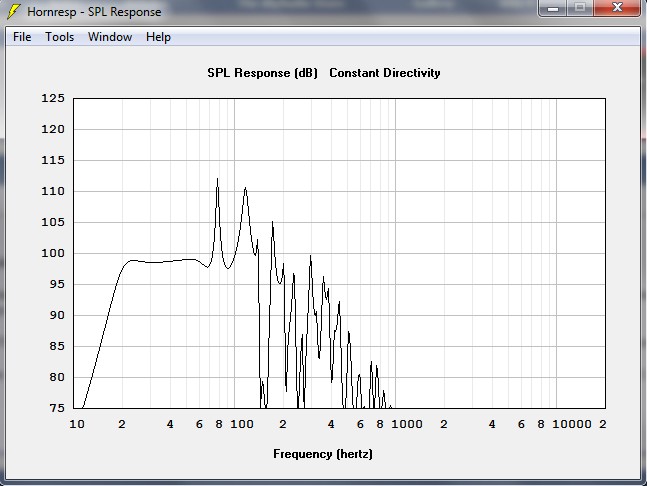

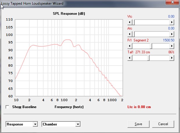

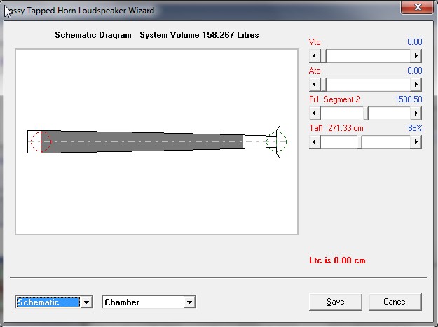

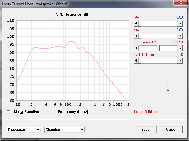

Update for the new damping thingie.
I did some tests, I do see that when I move the slider Tal1 nothing happen really, when go above some value I see it jums suddenly to a whole other graph response. You see the first two pictures Tal1 is 0.00 and the resulting graph, and second two pictures you see Tal1 is 271.33, but it is some random effect. it just switch between the two graphs.
Maybe I have find again a bug for you?. be the way the export is now fine, no errors anymore thanks.
see pictures.
further I can make response very nice with damping, I see that I have much to much in it.

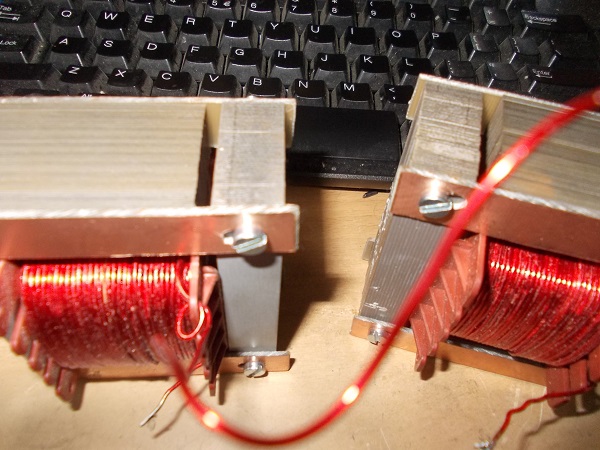

The trafo,s you see, I have made myself, with a gap I can adjust, so I have a easy way to go rfom 5 mH to 22 mH and 10 Mh to 30 mH, exact adjustable.

Hi Kees,
I am not sure that there is much to be gained by including the cone correction panel blocks as shown in your sketch. It is probably sufficient just to specify an appropriate throat chamber which takes the driver front volume into account. See the attachment below for details of three possible configurations. In Hornresp, it is necessary to specify values for both Vtc and Atc. It is not possible to use only Vtc or Atc.
More importantly - do you like the response? :).
From your later posts, I assume that you have now found what you were looking for :).
Kind regards,
David

Hi Kees,
Too much absorbent material has been specified in the segment. Reduce Fr1 and/or Tal1.
Fr1 specifies the flow resistivity of the absorbent material in a given segment, and Tal1 specifies the amount of filling in the segment as a percentage and also as a length. The first half of the Tal1 slider progressively fills the segment from the throat end. The second half of the Tal1 slider progressively fills the segment from the mouth end. If either Fr1 or Tal1 is zero, the segment contains no absorbent material.
Kind regards,
David

What concerns the damping and if I go higher then 1000, maybe it is better to do a massagebox in it who says to much fiber or something when I go to high? give program a nice look. now if higher then 1000 it go do strange.
Hi Kees,
If the total damping is too high, then the current chart will be hidden, and a "Fr1 is too large" message will be displayed, as shown in the attachment.
You should include the minimum amount of absorbent material necessary to achieve the desired response. Using too much simply attenuates the output.
