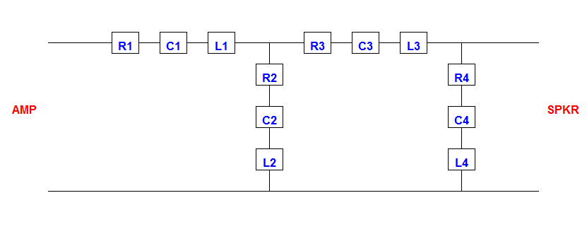

This is great news David. I can feel a wave of new creativity being generated!The tool will have limited capabilities, but hopefully will prove to be of some use, with the ability to model a number of different active and passive filter types. It will operate in much the same way as the existing loudspeaker wizard, with results being calculated in real time so that the effect of filter design changes can be seen immediately. SPL response and diaphragm displacement charts will be provided, together with a schematic diagram for passive filter layouts.
Have you any thoughts on filter types and filter orders that you consider to be achievable?

Hi Martin,
At this stage...
Passive filters:
User-specified networks fitting the attached template, with each of the four RCL branches able to connected in series as shown, or in parallel as suggested by Bjørn (Kolbrek). The attachment shows the maximum number of components possible, connected in full "series" configuration.
Active filters:
Low-pass, high-pass and band-pass Butterworth and Linkwitz-Riley alignments, orders 1 to 8.
Kind regards,
David
