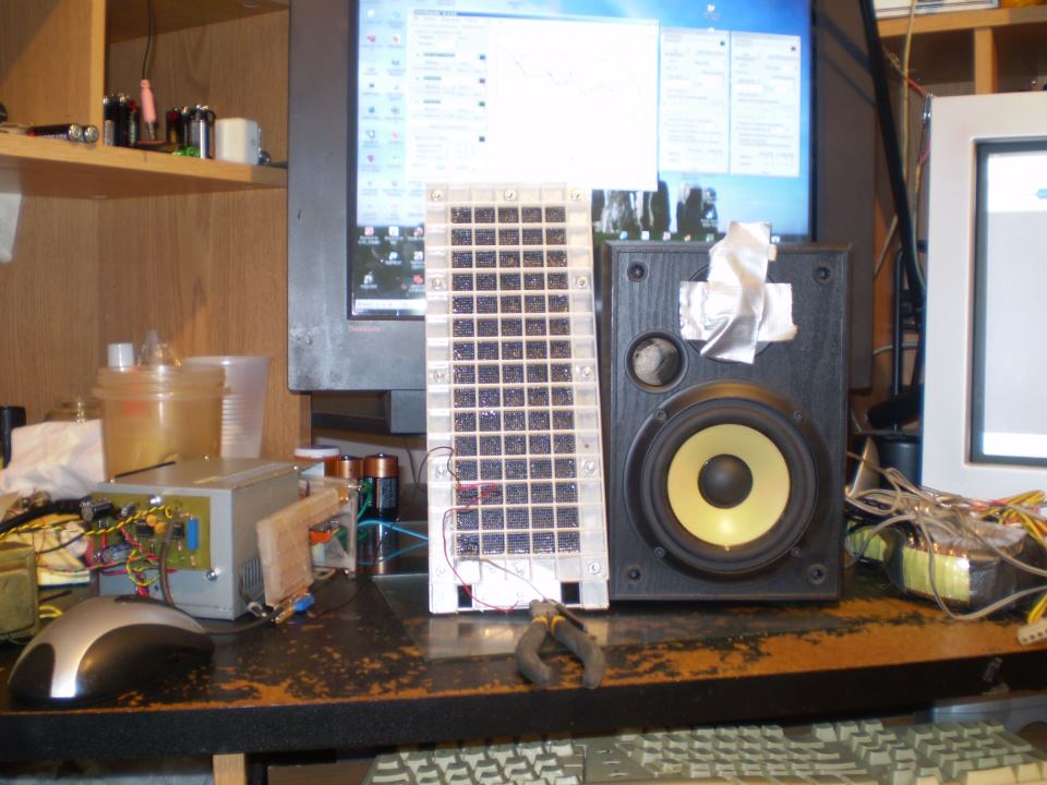

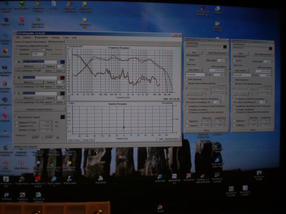

It wasn't so much as destroying the rear wave was the problem as this was a good thing,especially since the experiment was performed on my desk that has lots of cavity's that causes a few dips and peaks to the response.
But the loading up of the diaphragm (as others have asked "what happens if you put it in a box or stuffed the back of it") seemed to have the most profound and detrimental effect.
I don't have any photos of that particular experiment setup but I think there my be one or two in another thread somewhere.
jer :)

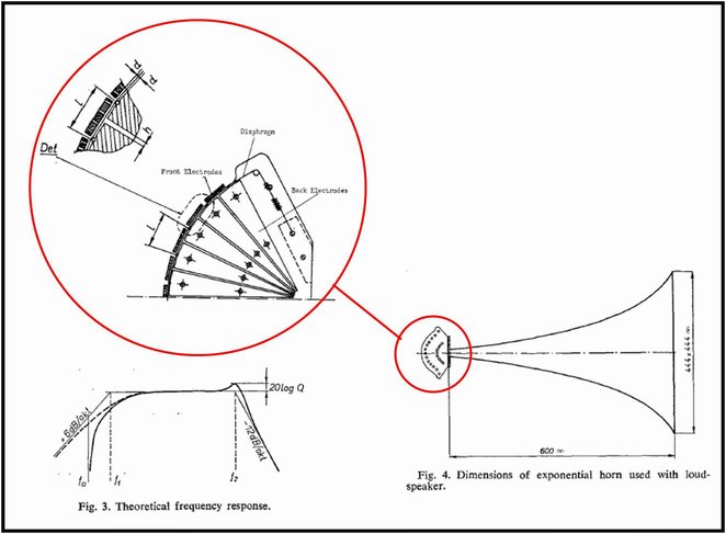

Except that a very good, working, ESL driven HF horn was built and documented decades ago and is available to read in JAES Audio Anthology Vol 1.
The ESL driven horn you refer to is not a simple case of horn loading an ESL panel. Rather, it is showing you how to get around the ESL loading limitation using a prisimatic wave guides to drive the throat of the horn with an ESL having an area 10 to 15 times larger than the throat.
More details/links back in post#8.
