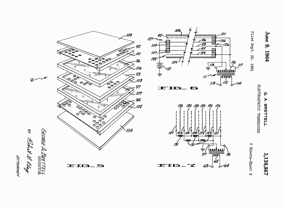

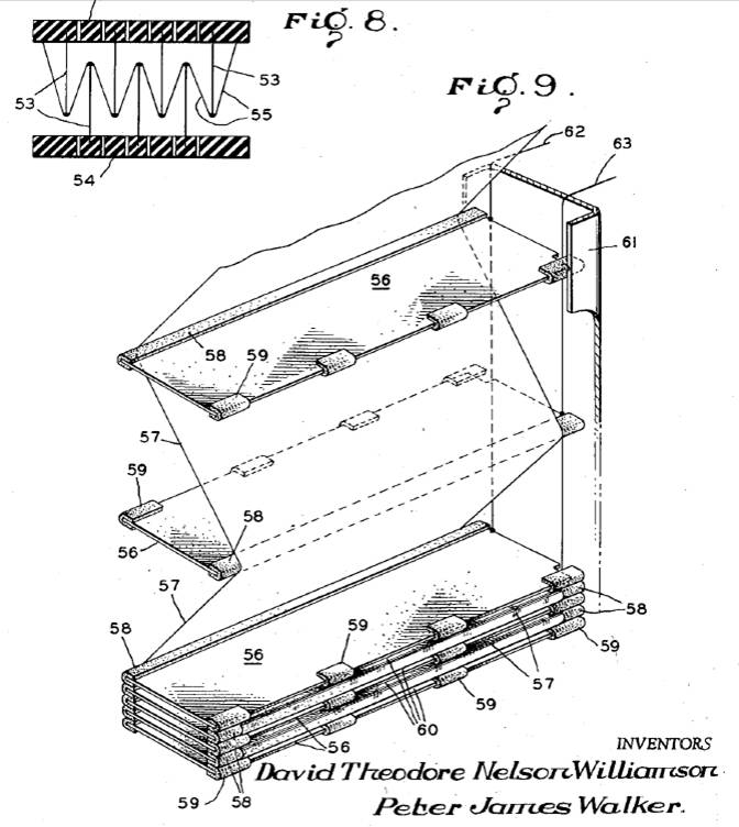

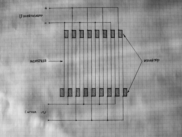

What you are describing (...large panel stack with a side exit...) is an ESL AMT(Air Motion Transformer).
I’m guessing you may have seen some sketches in the Electrostatic AMT thread:
http://www.diyaudio.com/forums/planars-exotics/153220-electrostatic-amt.html
Attachments #1 & #2 are some figures pulled from US patents 3,008,013 & 3,136,867.
Attachment #3 is a drawing of a stator-less AMT posted toward the end of the AMT thread.
What do you think the advantages would be to horn loading an AMT vs. the AMT by itself?
yes the one on the right is the sketch I was remembering.
The center diagram looks interesting. As does the left most one.
So we are not the first to have thought of this?
