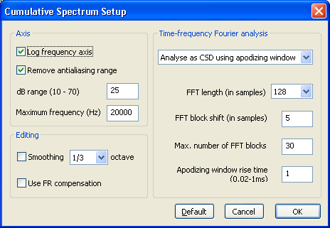

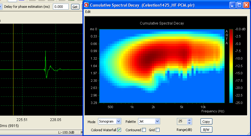

I don't think Burst Decay measurements should be gated, at least not a short gate. That will introduce its own artifacts. Better would be to build a small 'anechoic chamber' around the mic and the horn with pillows, foam, fiberglass, etc.
Or just use Jean Michel's settings for the CSD. I tried them and they worked well for me except I preferred it with the contour box unchecked. Move the cursor (no marker) on the impulse to get it to start where you want. Once you get JM's settings working well, change them one at a time to see what happens. If you change the settings, you'll probably need to move the cursor to catch the rise.

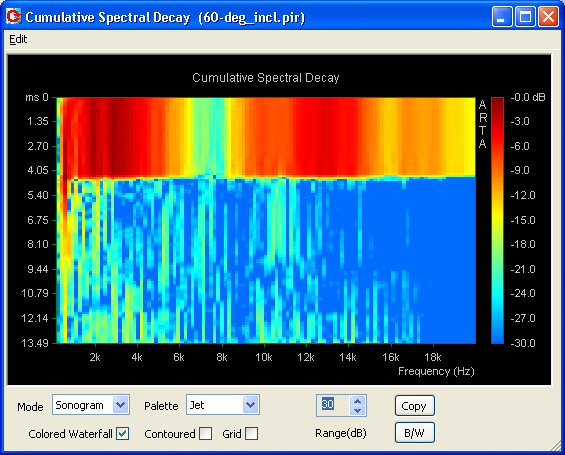

Sure – but this was an easy example – but what about the measurement of the 60deg included conical without any treatment - I've posted *.pir file ?
Here I really would liked to have some order put into – no ?

First measurements of conical dipole horns on NEO3W without any round over to possibly get the most horn honk ever.
Above "burst decay" visualisation in ARTA is a wavelet analysis too, but I really would wish for the scaling of the axis as "time" rather than in "periods".
Also a "normalisation" function would be extremely helpful to get the picture clean IMO – meaning not to get trapped by peaks in the frequency response that possibly stick out later on too...
The rectangular (almost quadratic) horns to measure – all with same contour length of ~20cm / 8":
60 deg included angle :
(Depth of horn ~ 17cm / 7")
120 deg included angle :
(Depth of horn ~ 10cm / 4")
Hello,
Without seeing the measurement environment, I would say everything before 3ms comes from the horn+cabinet and after 3ms is room reflections convoluted with the horn+cabinet response.
See here: At 3ms there is a presumable a reflection from a small object because there is no low frequencies present (low frequencies bypass the object by 'bending' over it). Maybe a microphone stand?
By the way, there seems to be some pre-ringing artefacts around 3kHz in both of 802 measurements. What that could be?
