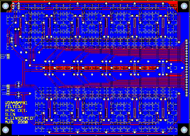

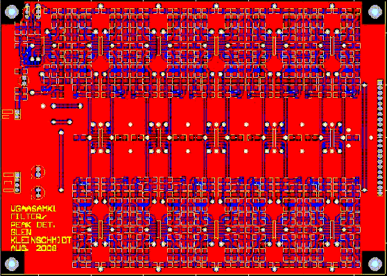

Anyway, was occupied mainly with home maintenance stuff this weekend, but I did manage to knock off the complete band pass filter and peak detector board layout in the evenings.
I have revised the design slightly from 20 bands to 21 bands, as 21 half octave bands is a better mathematical fit into the compete audio (20Hz-20kHz) frequency spectrum.
Top layer:
.....and the bottom layer.
One BC548, one BC558, 16 quad opamps (TLO74), 23 schotkey diodes, 143 capacitors and 300 resistors.

Glen
