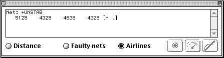

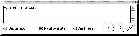

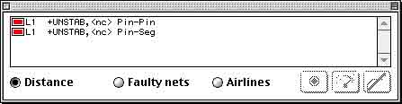

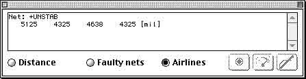

I made also an error but I mentioned it as soon as I discovered it. It's a little embarrasing because my CAD program has a list over all shortcuts, and "airlines" (traces with zero width). Why don't I just look at this window?
I don't know how Anthony deals with this but everyone can make boards with errors but when they are discovered why don't update the website as soon as possible? Costs nothing and when the pcb's are sold put a note on each pcb telling the errors.nikonfanatic said:I have a feeling these problems have lead to the lack of support by Anthony Holton, he is probably sitting on a large supply of PCBs that are faulty.
