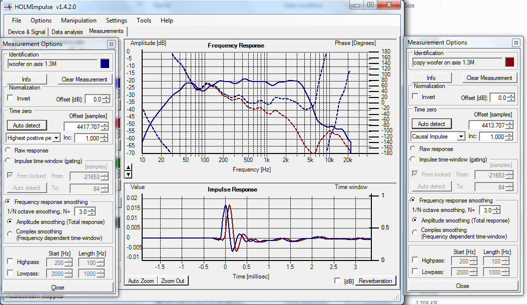

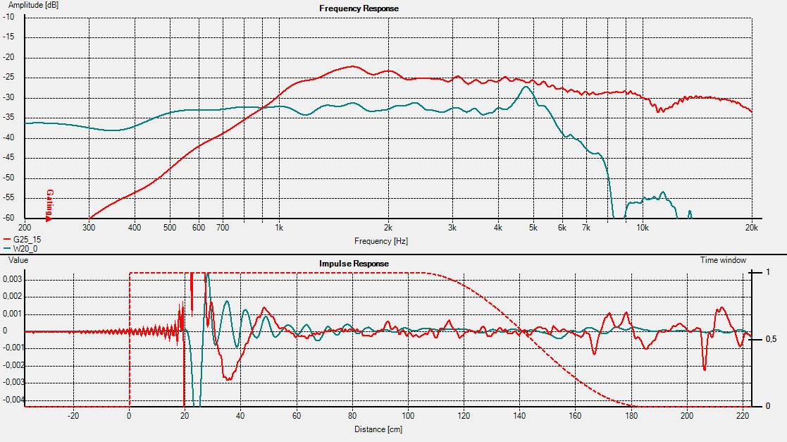

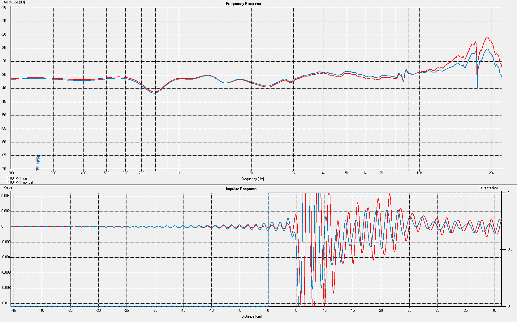

Hi, please, I'd like to ask you about my measurement attempt in Holm. I'am trying to develop crossover for 2way system with Visaton WS20 and G25 FFL tweeter with Waveguide WG148. Please see the attached photo. I am not sure about the oscillations before the main peak in tweeter measurement. Woofer has nice smooth impulse. But where should be the zero time in this measurement ? Thanks a lot.
Note: (I am using ASIO USB sound card ARES SC4, 48kHz, lowcost Megaton M-1 calibrated mic + 3dB preamp and LineIN).
pre-ringing indicatrs a problem with the measurement. strange tha you don't see it on the woofer measurement. I'd try again after a full system shutdown and startup.
If you are measuring on your final baffle, I would set the time zero on the tweeter measurement (make sure you tell it to do it twice, the first time it is slightly off. Then go to the second tab and lock time zero before measuring your woofer. This ensures that your phase data is correct for your crossover modelling.

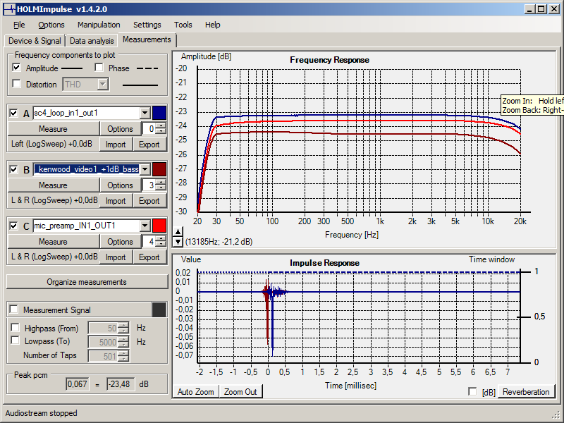

Thank you for the reply. Anyway, if you see another attached pic (test measurement during mic calibration); here is quite strange behaviour when calibration is ON or OFF. When it's OFF, pre-ringing amplitude is much smaller then mic cal. is ON. How is it possible ?
I suspect that there is some feedback happening. Check your settings to make sure that the sound card is not "monitoring" what is coming in on the line in. Some sound cards have a setting that sends the incoming line in back out the line out. This results in feedback and screwed up measurements.
Also make sure nothing is running that is changing settings on the sound card. particularly problematic are things like itunes.
My guess is that the problem was present when you tried to calibrate, and the adjustments that the calibration file is trying to do are making things worse.
What did your loopback measurement look like for your calibration? It doesn't hurt to do a loopback measurement every time you set up to do measurements just to make sure everything is working properly. If you can get a clean loopback then there shouldn't be any issues related to sound card config.

Thanks, it's possible, that there were some other apk's running during measurement (maybe youtube in IE + SoundForge). I'll try it once again on pure Win7. Anyway. I've stored only this screenshot frm loopback test (I haven't got original Holm data now :/ )
Hmmm I definitely thing that something is not right. One of your apps may be turning on EQ on your sound card's dsp. there is a lot of rolloff there from about 5Khz on. I would not expect that at all on a loopback measurement if everything is working properly. maybe 0.2 or 0.3db by 20Khz.

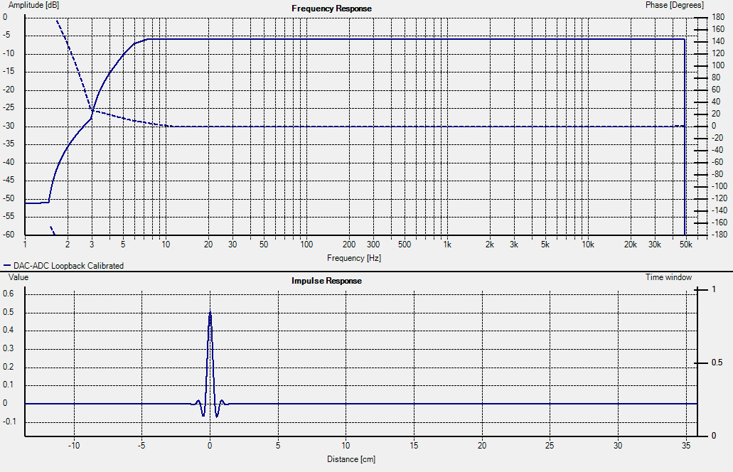

Attached is a loopback measurement of my usb focusrite 2i2 (after calibration) set at 96Khz.
Note that the attached result is VERY flat, and not all cards can be expected to be this good, however I would expect a better result than the one you have shown.
Double check all the settings for your sound card especially any for effects or eq (making sure they are off).

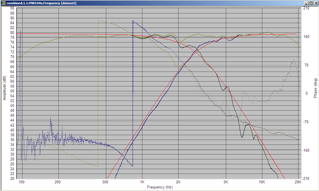

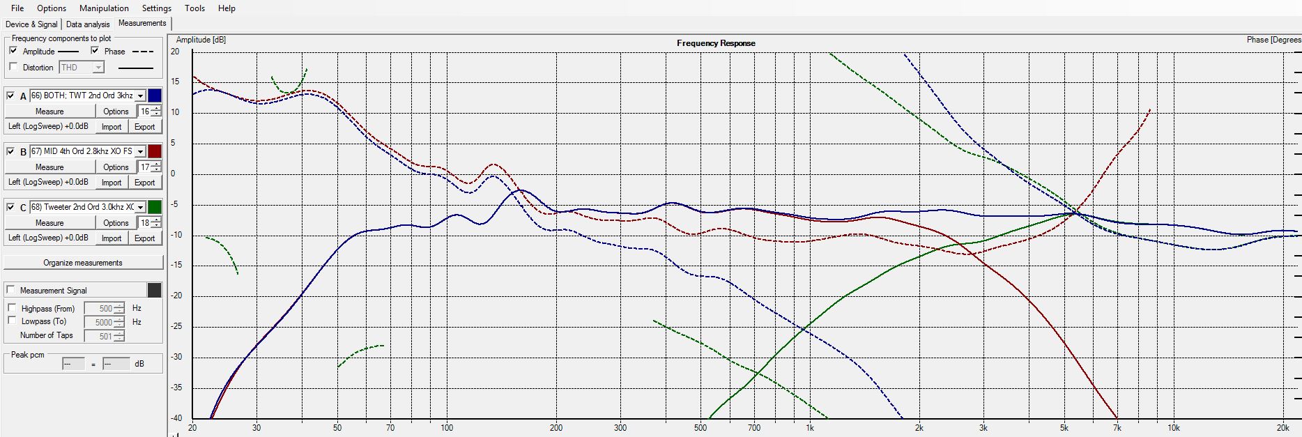

I am very rusty re the phase side of the measurement things and was hoping somebody may be able to confirm my thoughts.
The image below shows the XO setup I've just about settled on, which is a Mid/Woofer 4th Ord XO at 2.8khz & the Tweeter 2nd Ord at 3.0khz. The actual crossover point is at about 2.57khz.
It was my understanding that the phase lines should XO at 2.57khz, where mine are crossing over at about 5.35Khz. If I am correct, it means I need to add a delay that will cross the phase lines at 2.57khz.

Hi DQ828 I think that your phase looks a bit screwy. Mostly on the Mid woofer. The phase for the tweeter looks more normal...
Did you Zero lock the measurements after measuring the tweeter? For the measurements to be useful in crossover design they should include the delay (unless you are using minimum phase and putting in the driver offsets).
How you set the time zero can dramatically affect the way the phase is displayed. have a look at the attached. This is the same measurement of a 10" woofer taken outside. With two different time zero settings. This is why I think it is important to zero lock time zero after doing the tweeter measurement. That way the phase of the second driver is locked to the first so any variations are real variations. If you adjust time zero for each driver independently then there is no telling what is realistic with respect to the phase matching of the two drivers.
Note also that in the crossover region, you don't so much want the phase lines crossing each other as to be in alignment with each other, the further either side of the crossover frequency that they match up the better! Both should be sloping in the same direction more or less and be as close to each other as possible. Second attachment is an example from my MTM crossover which has a crossover frequency of around 2.8Kz.

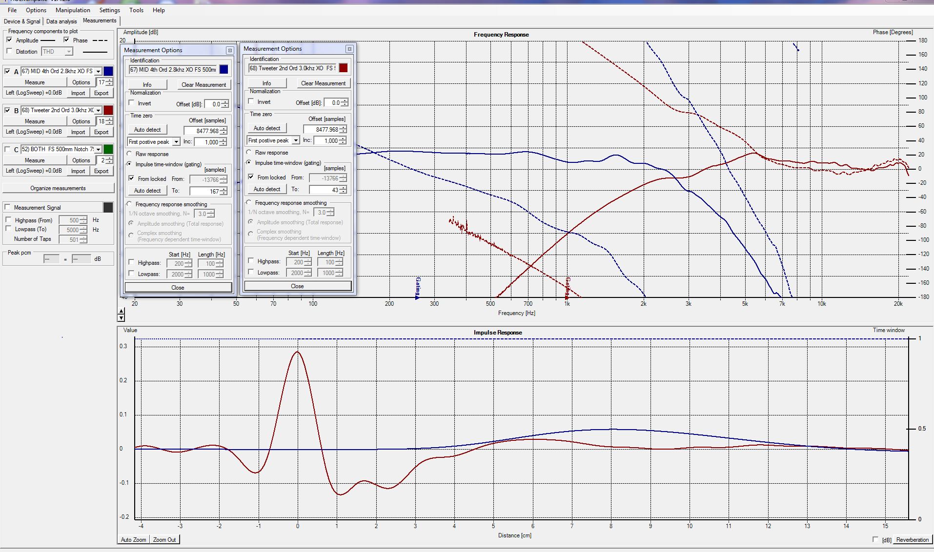

I tried measuring the tweeter first and then locking the time (Time Zero Locked) and I get what you see in the attached.
If I'm reading the data correctly the drivers are 8cm out of alignment!!!
More like 8mm in the real world.
I am using the Active Analogue filter boards from the Active Filter Board GB that was run some time ago. I have included an All Pass to delay the signal the 8mm.
Any thoughts?

What distance was the measurement taken and what axis (on axis with the tweeter?) If you work out the geometry of the triangle between the mic, tweeter and mid, would there potentially be 8cm difference between the distance between the tweeter and the mic, and the mid woofer and the mic?
Also I note that the gating on the tweeter measurement is different to the gating on the mid measurement, you should probably bring the two into alignment.
Are the measurements shown with the active filter in use? If they are can you do the measurements with the raw drivers?
