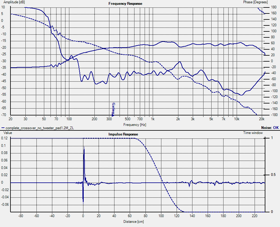

I suspect that it is background noise, ie stuff that it can't correlate back to the original signal (and harmonics thereof). It seems to be rather high in some of my measurements.
Below is the measurement of my MTM's with current crossover. The thing I found interesting with the noise is that it is highest at the 2Khz point, which co-incidently I have a major problem with my midbass drivers.... Not sure whether that means that there is some sort of 2Khz noise that is interfering with my measurements or what.....
Steve, I see no one answered your last question, though it was a while ago, I suspect maybe you were clipping your soundcard or perhaps overloading your mike or mike preamp. If your horn is a lot more sensitive than the woofer you were measuring it could explain the rather nasty plot you posted :)

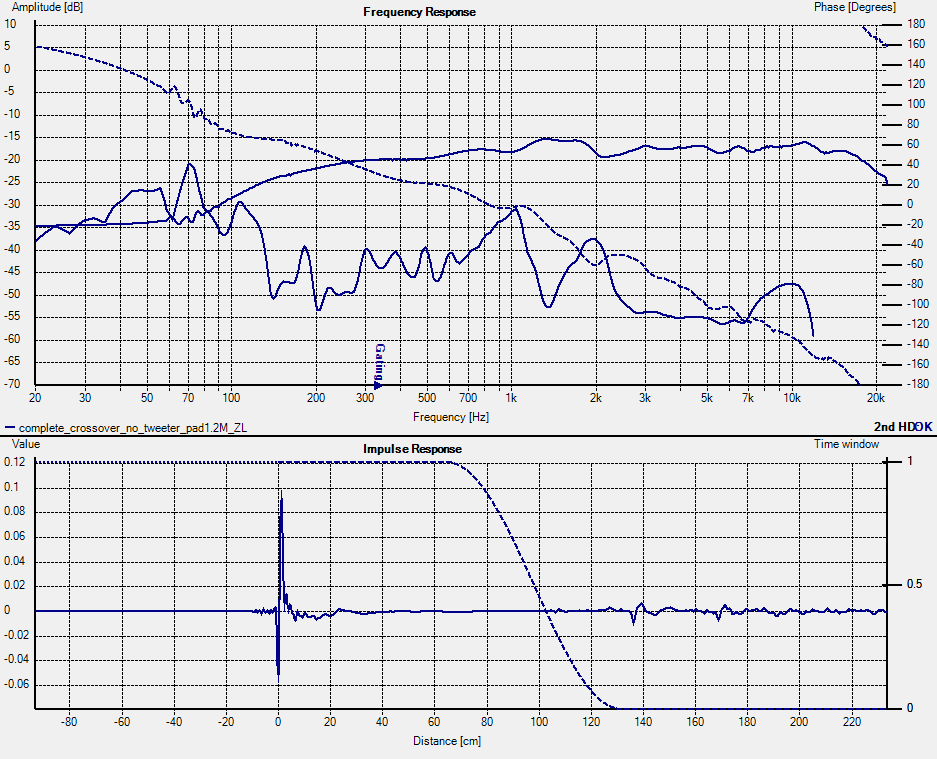

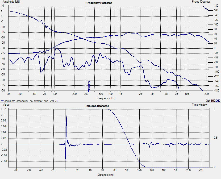

1st pic noise, 2nd pic 2nd harmonic, 3rd pic third harmonic

Speaker doctor, I realised after I posted that it wasn't obvious so edited and added the legend :) it is in the images but you really have to look closely! Note also that those measurements were done as swept sine with a starting frequency of 100Hz. Look at the noise plot (first pic) below 100Hz!!
Pano, It could be that the THD measurement is THD + noise, and if the non noise component of the THD is low enough in your loopback that the noise may be the dominant factor??
Tony.
Tony.
