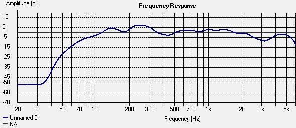

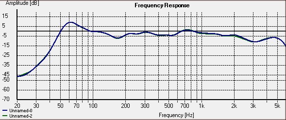

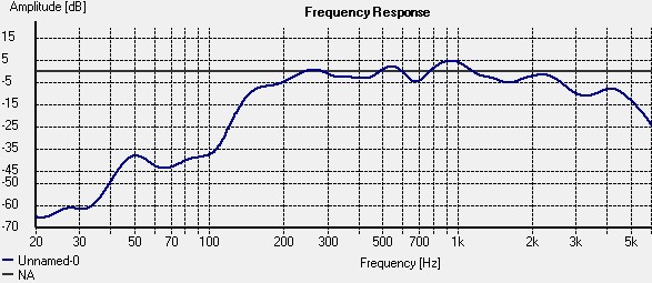

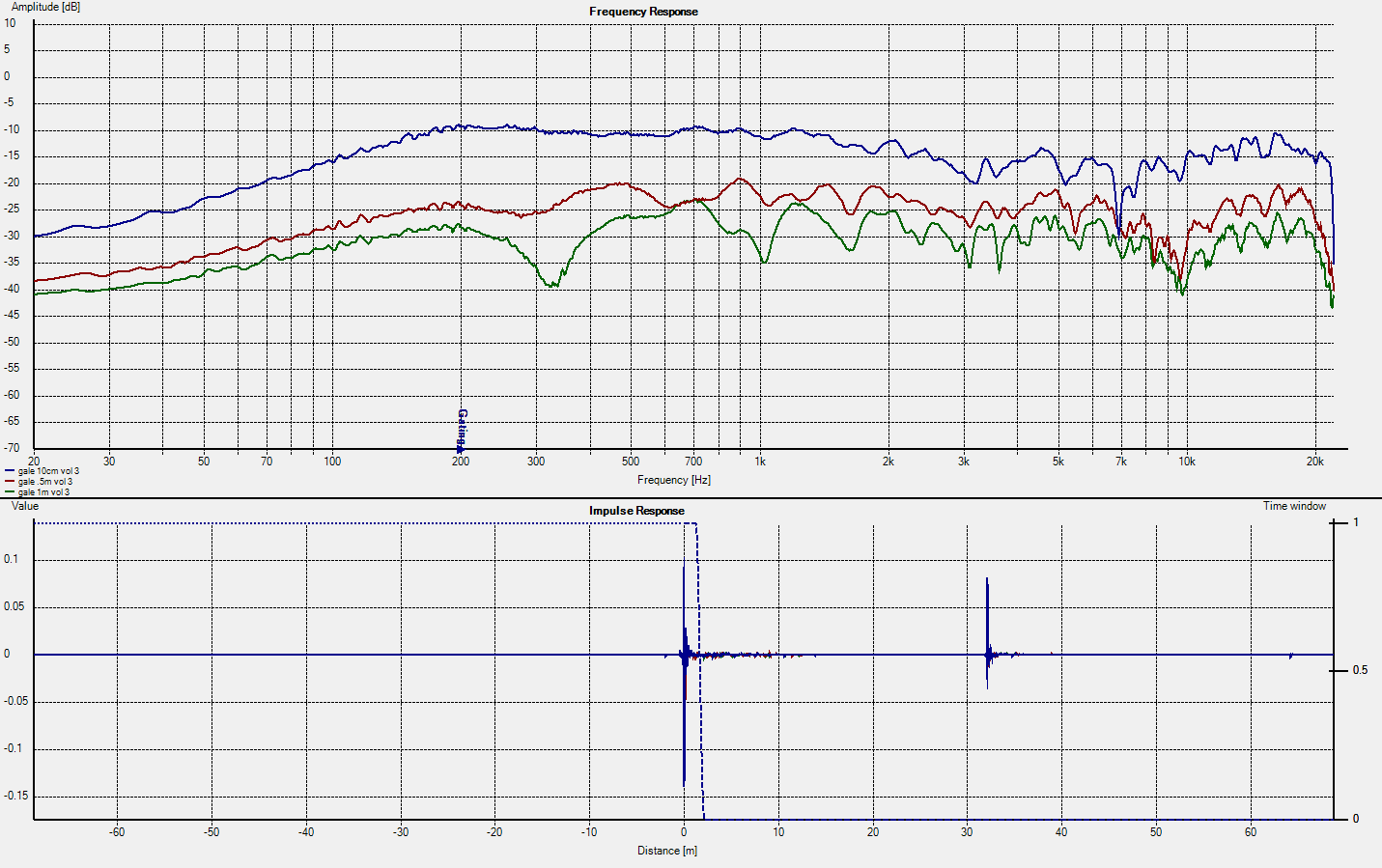

Here goes!

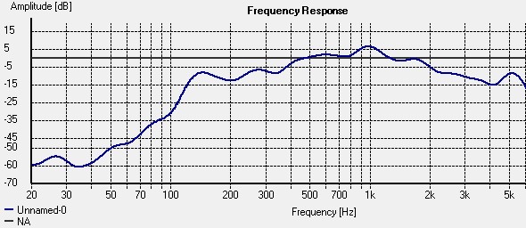

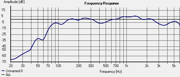

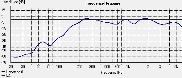

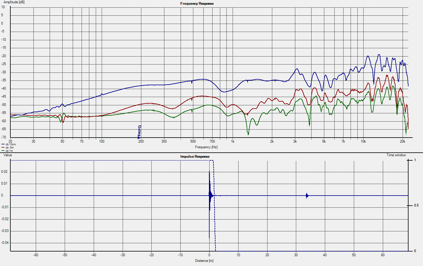

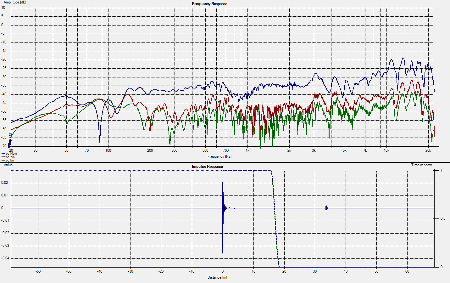

This is my first set after reading through loads of threads;
My Gale mini monitors, measured at 10cm, .5m and 1m.
Do these look sane & did i get the Panasonic mic working ok?

Yep, that works!
Hard to know if you got the mic cal right, but it doesn't look too bad. If you can do a loop measurement - soundcard out to soundcard in - and leave the mic cal ON (normally you wouldn't) then it should show up in the loop measurement. Turn it off and run another sweep and you should see a flat line.
Don't forget to set your HOLM graph size to 800x600, no need for larger.
One strange thing about your measurement, see that big second impulse at about 33 meters? That's about 96 mS. Is that a real reflection, or some sort of electrical or computer crosstalk?
Hi Pano,Yep, that works!

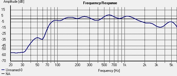

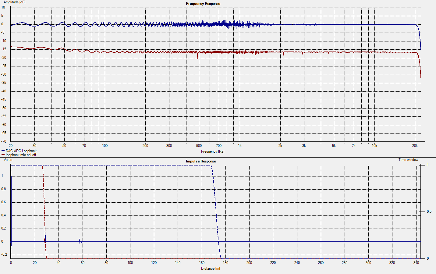

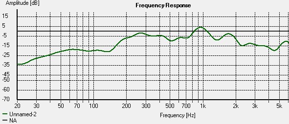

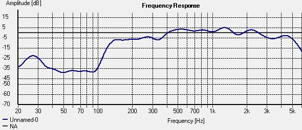

I Have done a load of measurements, including loopback & re measured the Gale speakers.
I am not sure about the 96ms impulse. I re calibrated everything and adjusted the sound card. I dont think it is a real reflection.
The room dimensions are;
Room LxWxH 410x340x190 cm approx
What do you think?
Ian

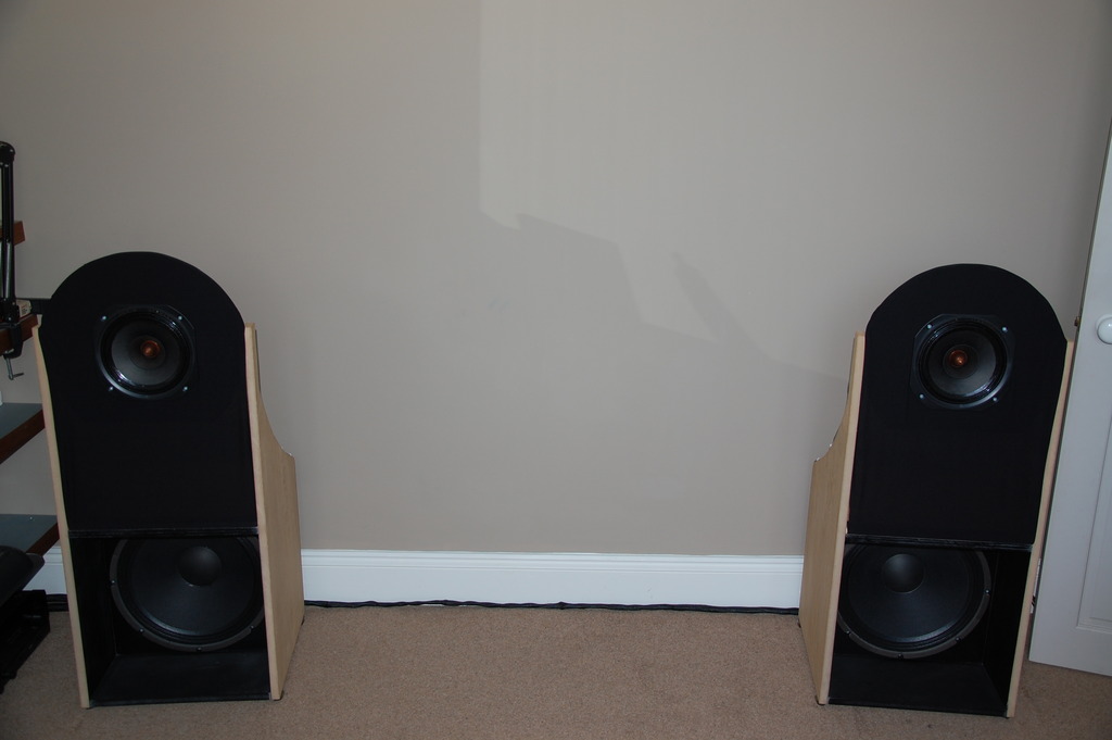

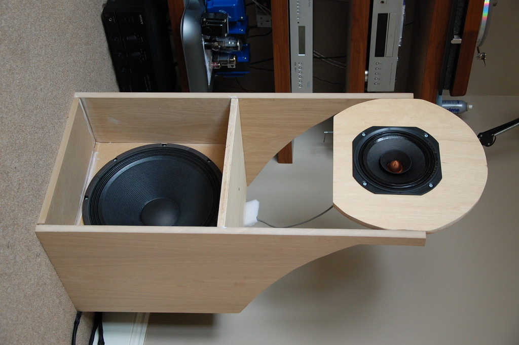

My Open baffle first measurements
Hi All / Pano,
Here are my DIY open baffle speakers;
They are Eminence Beta 15 in a 40cm sq H fame powered by a Dayton plate amp with adjustable gain &Hz - 180Hz crossover.
Above is an Audio Nirvana super 8 full range, with no crossover, driven by low powered valve amps.

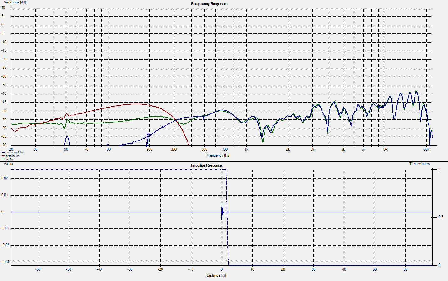

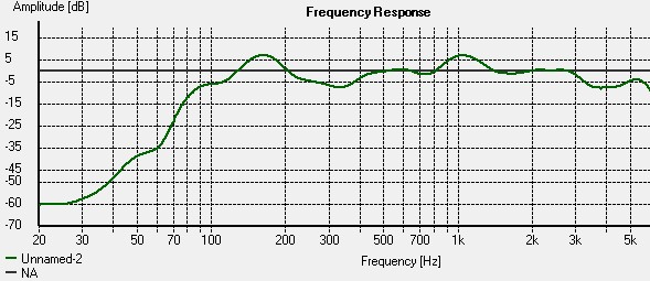

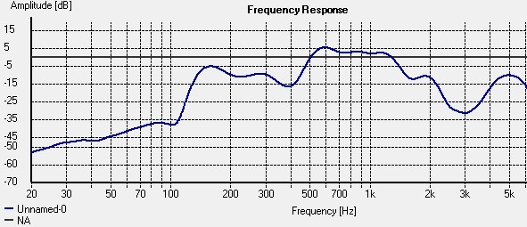

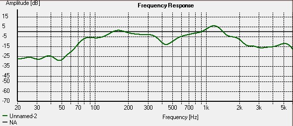

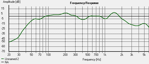

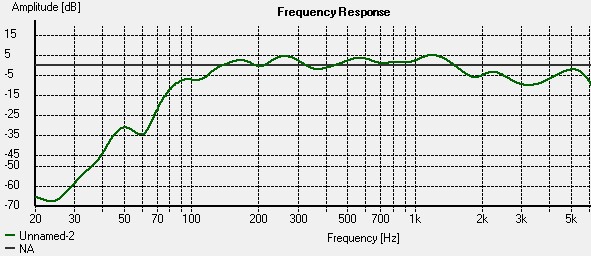

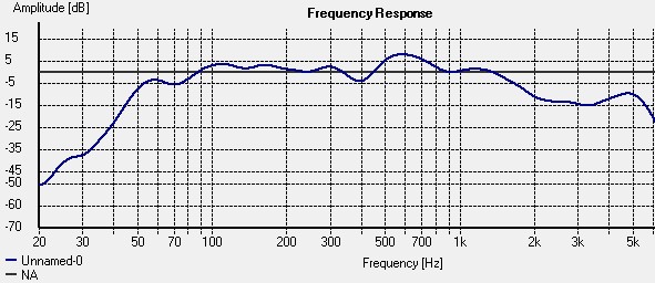

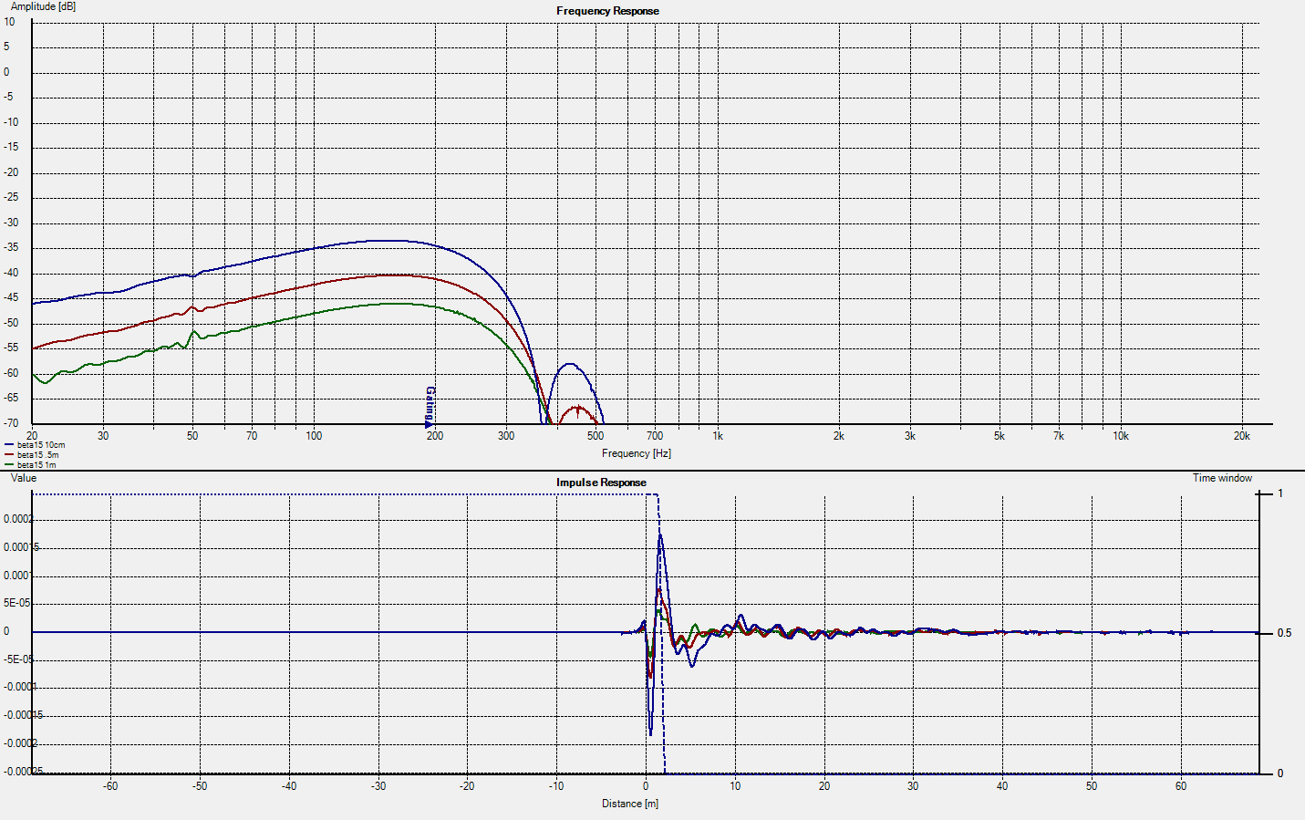

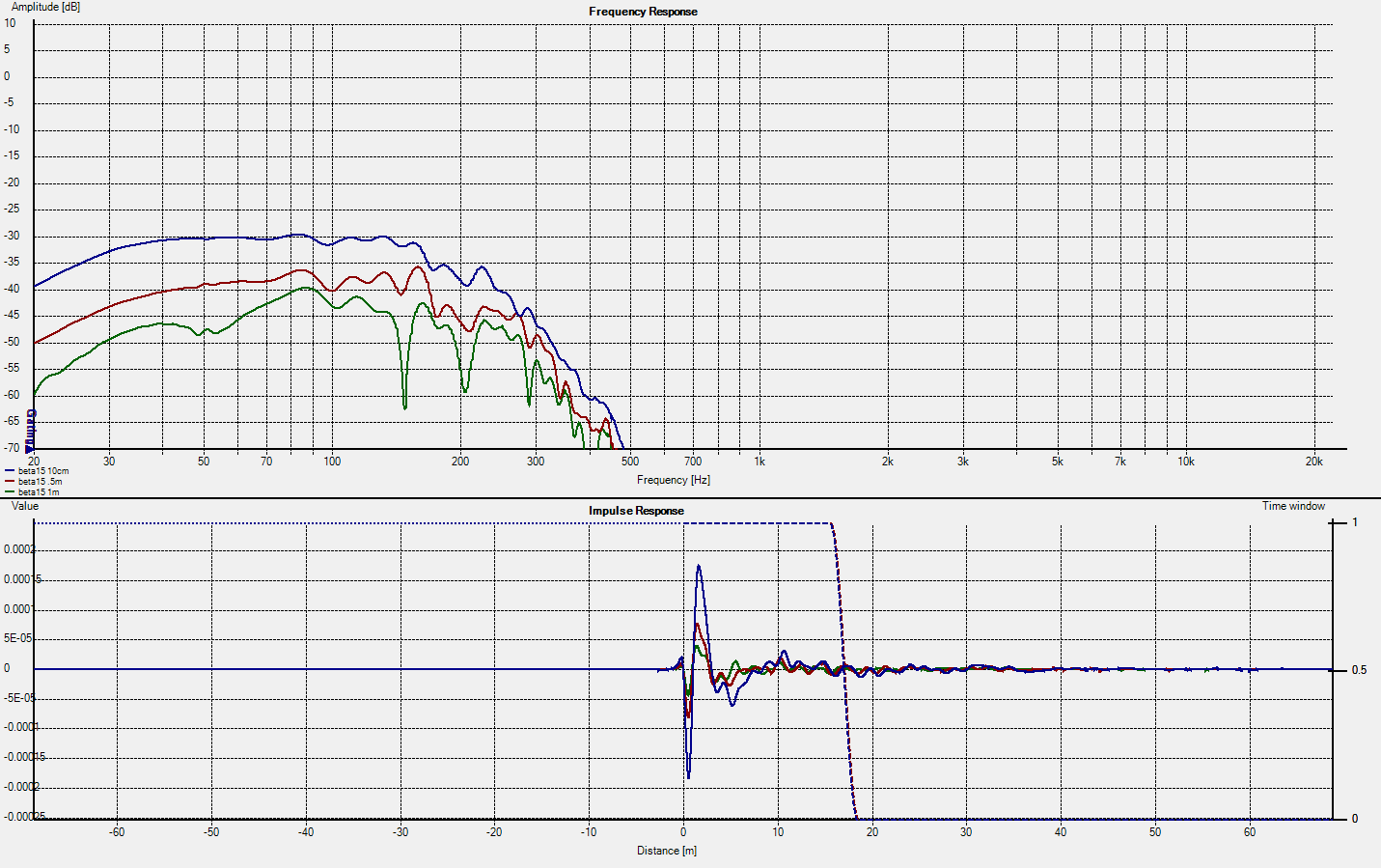

Open baffle measurements
Here are my first measurements;
Both drivers measured at 10cm, .5m, 1m distance.
But i wasn't sure how to gate the beta15, so i used 200Hz & 20Hz.

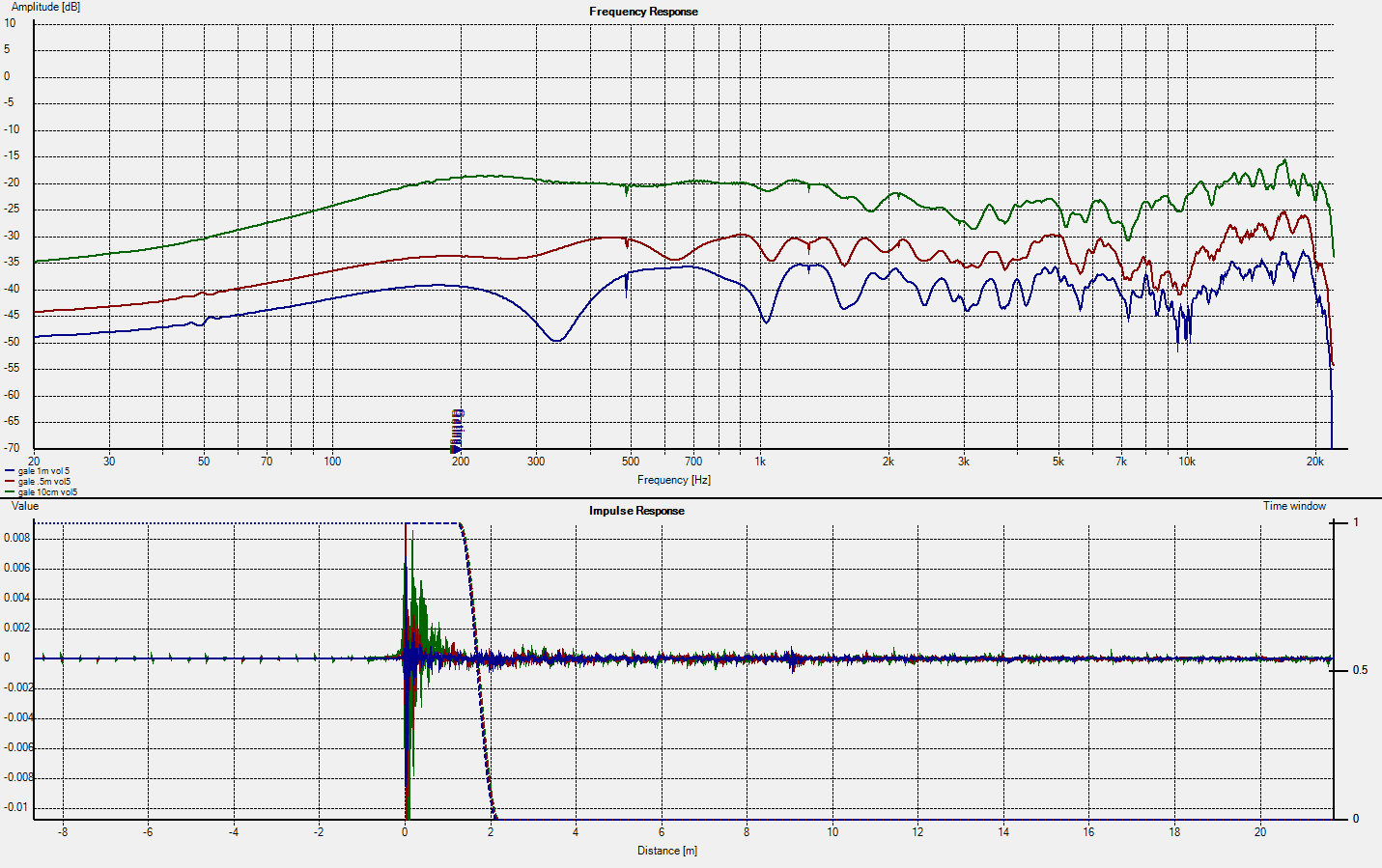

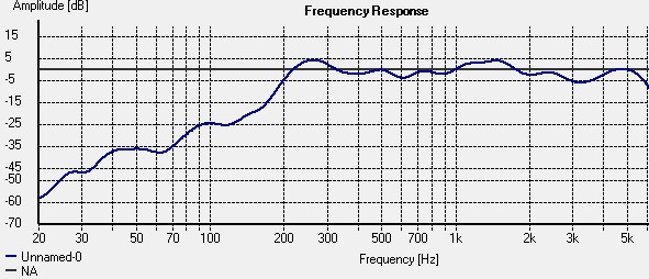

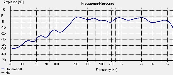

Now the combined drivers;
So now I would like some help.
I really don't know how to tune the speakers, or what to do with this data?
I can adjust the output of both amps individually, and the plate amp has a 40Hz - 180Hz filter.
Other options;
I can change the baffle of the audio nirvana super 8's, Enable them. add passive components. but i came to this design from a large rectangular baffle, and this small baffle improves the imaging / sound stage. But may be adversely effecting the frequency response?
Any suggestions please?
