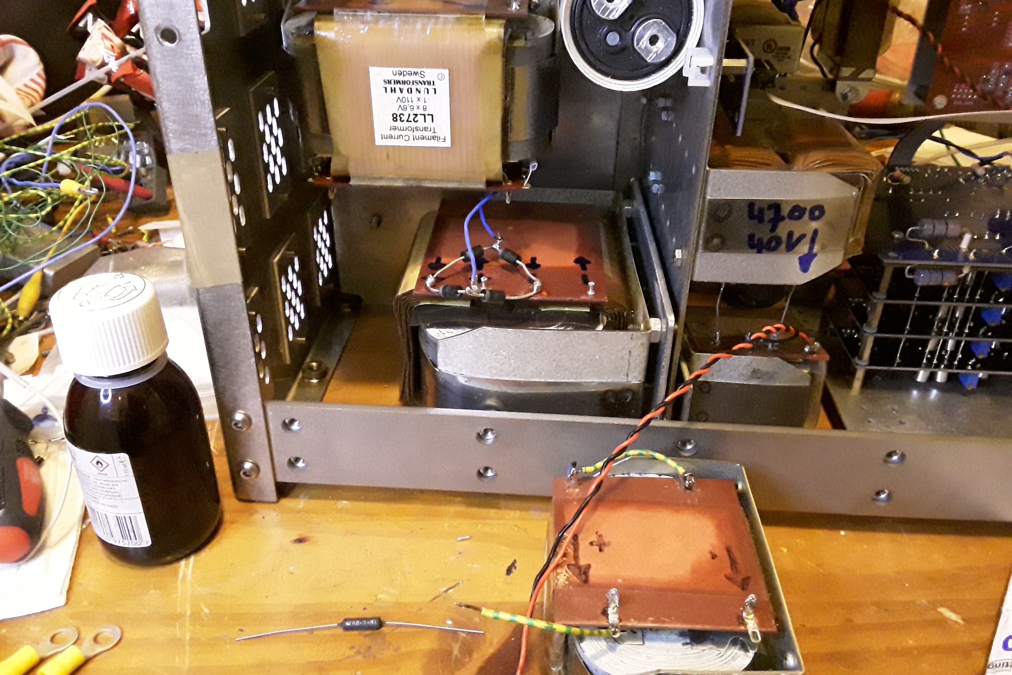

Take a good look at my choke input heater supply with Rod Coleman circuit.
You see the 4 small diodes soldered directly at the transformer. After diodes ll2733 choke input than big cap that i always use for testing then regulator circuit then vt25a tube that takes 1,25A
Because of the right choke current is 1,25A all the time so diode can be 2A model even with big cap.. temperature of diode after 4 hours 35 degrees Celsius.
Once i calculated the price for each mH for a few chokes made by Lundahl.
The ll2771 is the best. Must be used with its two coils in series to get 700mH 2A it works perfect in my friends 20 watt Hiraga ( i build it 30 years ago) with bias current 1A in each channel . For the 30 watt Hiraga you must use another one with less mH and more A
We tried the hiraga with 1,2A each side but that is to much for the ll2771.
For le monstre ll2771 is the best.
Greetings,Eduard

Hello,
This is heater supply so it has just plus and gnd. The Lundahl does have two coils.
Lundahls tells us in their datasheet then you can use one coil on the LL2733 on the plus side and the other coil in the GND side.
I case of our power amps you need to put these 2 coils in parallel ( there is only one way to do it correct , see the pdf) and put that in the +rail and then another LL2771 with 2 coils parallel in the min rail.
My friend in Vietnam uses LL2733 400mH 1,7A in the single rail supply of his single ended Nelson Pass design the same way like i use it in my heater supply. And for the other channel he uses another LL2733
At that time the LL2771 was not available yet. I took the LL2733 fromm the Netherlands all the way to Vietnam.
The LL2771 gives more return on investment. If you order it in Estonia they will send it tax free. If you order plus 300 euro no shipping cost but you can ask my Brazilian friend about that. He decided to buy a choke for a tube amp to so now for 30 $ more he has free shipping and an extra choke.

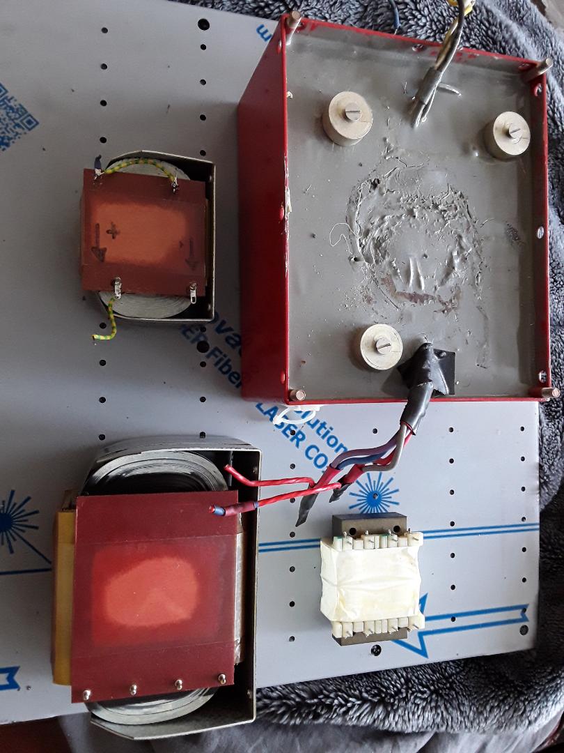

In one photo you see my DDDAC 1A continuous current and tiny diodes.
In other photo:
Big R core with LL2733 choke input for my DDDAC
New smaller but big enough and LL2771 choke input for DDDAC much better.
The R core is now used in my friends 20 watt Hiraga CLC supply also with ll2771
Greetings, Eduard

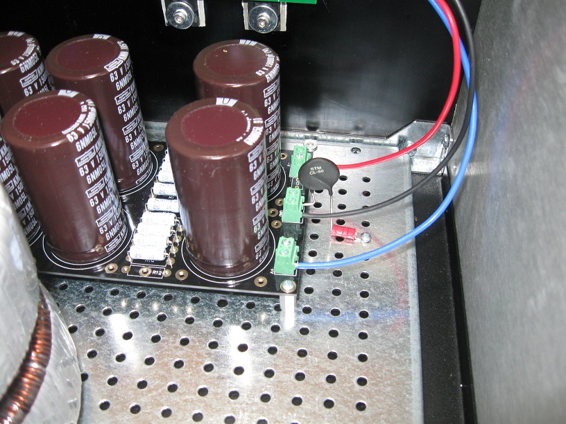

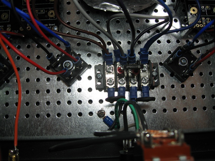

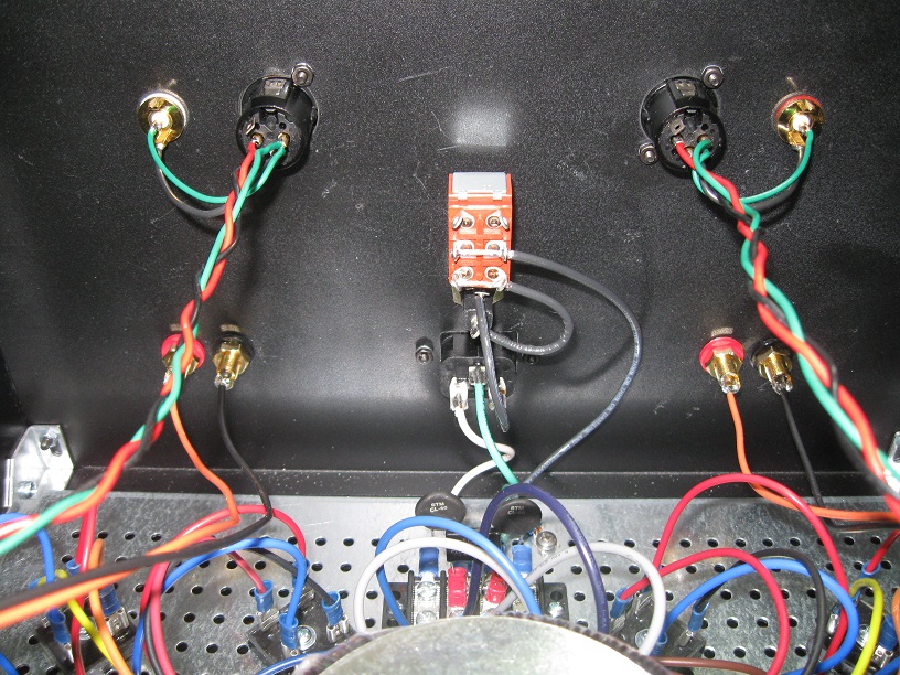

I posted the pictures below in May 2013 after I finished building my Aleph J clone. The first two show the middle connection from the AC inlet directly to the chassis (safety ground or earth) using a piece of green wire.
The third picture shows how the PSU board ground (audio ground) is connected to the chassis using a NTC thermistor.
For more details on my Aleph J clone build follow the link https://www.diyaudio.com/forums/pass-labs/224881-aleph-universal-mounting-spec-31.html#post3481260
Hello,
Some people say dont use it BUT for safety it is best to connect the safety ground or earth directly to the chassis after the power cable has entered the chassis. I think there are even some regulation on how to do it. If i am right one is that you cannot use this connection for anything else.
Do it like Grimberg has shown us.
LONG LONG time ago there was a Nelson Pass design that used a 10 ohm resistor to prevent a ground loop from appearing.
In the link i posted a week ago there are some advices you can use.
Jean Hiraga himself wrote that with big caps and a circuit with low PSRR even the smallest change of '' strategy '' could make a big difference.
