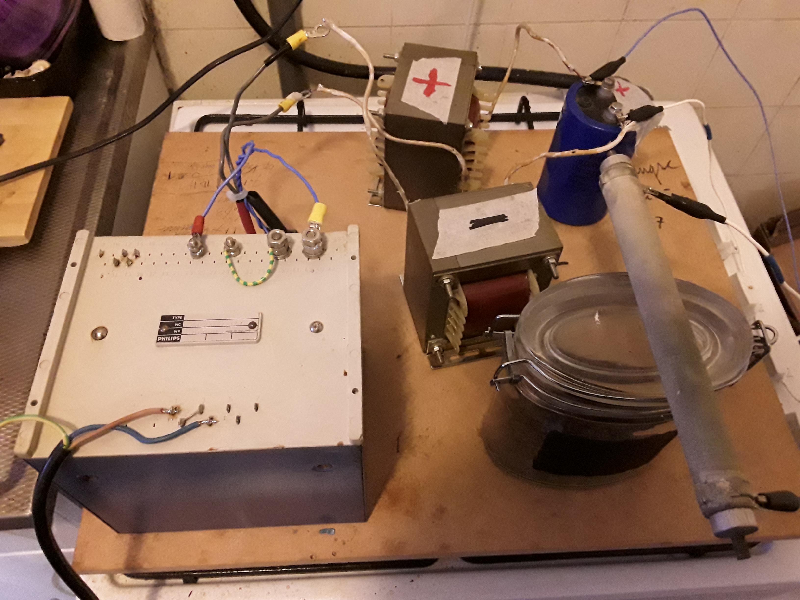

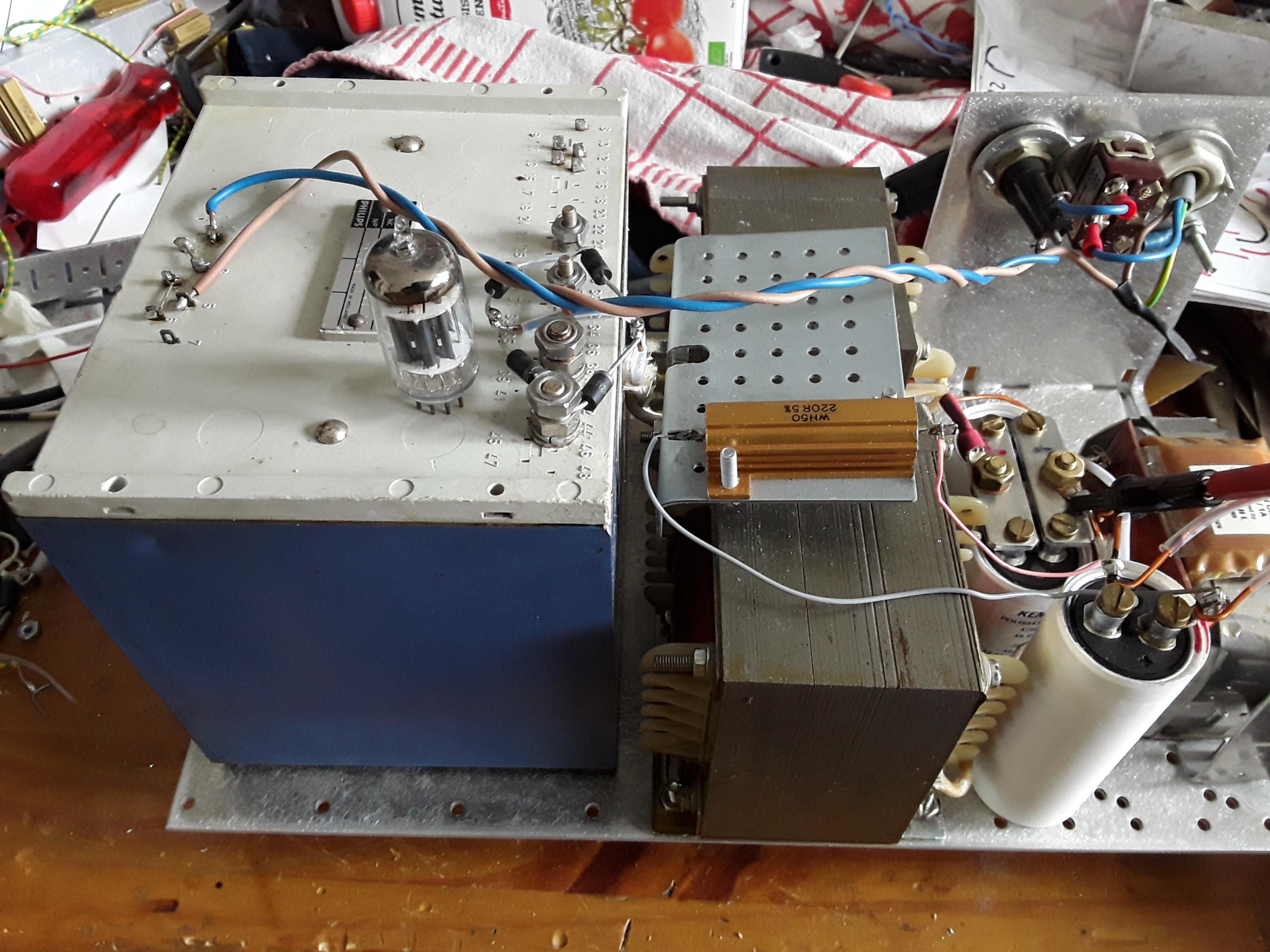

Will be absent untill 26 October. In the photo a choke input power supply used in my 2.1 audio set up for watching movies.
Cheap Philips lab. Quality power transformer.
SMALL high grade 3A diodes ( winner audio lineair test) No need for high currents diodes because of choke input no pulsating currents.
Input choke from Belgian member on this site. One in each leg.
Bleeder resistor.
Second smaller lundahl choke and some Kemet caps.
Greetings,Eduard

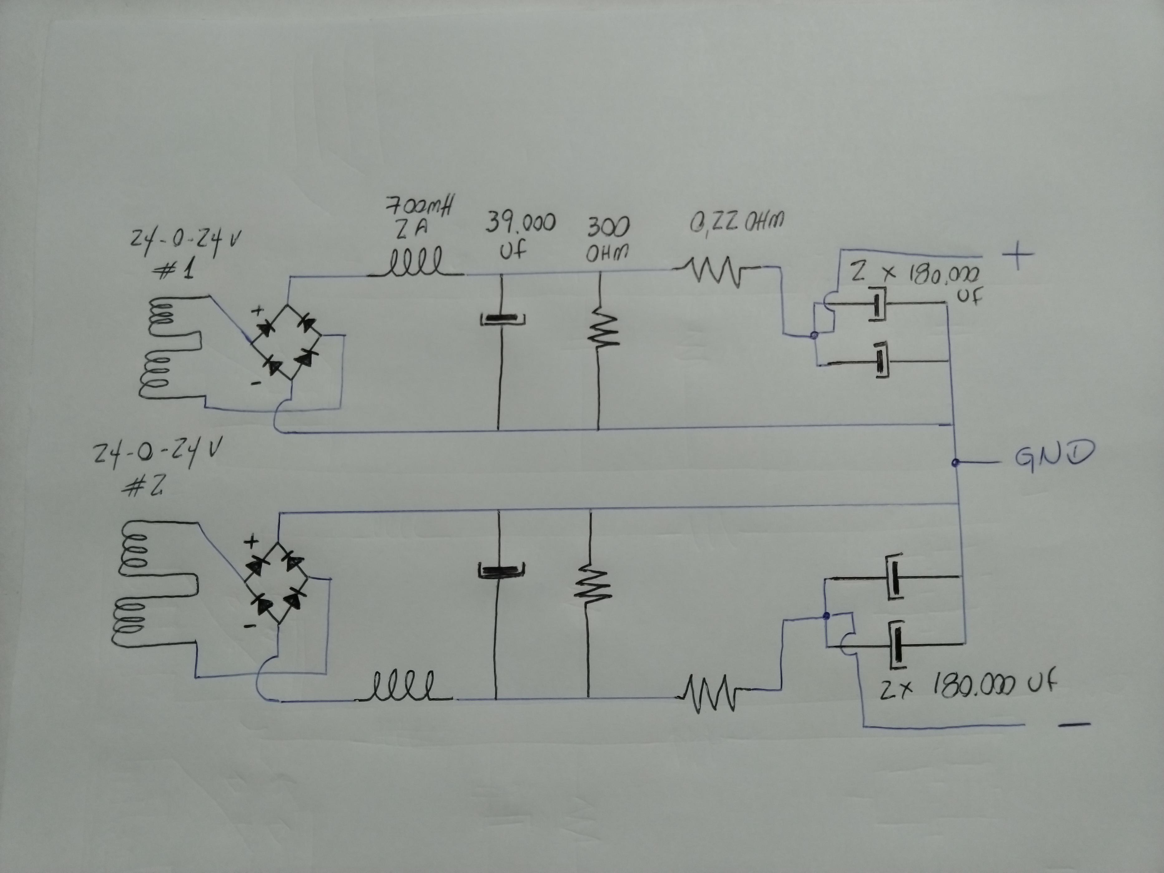

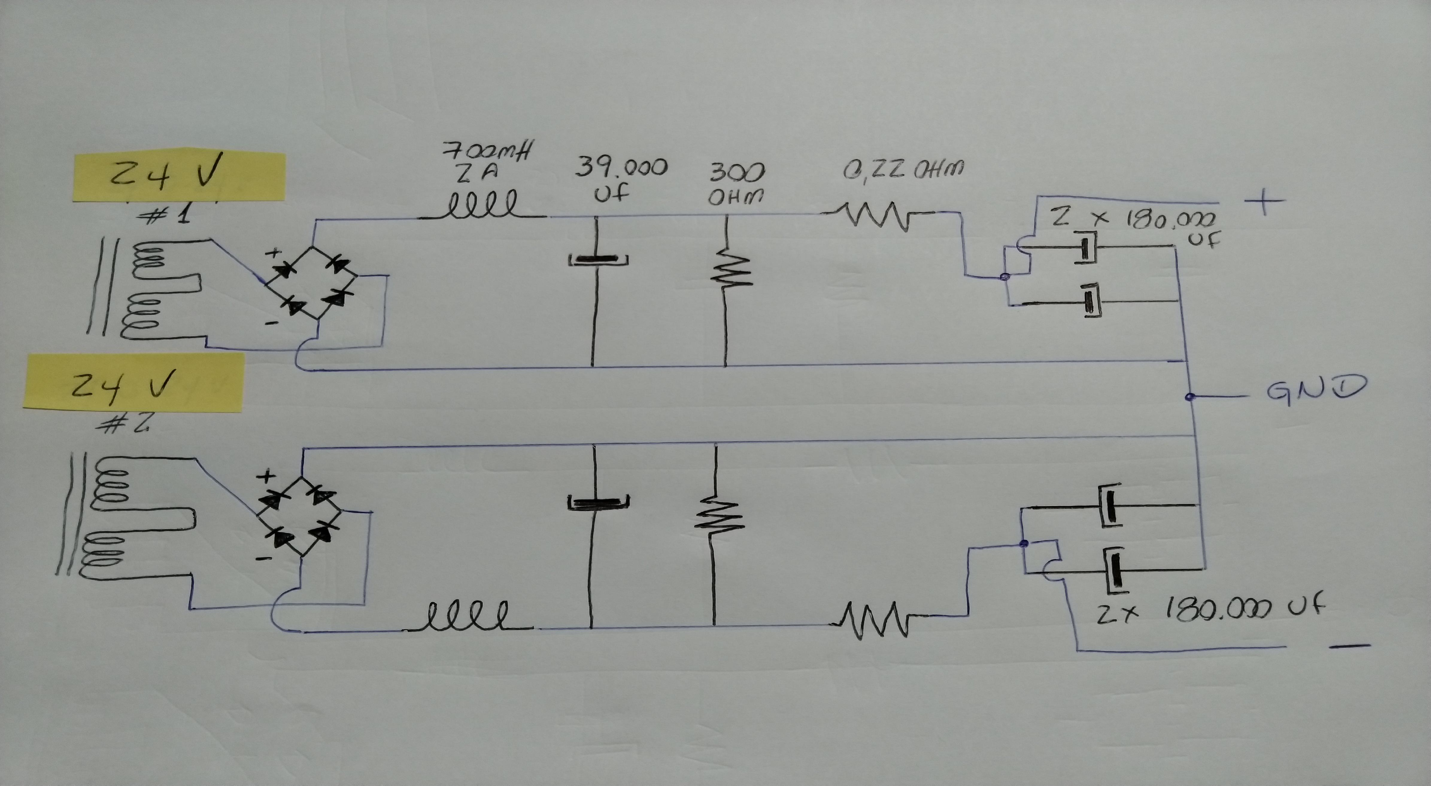

Hi there,
Im a newbie going to build a Le Monstre amp as my very first diy project (I've been thinking about this amplifier for at least 10 years ...)
According to mr Eduard convictions and his earlier demonstrations on this forum; and after watching so many youtube videos that demonstrate advantages of the choke input power supply in reducing ripple compared to RC or CLC fiters, I decided to go with a dual choke input power supply for my Le Monstre.
As I have no experience on this business, I kindly would like to have some help from experienced Diyaudio members on how to build this power supply. I make a very amateur drawing inspired in some old Le Monstre power supplies, and would like to be sure that Im in the right way.
Since I hope not to drop the energy in the neighborhood, as well as not electrocute myself before listening to the amplifier ... lol ... I will really appreciate the comments and corrections of the attached diagram.

@Nilton your drawing is correct.
BUT what is very important is to realize is that the hard work is done by transformer, rectifier, choke and first cap( with 300ohm attached).
Probably it will be possible to connect the bridge directly to the transformer AC terminals ( it could need a little heatsink but i am have been running a 3A sbyv in choke input with 1A current for a year now) Probably you can touch your bigger rectifier without any heatsink!)
So the first elements working hard you should keep the wires between them as short as possible. 2 inches is better than 6 inches.

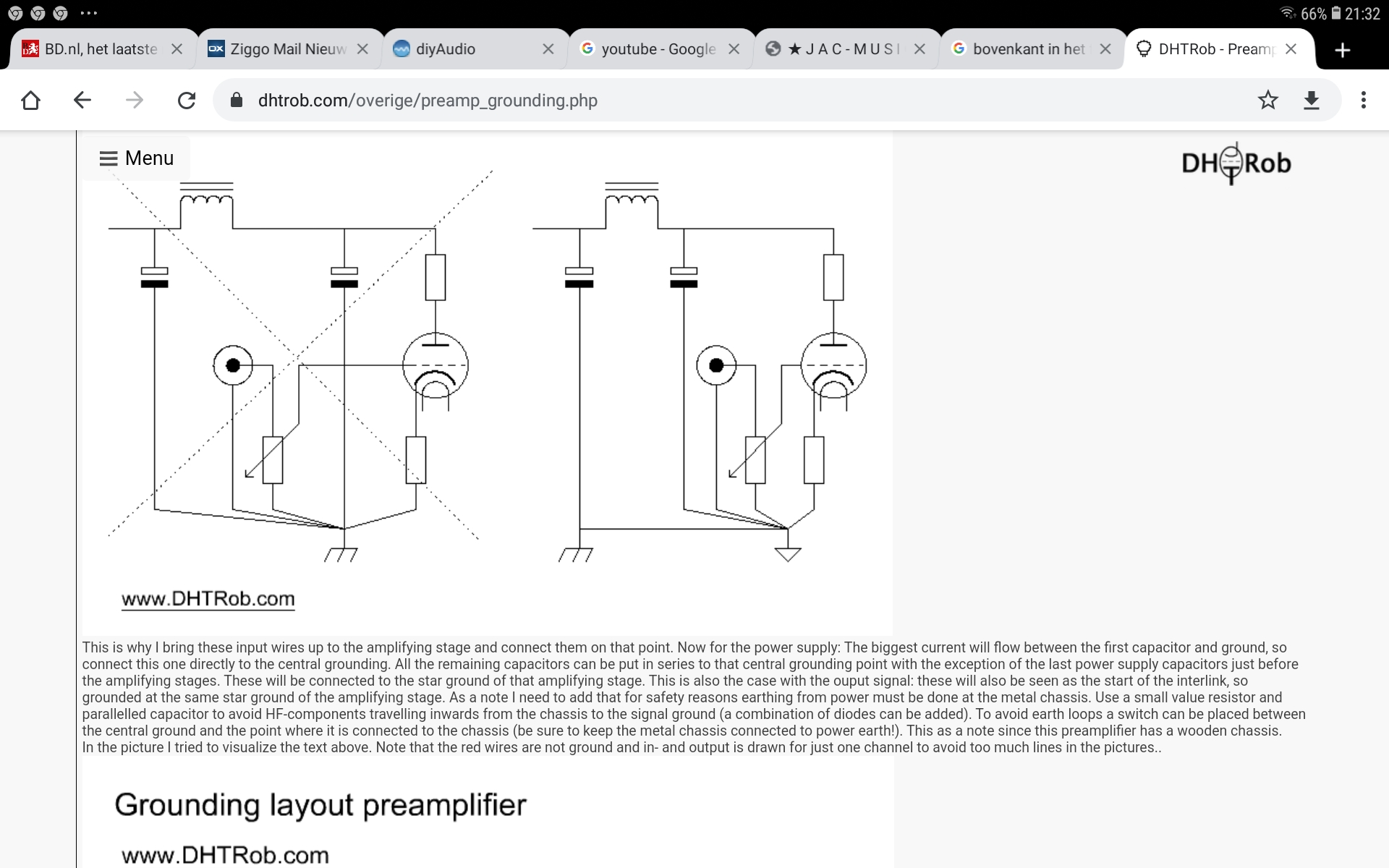

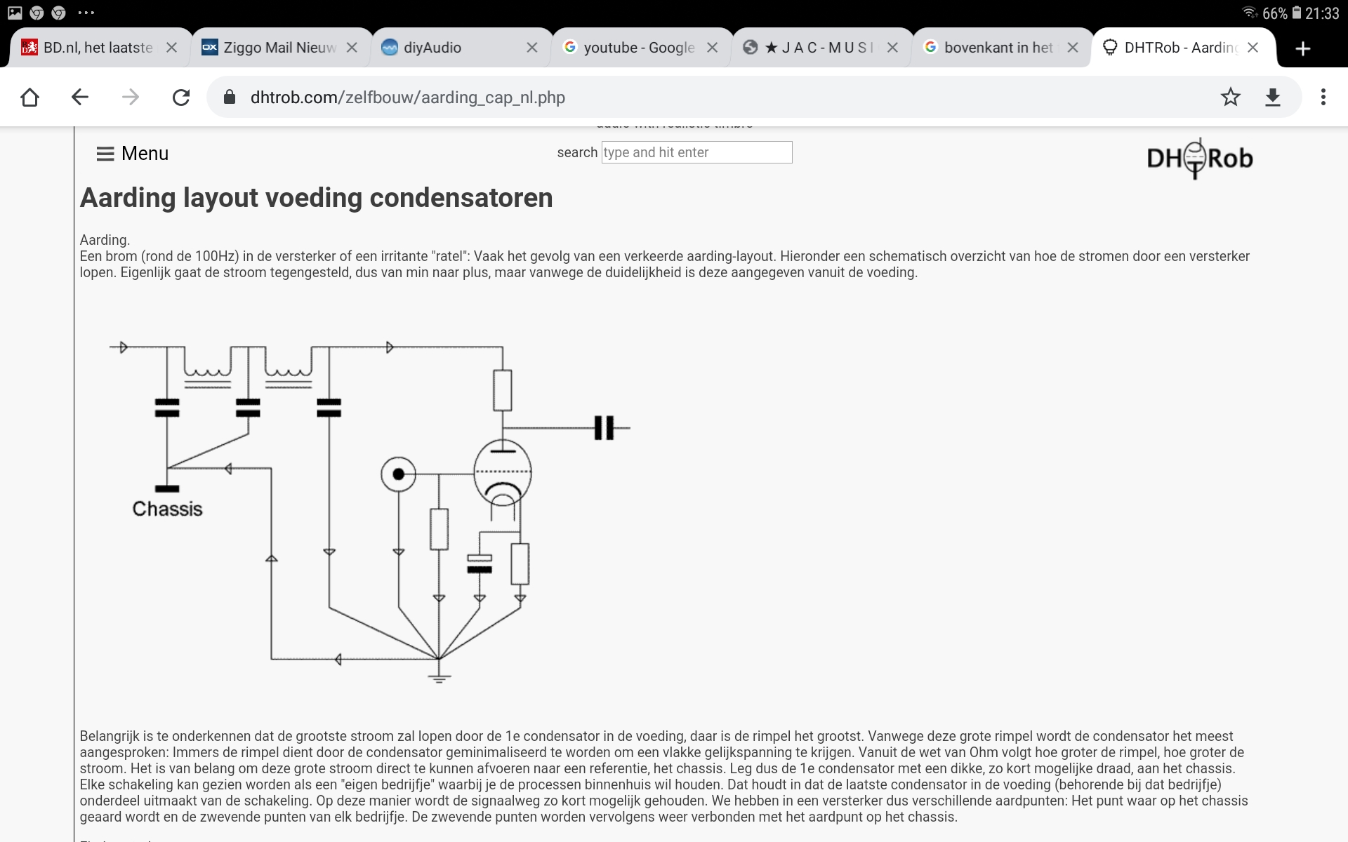

Take a look at the two attachments. It is a single rail supply but the ideas are the same.
With the Hiraga design current running is bigger so the way to connect can be even more important. Connecting the caps with copper bars is nice. BUT you have to know where to connect the wires to these bars. It has been said before with copies from Hiraga article but people still do it wrong.
Same like using a 1000VA transformer , a big rectifier and then a few beer can caps. Sure, you can get a rectifier that will survive but it will result in big , very big charging pulses that will end up messing up your sound. That is why they start using a CRC or CLC filter . Here you can carefully chose the seize of the first cap. ( my friends 20 watt Hiraga uses 47.000uF)
WITH choke input there will be no charging pulses.
In this link there is some useful info.
http://hifisonix.com/wordpress/wp-content/uploads/2019/02/Ground-Loops.pdf

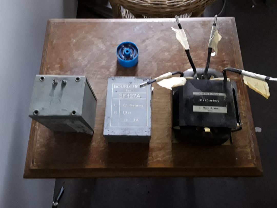

Hello ,
In the photo you can see my French chokes they are made for DC as indicated.
The blue one is used used in a power supply filter on the 230 volt side.
The big one is an R core 20 mH with double wiring same function like the blue one but for BIG current. If i remember well i used it once for choke input and it got hot. So it was surely saturating.
Maybe you can make a simple test set up in a CLC configuration. Then make a load with a high power resistor so there will be 1A or so going through the choke. Then you can calculate the dc resistance of the choke.
If it is 0,5 ohm you can make another set up.
One RC with a 0,5 ohm resistor and 1A current as load.
One LC with 1A current as load.
If LC is working like a choke input the voltage on the cap will be much lower.
Because the voltage is lower the high power resistor much be lower in value to get 1A running too. Then voltage will drop a little more.
A 500.000 uF after the rectifier even with choke input is to big i think. Better get something like 47000uF and make it LCRC R something like 0,2.....0,5 ohm.
Would be nice to have your chokes checked for mH at the actual current you are using.
Once i had a 68.000 uF 25 volt input cap go BAD after a year of use with 24 volts dc. Remember the input cap must work hard so better have a bigger safety margin. The last caps '' feeding '' the circuit can be 15 volt if the actual voltage is 12 volt BUT if one of the circuit go bad and you will not have as much voltage drop across the choke or the resistor it can go boom. A good cap will have a kind of safety '' opening '' so it will not explode but start to make a ssssss noise, like a water kettle.
That is why, my Brazilian friend Nilton uses a 300 ohm resistor to be sure there is a minimum current running ALL the time. If you know the mH value you can calculate the value that resistor needs to be.
Caps nowadays arent that expensive anymore and they have gotten much smaller. I like the Kemet caps Nilton is using.
Greetings, Eduard
