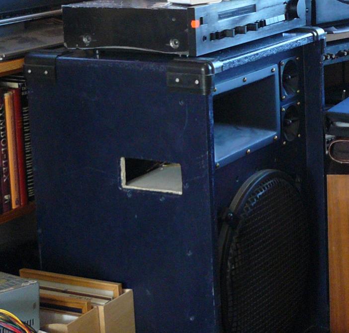

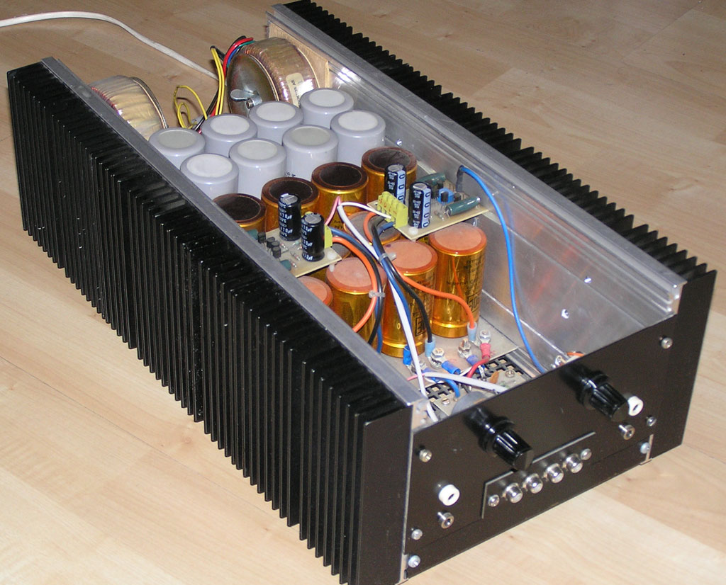

I build the Hiraga 8W class A amplifier some 30 years ago using the original parts. At that time the power transistors I received were already surface viped to hide the part numbers!
It still sounds really good having more than enough power for normal listening. I even used it at parties together with some home made JBL based PA speakers.
A few more pictures from the project are found on this Norwegian forum.
PCB close-up:
Simple solutions also work! PCB was made with ink pen...
Amplifier chassis using an old main frame power supply:
Party speakers:

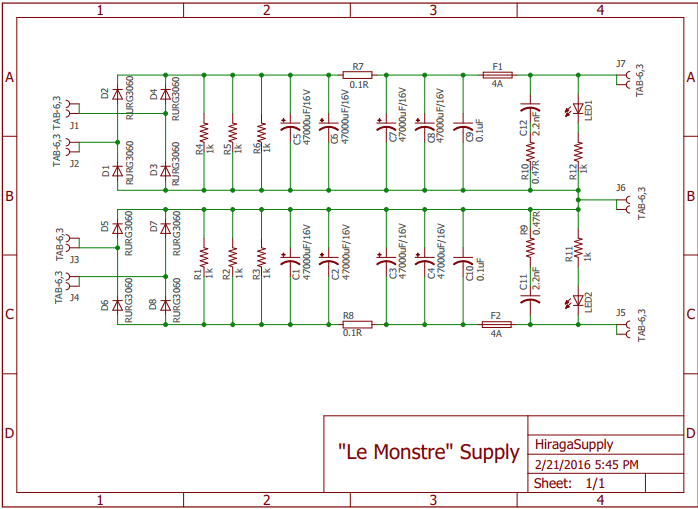

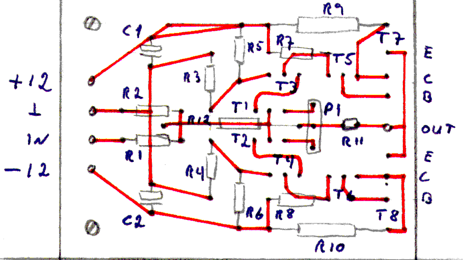

First Build of the le monstre, power supply ideas?

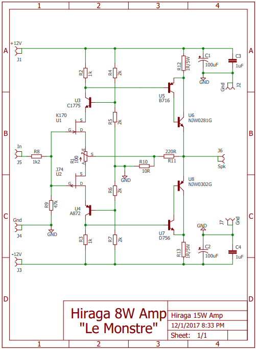

Hi to all my DIY Hiraga family out there! I decided to build this amplifier as it is popular and there are many kits available, plus it's not too expensive to build.
Please see attached schematics.
So far i have bought 16x25v@47000uf capacitors, i also have two toroidal transformers 160va 2x12v 6.67A.
I have a few questions about the power capabilities of this amplifier, now i know it runs at 12V and i know that probably after rectification and going thought the capacitors the voltage will increase, so what i want to know is . will this be ok? Can these amp boards take the high voltage? If not what would you suggest i change in terms of components to handle the extra voltages? Or will it be ok?
I'm not fussed if it's 8w or 15w, i just want to learn how to set it all up i.e the bias and to get it sounding as good as i can with what i have.
Would i need a soft start and speaker protection modules? I will be building the chassis and heatsinks myself!
Any tips would be greatly appreciated.

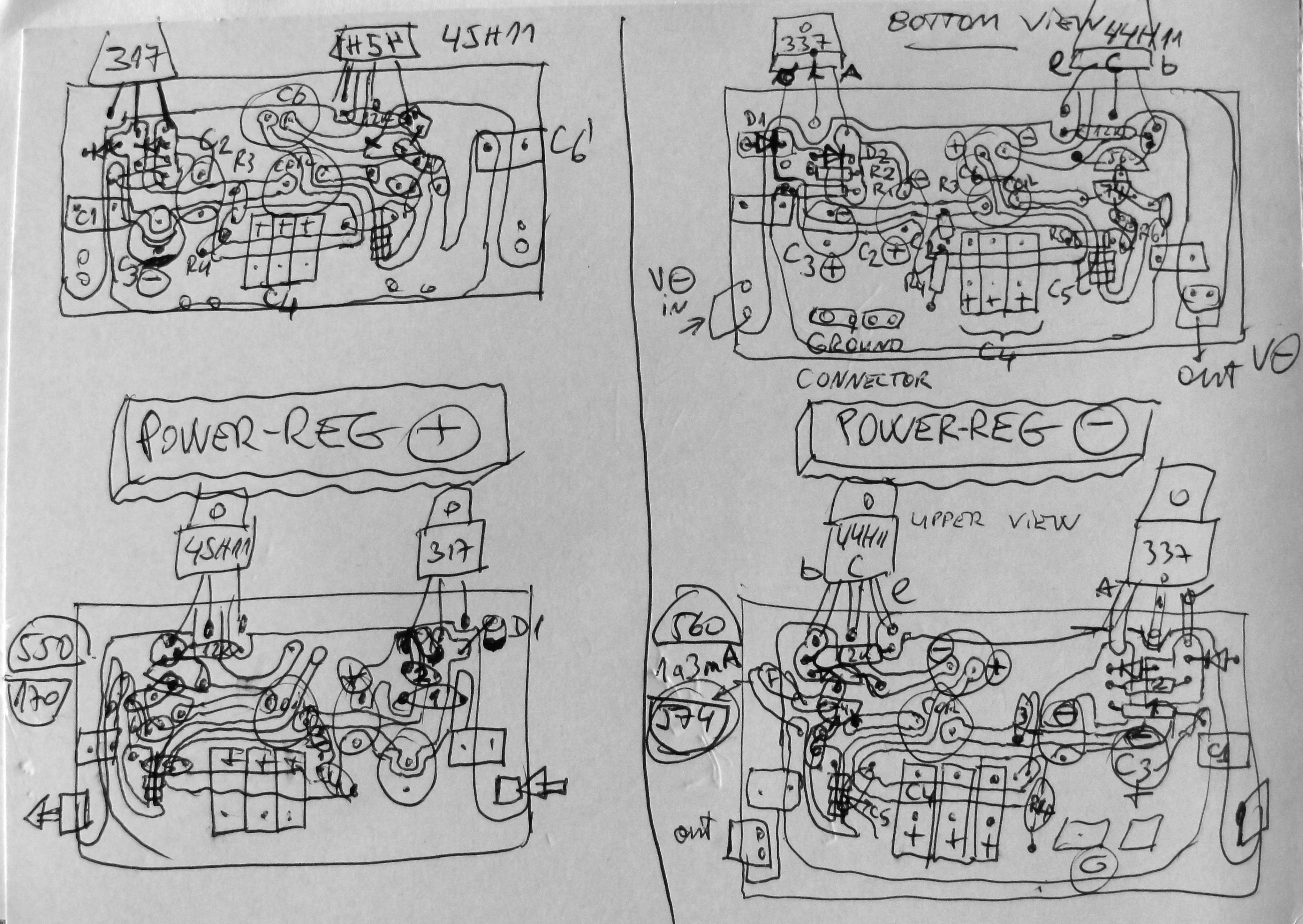

If I were to build this famous amp my Aquarius ascendant would force me to introduce some mods:
1) Choose higher power rails, anything from +/- 15VDC to +/-24VDC.
2) Use Power Regulator (in my case the PowerReg from Teddy Pardo) to save money on power caps. Of course, I would also use my other PS secret weapon: the "charge-transfer supply" from -ECdesigns-
Introducing the PowerReg | pink fish media
3) Cascode also the outputs with BJT. Given the higher power rails, no loss on headroom.
4) For the ultimate sound quality: do a cascoded common-source VFET output, but that would need another higher power rail for the bias.
At the moment I am totally busy with multiple projects but this one is in my "to do" list.
Best of lucks.

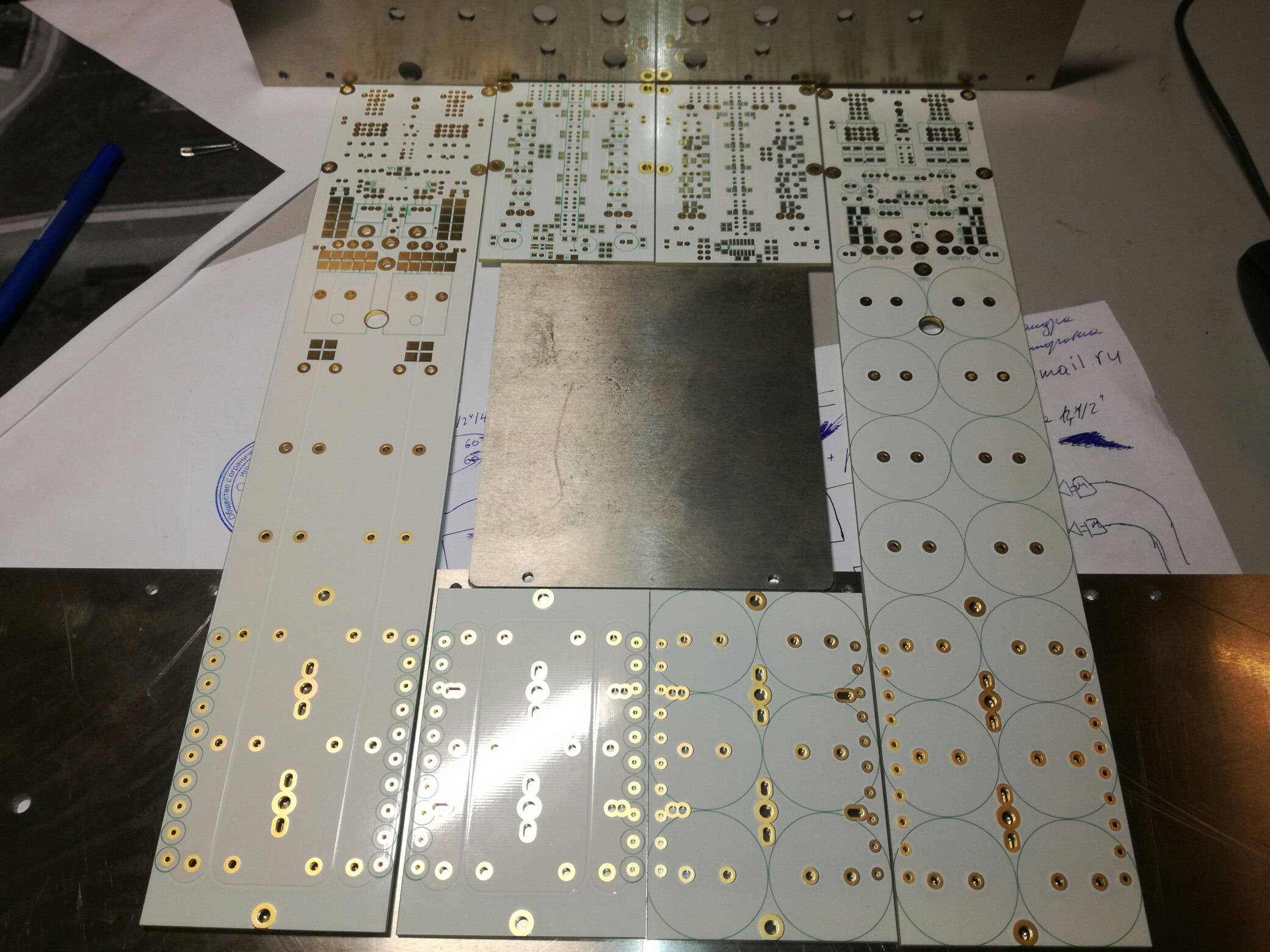

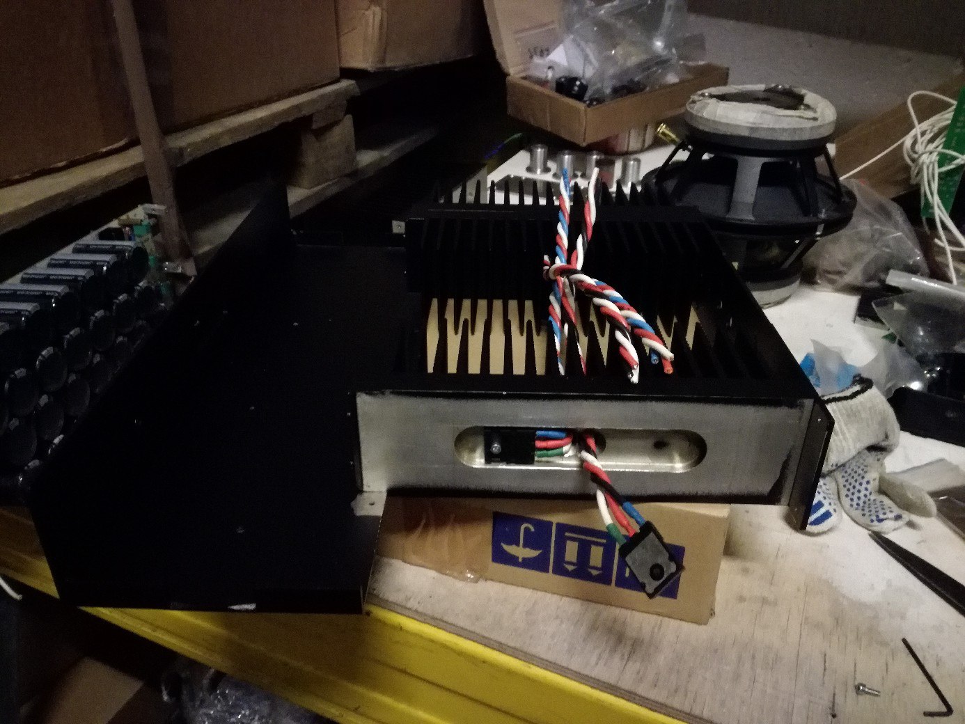

Here is my built. Enclosure work done by me. All PCB's purchased as a kit.
Here is the link of my drive folder in which i have stored all the built photos, might help someone to get ideas to built an enclosure.
Le Monstre - Google Drive
Sadik
Sadik

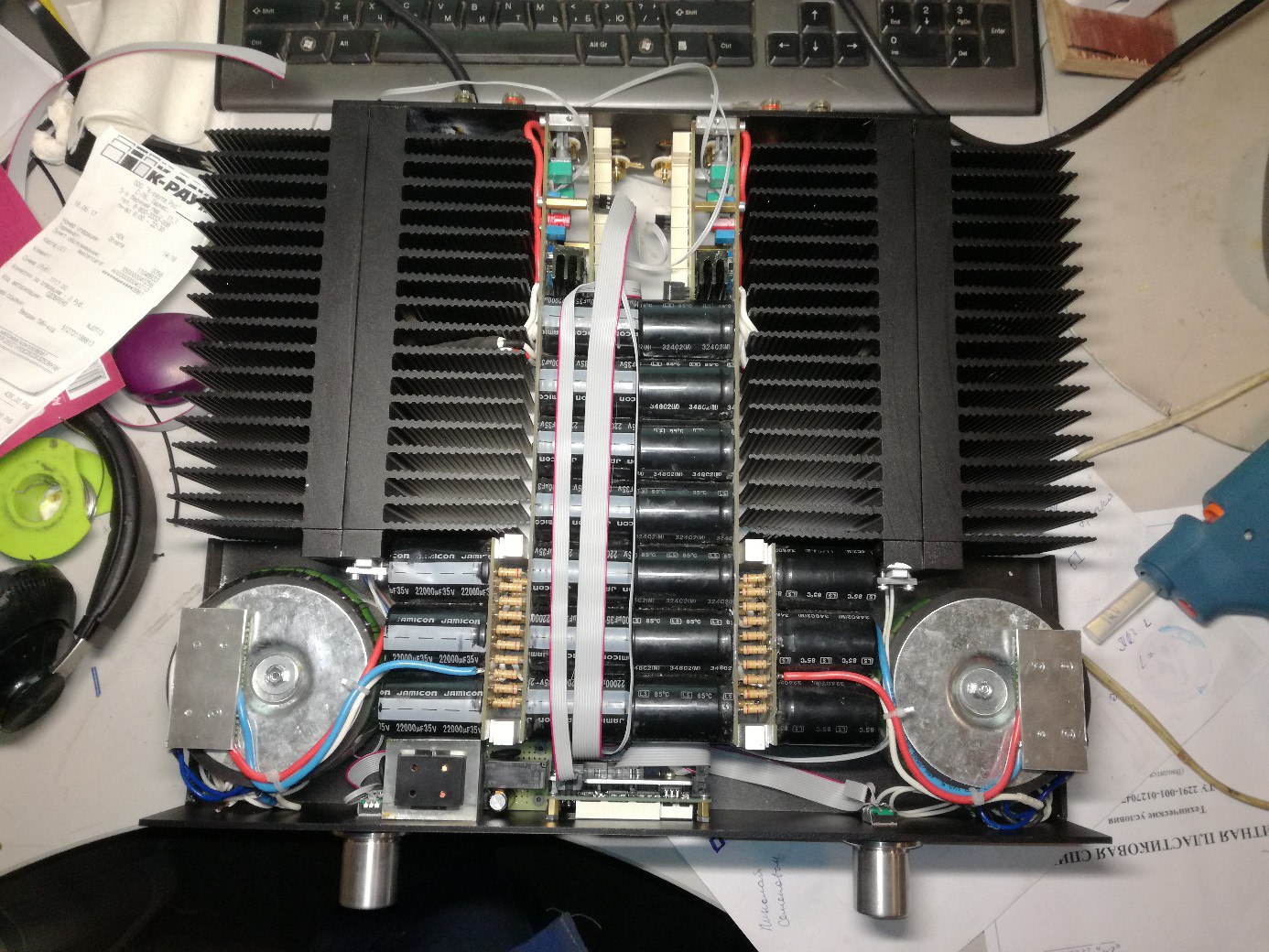

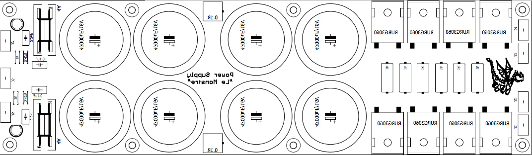

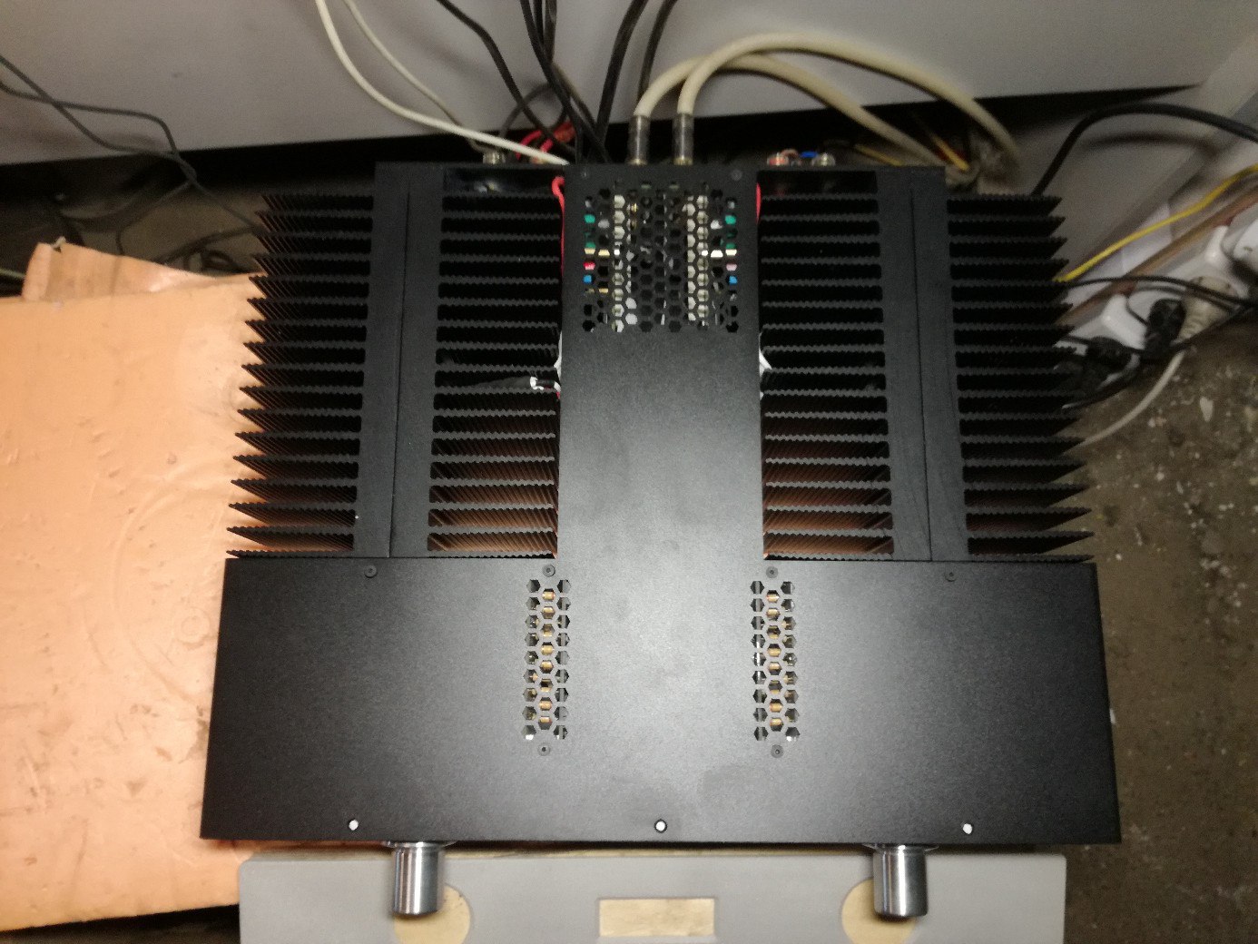

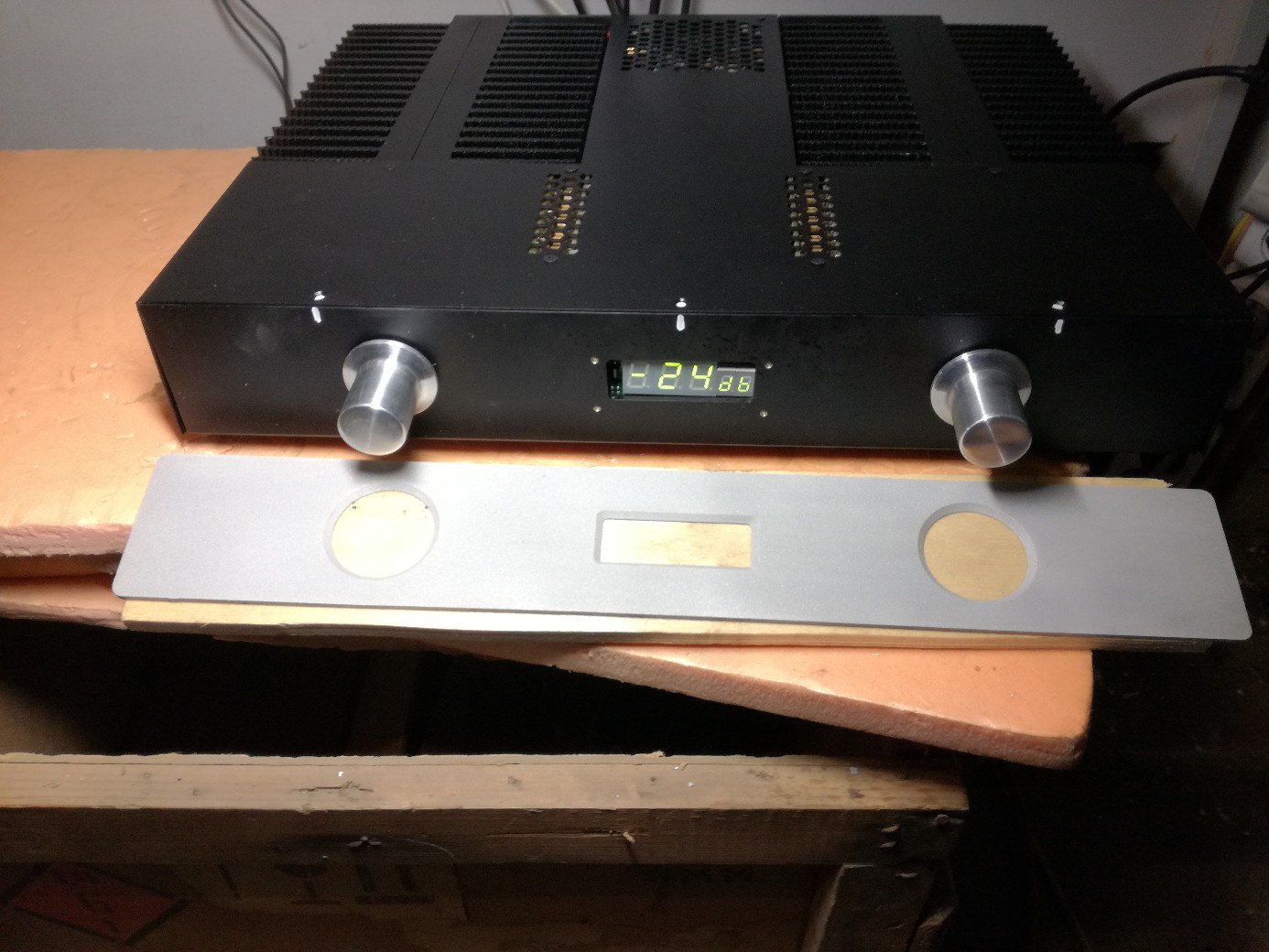

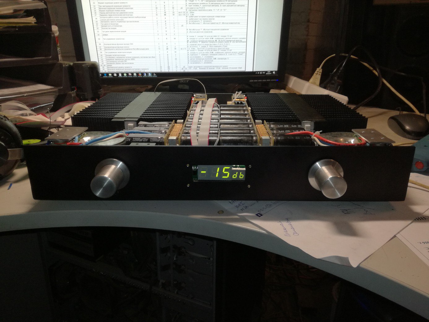

Here is my built. Enclosure work done by me. All PCB's purchased as a kit. <snip>
Nice built !
One question: you seem to have Capacitance multipliers for PSU which also appears to include rectifier diodes. This is nice to have all on the same pcb. Do you have more information on this Pcb!
Thanks in advance
