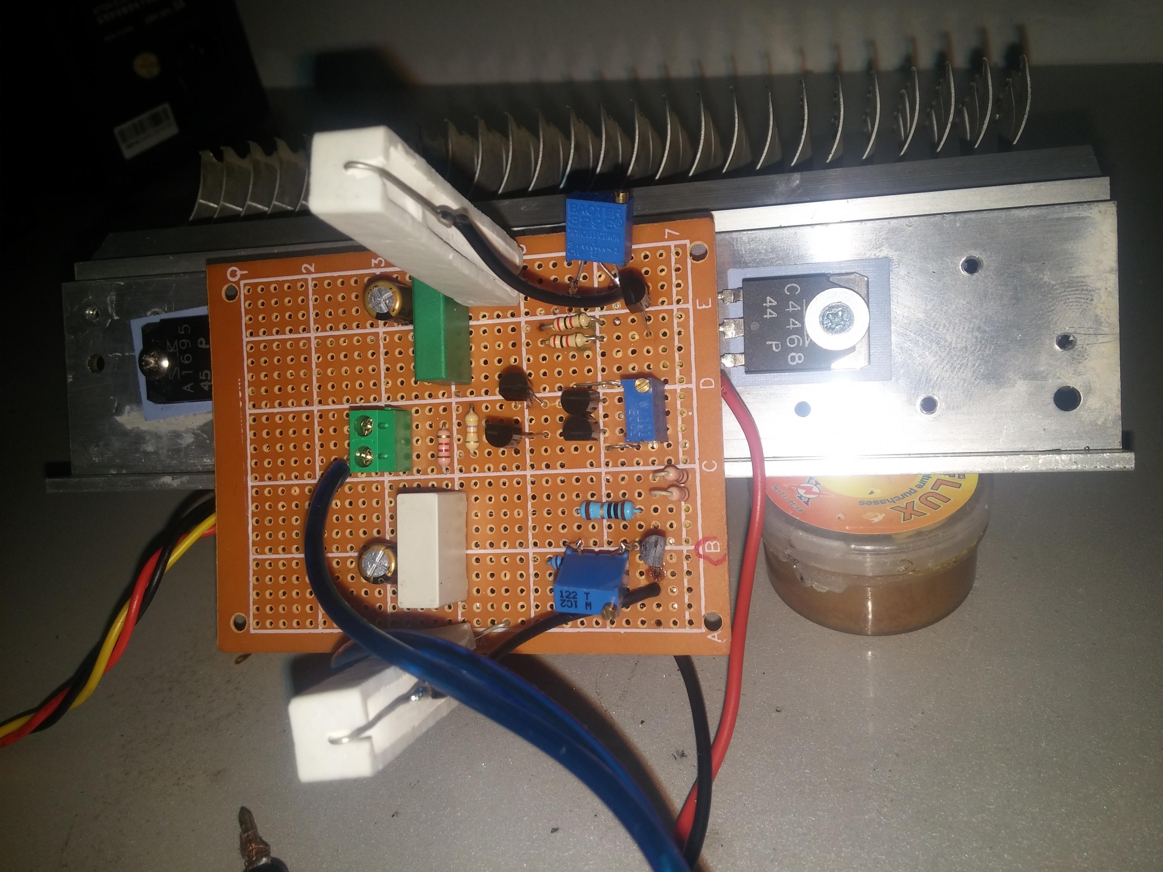

Thank You again Sadik your answers are very helpfull. Yess you are right about image , but on pcb I do not have problem with shorted circuit on pad of 0.33R . I checked dc ofset and it were good but when I played with trimm potentiometer I burned my speaker (not big damage because it was experimental speaker) however your advice about bias and that how to setup it, is very helpfull and I hope that it will solve my problems. Now I need to find another speaker and than I will try to setup bias.
Dear All,
can somebody help me to check this Hiraga 30w board? Thank you
Hi file1,
pl dont mind my frank comments.
1. the layout is not upto the mark, in class A with o/p transitors side by side, unless you keep the amp in at 0 deg C with forced cooling, i see no reason why they shouldnt overheat and burn!.
2. a very good observation by sadik. I see that the C and E of o/p transistor shorted or very near to short, as clearance appears to be less than 1-2 mils. the general manufacturers specify atleast 6-10mil clearances min.
3. high current traces are quite thin.
4. it appears that you have not used DRC feature of eagle, to check for min clearances and dimension to pad/trace clearance.
5. many traces are unnecessarily long.
It would need a whole revamp to make it acceptable.
sorry if that is negative comment, but just wanted to point out few things.
reg
Prasi
Hmm I appreciate all review's . Sadik please could you send me your pcb's on e-mail?
The idea for o/p transistors is to be connected by wire , not directly from PCB board.
C and E are not shorted , but I will check this again. Clearance is bigger in reality , but not more than 3mm , I will reconsider to repair that.
