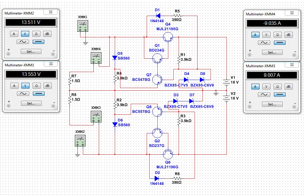

Thanks guys for the input. I went through quite a few schematics of different SS brand like Krell, Bryston, Aragon, Leach, Apex...........The only one that even have a clipping diode to avoid saturation is by Bonsai here. Nobody else even do anything and let it stick when clip.
There is no easy way to avoid clipping, I put in the diode just like Bonsai. I use the darlington VAS, so I just put the diode between the base and collector of the darlingtor to prevent the transistor from saturating. BUT the capacitance of the diode becomes part of the Miller feedback capacitance. The capacitance of the diode change with reverse particular when output getting close to the rail. So you do create a new problem when trying to solve another problem.
I looked at this Hiraga schematic. If you look at the top composite output transistor, the PNP U$5 can still saturate. So really how do you judge the clipping?

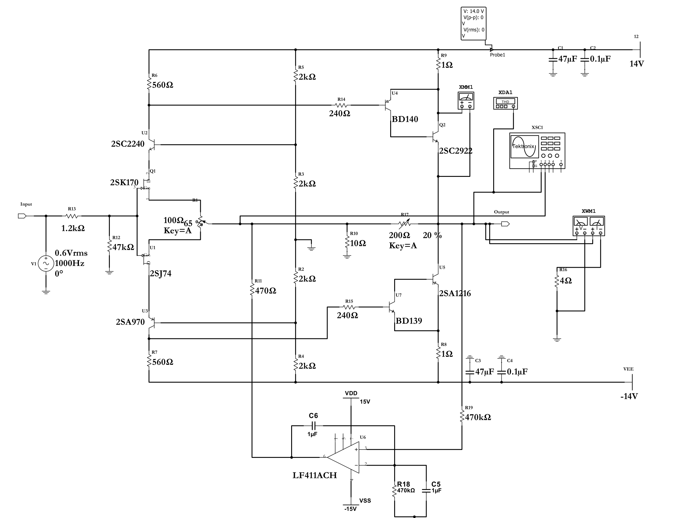

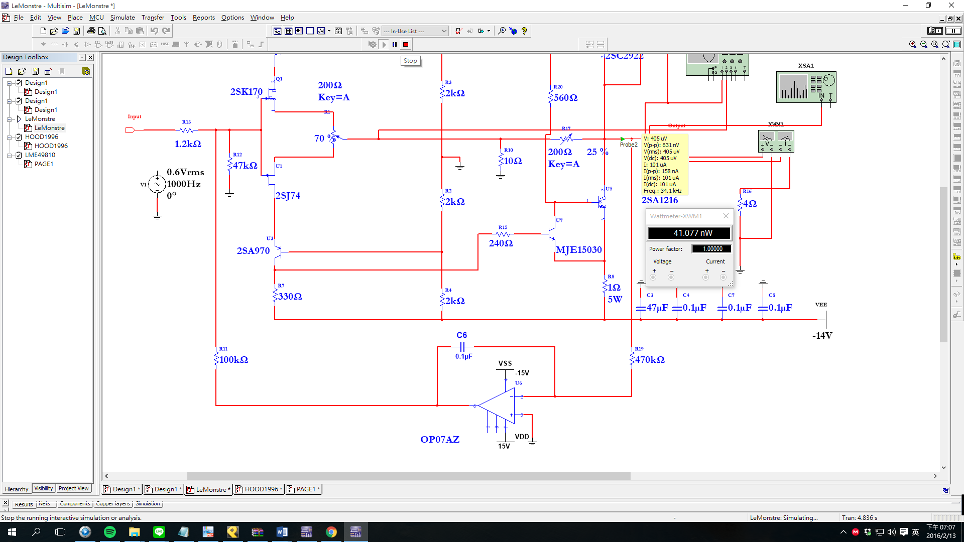

Hi guys,
I can't get close to 0mv, so I tried a DC servo, any suggestions?
BTW, I use SANKEN 2SC2922/2SA1216 as output driver, as the schematic.
Any modifications needed?

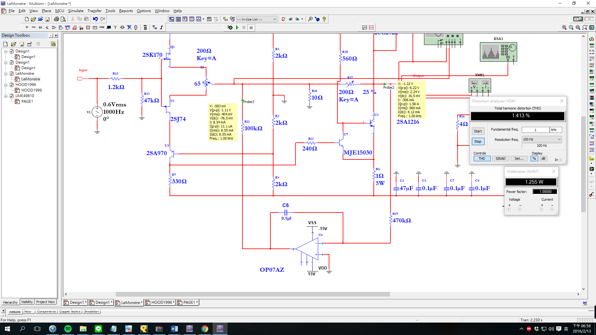

THD is around 1% and output is 3W, not very satisfied.
A DC servo should work nicely in this application. I haven't used one but I did with my JHL10 build and it works perfectly. I think the issue with your implementation is that it doesn't have any ground reference to seek. As it is all it is doing is smoothing the DC bias.
Look at this implementation from Tubecad for an idea of how to reference it to ground:
Shoog

Try to reduce R6 to 470 ohms, or 330 ohms.
Jfets are not so complementary after all, and ususally they skew into the N-channel path.
You could also try and place a 100 ohms between the N-channel source and the trimmer ( or increase the trimmer value to 200 ohms).
Edit: The trimmer I am talking about is the one called "65%" used as source degenerators.
Try injecting the DC servo in place of the bias adjustment pot at point A. You should be able to replace the pot with a pair of fixed resistors.
Once you have this setup you need to implement a DC speaker protection circuit to protect against failure of the DC servo.
Shoog
Shoog
