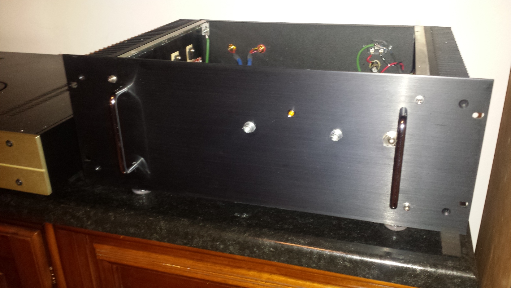

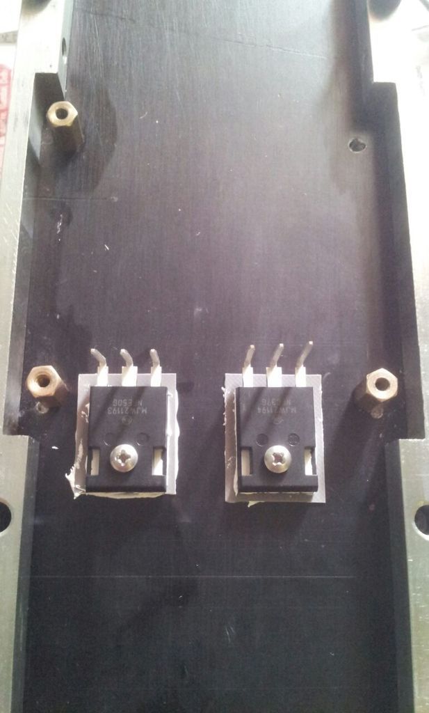

Few more pics,

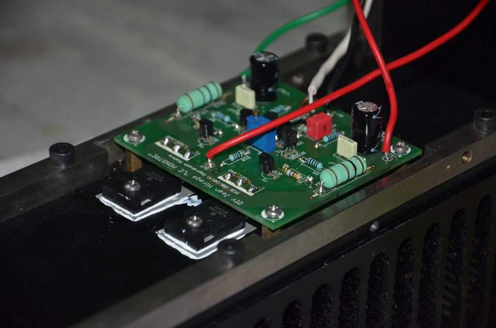

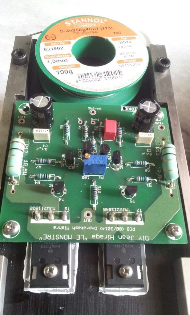

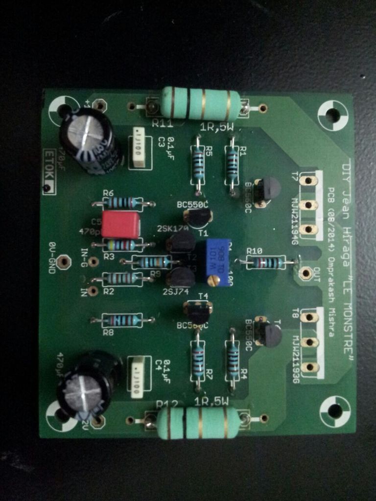

Amp boards completed:

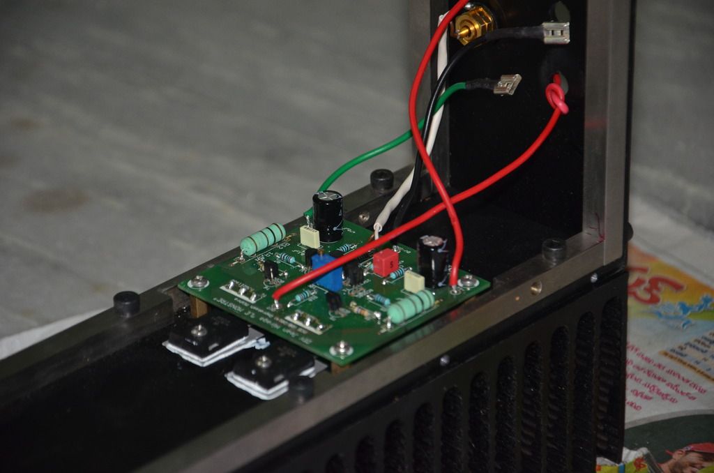

Test fit:

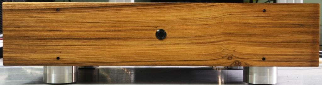

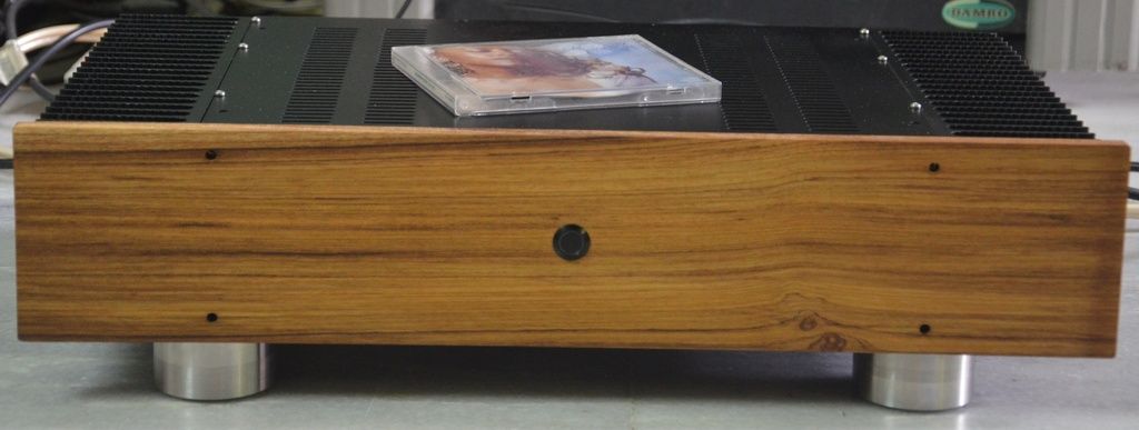

Faceplate is still undecided between 10mm Teak wood or 8mm Aluminium.
Regards
Sachin

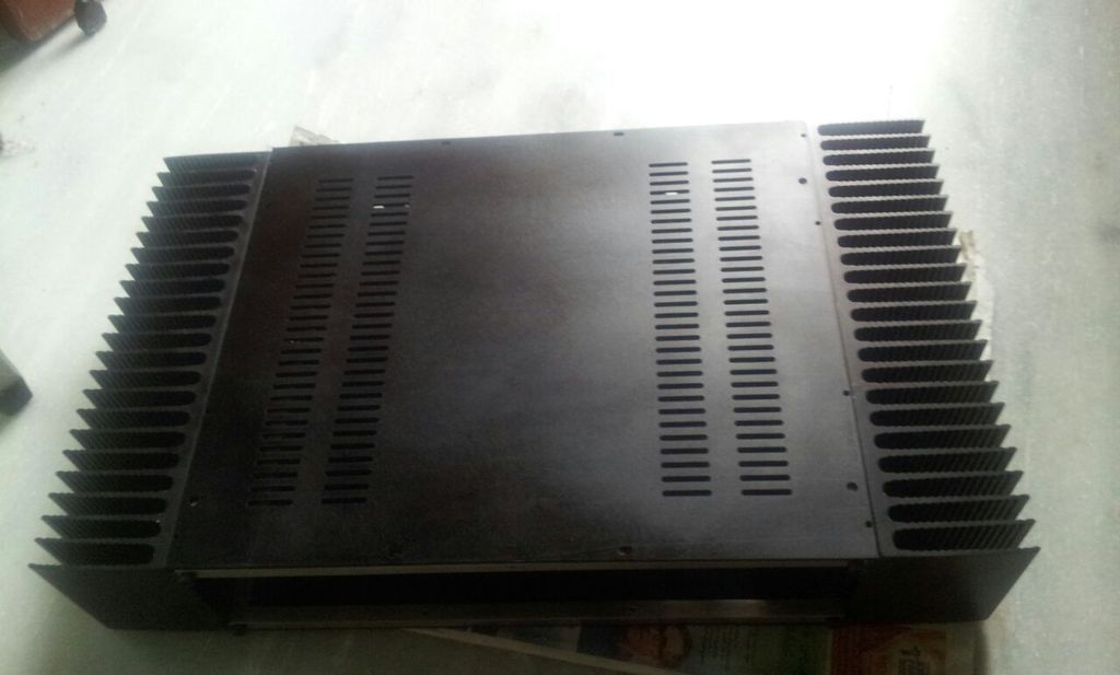

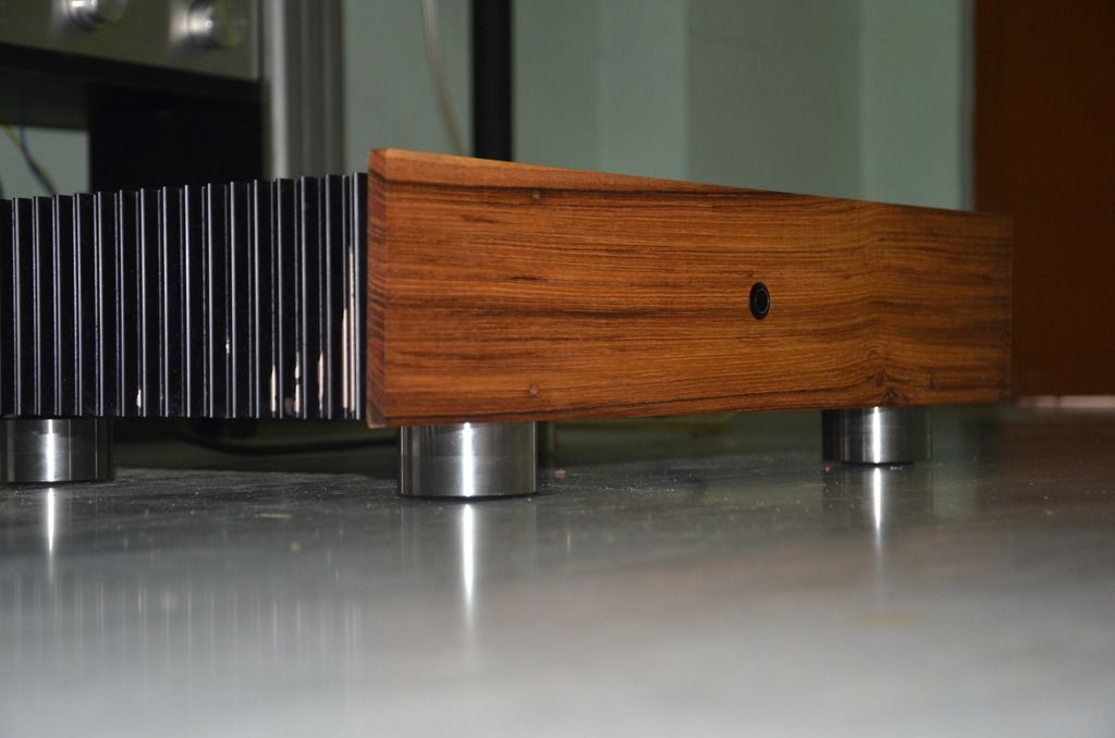

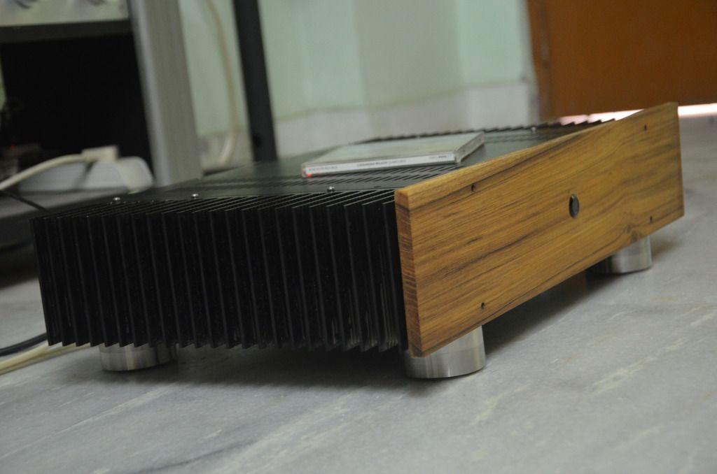

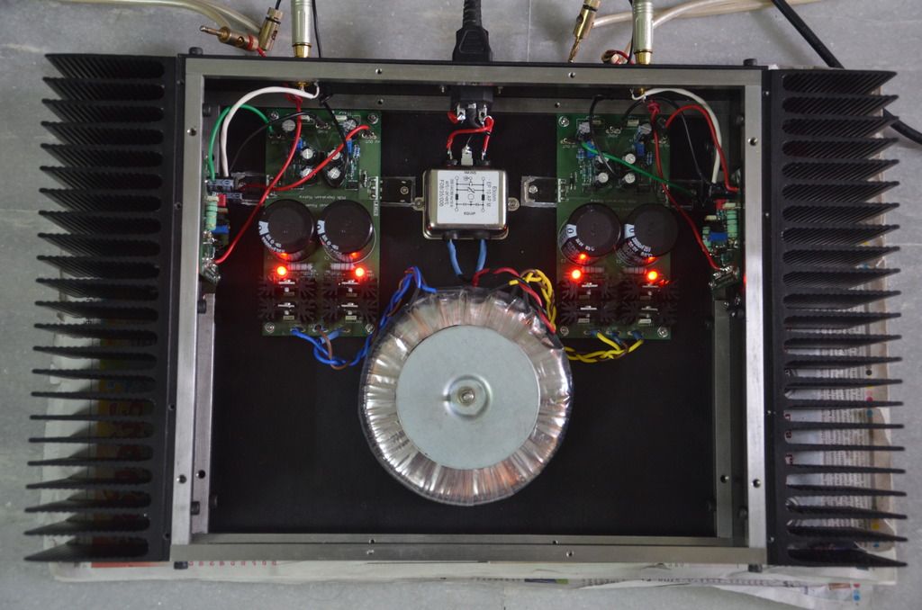

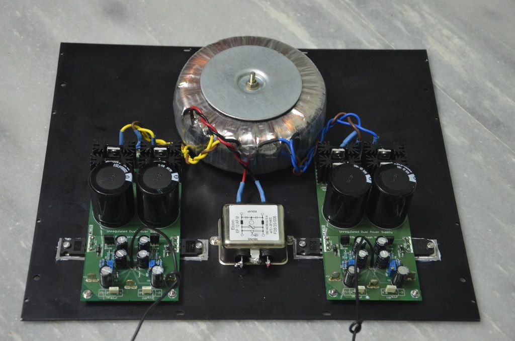

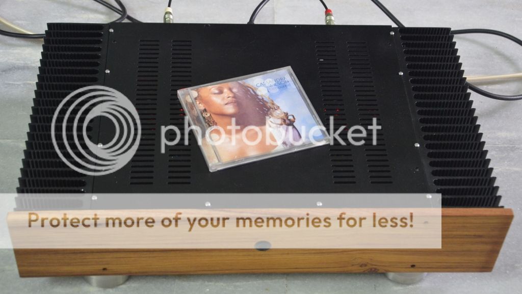

Finally my friend has completed it yesterday night. He has sent me few pics and audio clips. Amp is running continuously since yesterday night. It is running warm, all transistors are running warm. This has very good gain and sound quality is very good. Highs and Mids are excellent, bass is little less compared with his El84 SE amp.

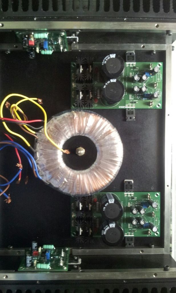

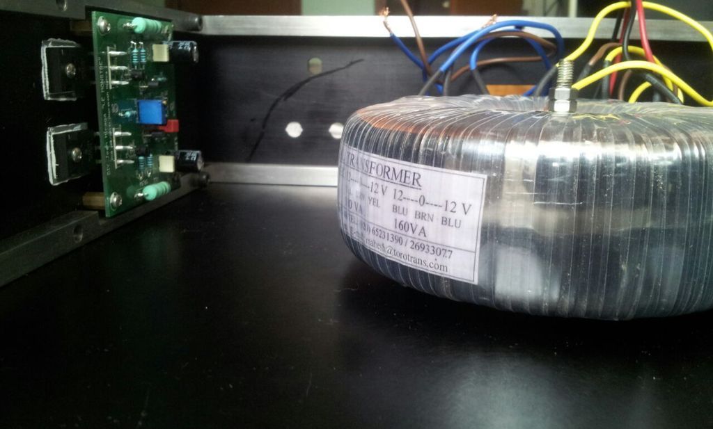

I must add that PCB layout is excellent.It runs without any hum, hiss etc. We are using cap multiplier Power supply. Transformer is 12-0-12, 320VA. Voltage is 12/0/-12. We are using 560R bias resisters.Amplifier is biased for 1A. DC offset is adjusted below 5mv.

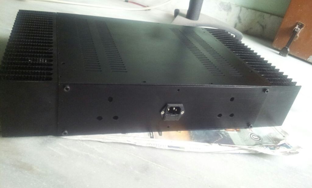

My friend has built very good quality all Aluminium Cab with thick Teak wood faceplate.
Here are some pics:
Faceplate is still raw and feet are temporary. It will look much better after final finishing.
Regards
Sachin

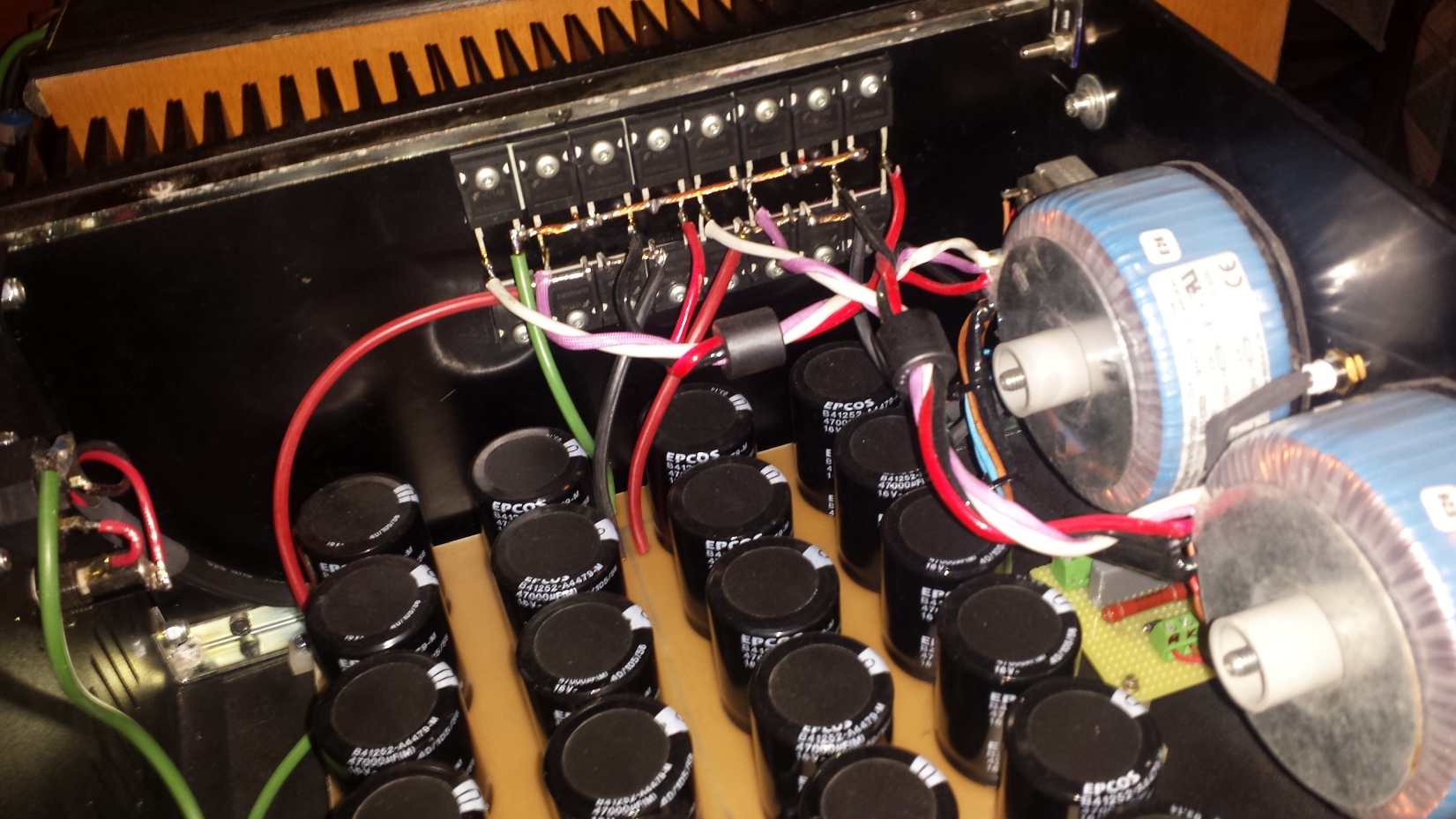

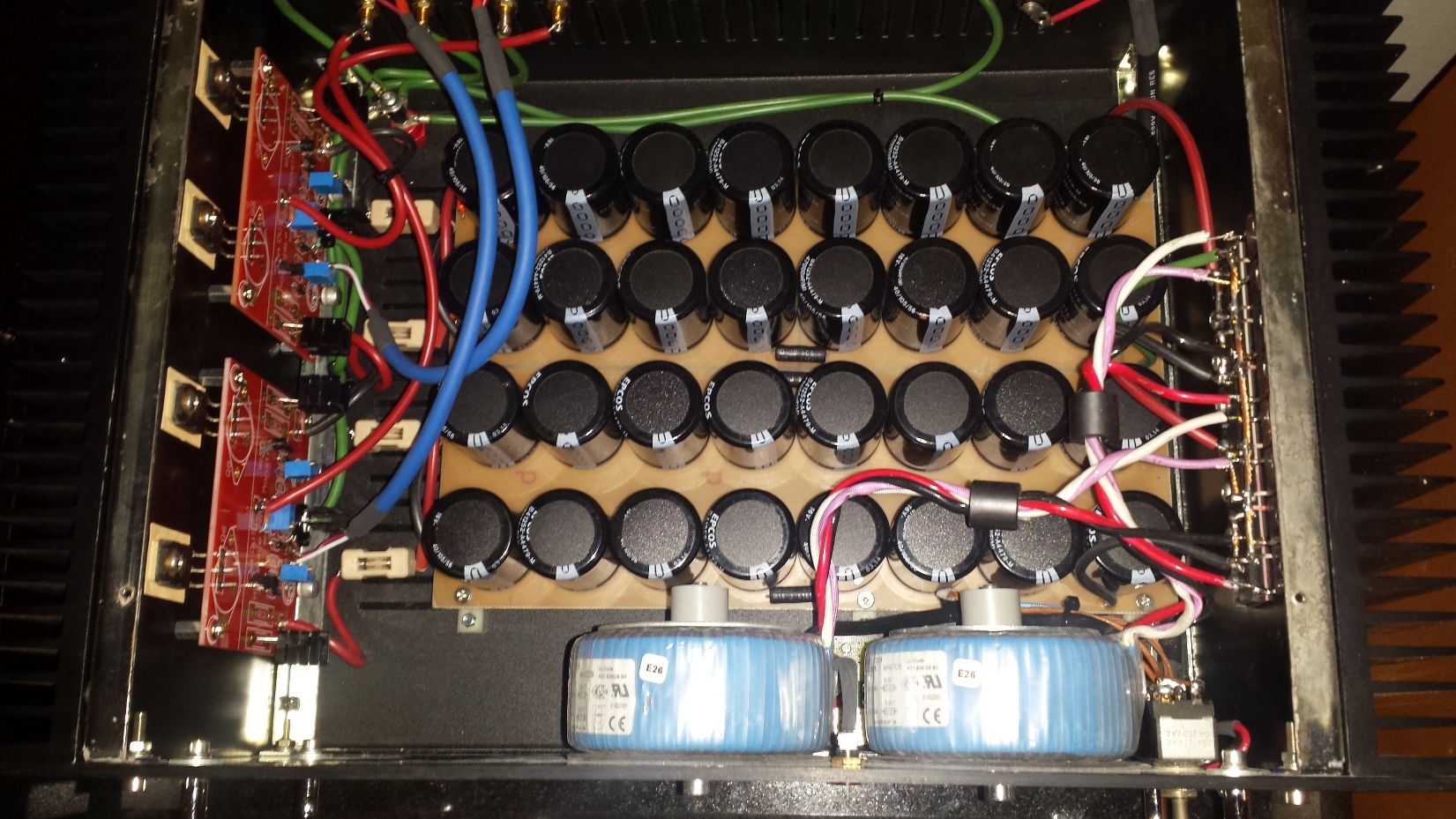

I am writing to share about my third realization of the monster. (I had made two other of which one is already shown in previous pages of the thread).
The building is completely dual mono.
The power supply (+/- 12.5V) is made of two transformers from 100VA with two 9-0-9 separate secondary.
Diodes are RURG 3060 and feed two independent branches from 0.75F each, for a total capacity of 1.5 F made from 32 x 47000uf / 16Vcc Epcos capacitors.
I bought PCBs on ebay from the store Jims Audio (very well build quality!).
Regarding jfet, I used the J103 and K246 matched with idss of 1.5mA.
The other transistors are BC550C and BC560C from Onsemi matched with 550 HFE.
The output transistors are the type 2SB754 and 2SD844 by Inchangé Semiconductor, (chinese brand but good devices).
For now, instead of the bias resistors, I put a 1Kohm trimmer, so I can do some testing about the bias current, (now is 590mA for branch and think it's a good compromise).
The result looks good for now. The amplifier is very stable and the output offset is practically nothing (1,5mV per channel), with no noises or hums.
The cooling fins reach a temperature of about 42 ° C after about 30 minutes power on.
The sonic result is excellent! Perhaps the best of the three that I have built up to now!
After this, I believe that having a lot of energy reserve is a very important thing for the end result that this amplifier can reach!
Once again, I am convinced that this is an SS amplifier of absolute reference and unfortunately is still very under estimated... :(
Maybe because It can be achieved with a not so expensive cost, and does not need an aluminum frontal of two centimeters thick! :D
Here there is the power supply schematic, and some shots (not excellent quality I know :eek:)
Any advice, suggestion or recommendation is really welcome!
CIAO!
