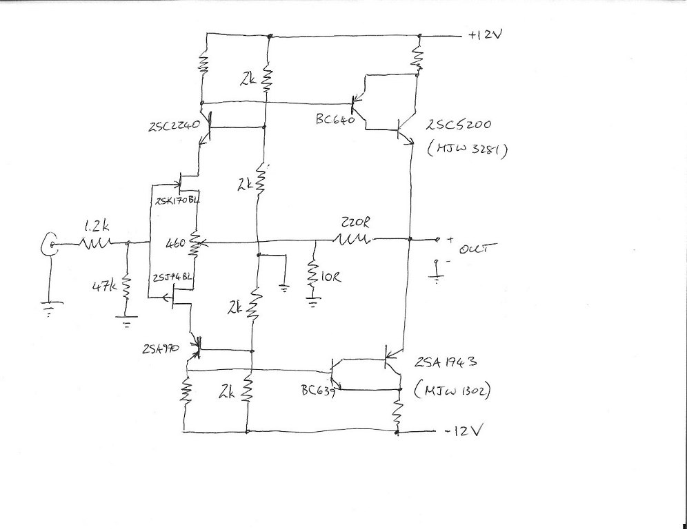

OK, here's a drawing of the circuit I'm using. I didn't put on the values of the bias resistors, since I'm using trimpots for these (at least for the time being). These are adjusted to give 550mA bias, as the Monstre articles recommend. (Although I suppose the recommended value depends on the output transistors too, right?).
I don't use PCBs (at least not yet), all done p2p.
It's not too hard to reduce the resistors on either side of the trimpot (which would reduce it form 460R to, say, 300R). What do you think?

ok my suggestions are,
return the trimpot to 100 Ohms.
barring changing the BJTs all to original or closer, perhaps the resistor walues need to be changed (the 2k ones) to have the transistors all operate in the most linear part of their curve.
I am not sure about the bc639/640 i will look at the datasheets and see if anything obviously wrong sticks out
