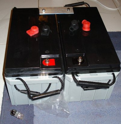

Dan, these are quite expensive, 270Euros including the charger!
That is what I said earlier to another member, it is a simple but not cheap amplifier, if you want the best performance out of it.
But... How much a PSU would cost with all these capacitors? (And it could never be cas lean as the batteries)

There are two issues with audio power supplies.
#1 Ability to supply large currents very quickly with little sag, and
#2 Series impedance for earth return of speaker currents.
The first issue is pretty clear; to reproduce sharp transients, a low source impedance is needed, particularly at higher frequency. Bass frequencies are not so bad because they are slow, and SLA has very little sag at high current.
However, about 50% of the energy in music is above 500Hz, where the deficiencies of a SLA battery are significant. Midrange and top end, which are faster but lesser current draws. Bypassing the battery with quality film caps is very helpful here.
Issue #2: All amps with bipolar power supplies alternately use the + and - rail caps to form the return paths for the two circulating currents from rail, though output device, to speaker, to ground, and back to rail. Therefore a high ESR in this link will affect the speaker operation. While the ESR of the battery is very low up to 10KHz, beyond this it rises rapidly and can affect damping factor. Balanced against this is less requirement for damping with rising frequency, but for neatness it's a great idea to have high quality caps bypassing the 1000uF battery cap. Say something like a 22uF silver/oil Mundorf. If you are spending a lot of money on the supply, might as well go the whole nine yards and use a few nice caps for bypassing. For electros, use something like Black Gates, or Nichicon Muse.
Hope this helps,
Hugh

For an 8W amplifier, you would only need around 1000uF as coupler anyway (8R at 20Hz Xc and very limited current, around 11.3Vpeak, or 1.41A into an 8R speaker), and this is the reason I do not overspecify. You can certainly use more than this if you want, but taking account of the premium quality it gets expensive, particularly if you use 10,000uF.
I use only 1800uF coupler for a 28Wrms amp, and it's fine down to 25Hz. Best not to go overboard, particularly as a battery has very strong current delivery at low frequencies. It's essentially the higher frequencies which are significant, here.
