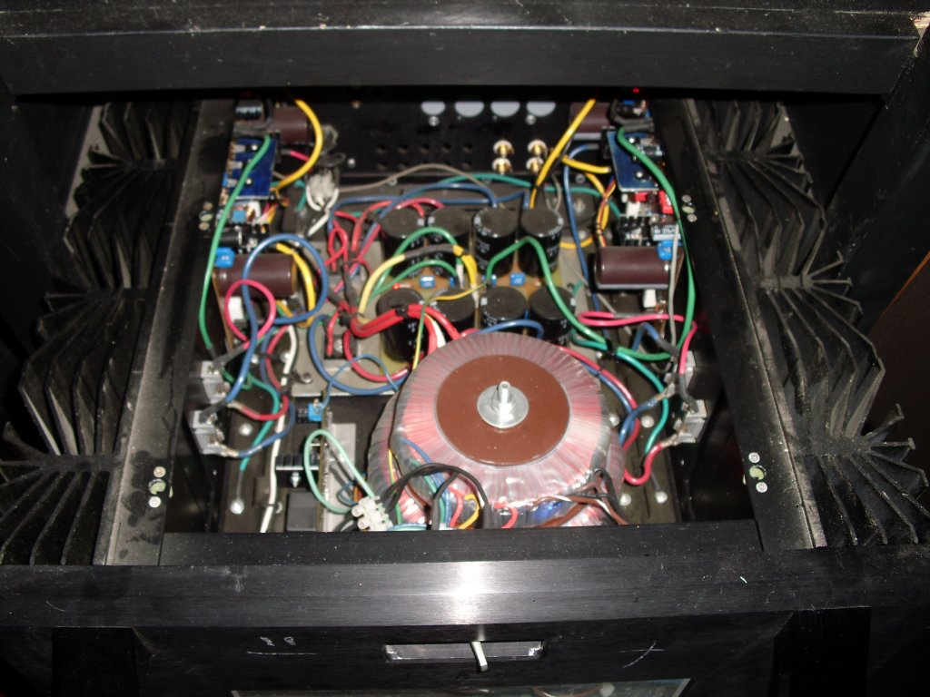

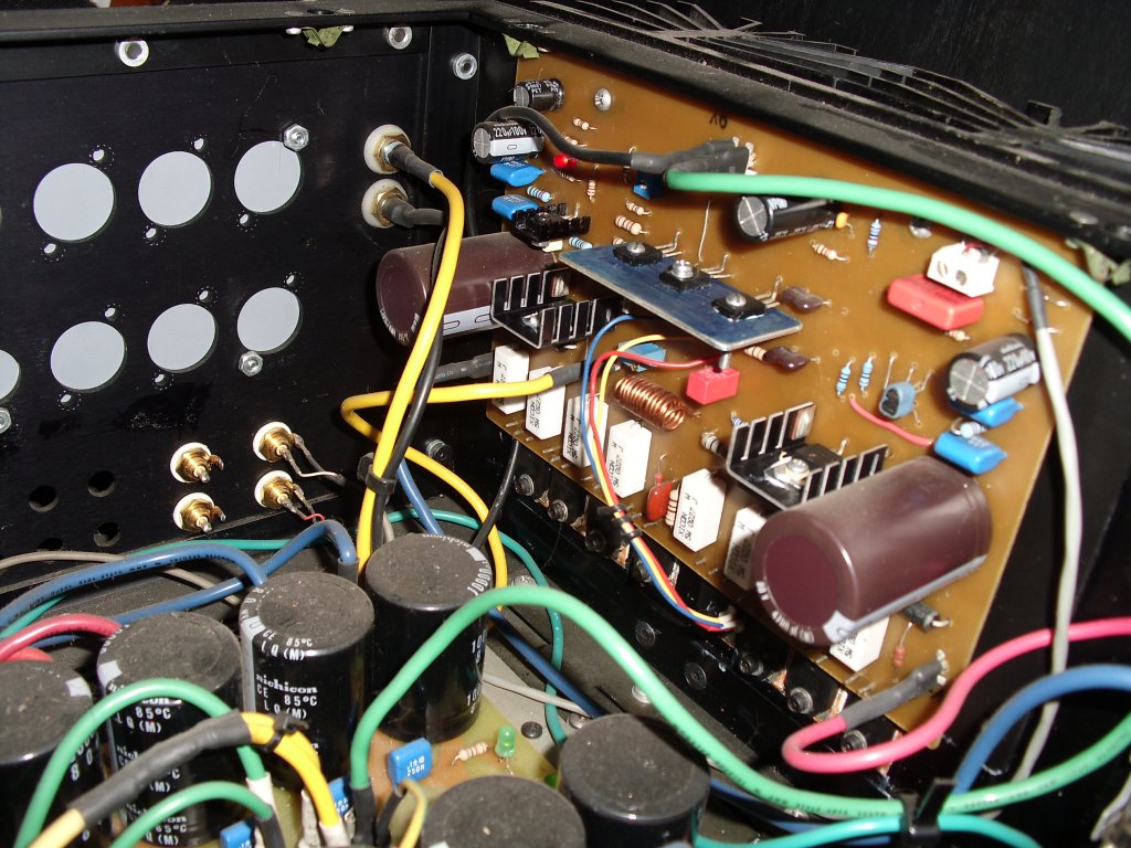

I totally agree , high end must be "straight wire with gain" plus drivers , REAL outputs (like in picture). I built P3A's , self amps , and others. It seems the speaker makers on the forum like symasym's , so I chose that and made it bigger.
anadigit - But I have to pay more than 1400USD
Oh my god , and that is all you get .... darlingtons and a cheap op-amp , $50 per channel and possibly $2-300 more for the rest got me all of picture 2 below. Separate + - 50v LPT/VAS supply and + - 77v OPS (2 toroids) and a real output stage :flame: . The symasym has been shorted twice and only blew fuses . I could build 4 of them for $1400... WOW audiophools..
As far as "1985 amplifiers" .... what is wrong with 1985 ??? good year ! :D Just use some modern parts , "tweak" the original design , and you have very reliable /musical amplifiers... most of the popular designs on this forum (self ,leach, RCA/DX , etc.) ,originated in that era. Whether you get .05% or .005% .. does it matter ?? I have built , simulated and tested a "DX clone" and it does .06%THD at 50 watts (mine had a real CCS and better parts). They all sound good (at least mine do) , my symasym does .02% at 200 watts and I can only hear it's superiority on demanding classical material.
