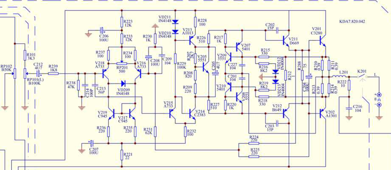

...by the way this is the reason why I eagerly wanted to do simulation with those Toshiba devices.It was used in VAS.

Replacement for Toshiba's 2SA1932/2SC5174 wanted (230V/1W-outline similar to ISO220)

The application therefore is the first transistor of an output triplet in a power amp (power follower stage), which is in use on a RB1090 from Rotel - go to

The emitter resistor is 1000R - thus the necessary current delivery capability must be actually low.
Rotel had nevertheless decided for a more large transistor outline (above TO126/TO220). Why?

I like to use TO126 devices for the first stage of a Triple output stage. Do not under-estimate the current delivery requirements and safe area requirements of the pre-driver under high-output-current conditions, especially considering beta degradation in the driver and output transistors. Also, do not overlook the stressful conditions of a short-circuit condition during the brief time before short-circuit protection comes into play.
I like to run the pre-drivers at 20mA in a larger amplifier (say, >150W). If the no-load rails are 65V, the dissipation is 1.3W. Also, the TO126 package makes mounting to a heat sink easy.
Also bear in mind thermal bias stability in the Triple, where 3 Vbe are in series, so junction temperature changes, especially during heat-up, can significantly affect the idle bias. For this reason, I like to keep the junctions from heating up to much; this in turn leads to the desire to heat-sink the devices.
I also like to use TO-126 for the VAS.

Hi Bob, thank you for your advices. And I have found a better available replacement part - obviously from the same process: the 2SA1837/2SC4793 in an ordinary TO220-ISO outline:

What happens, if the transit frequency is less than 100MHz ?

30 MHz for a driver is OK, in my opinion. Just remember to run it with a healthy bias current, perhaps on the order of 50mA or more.
