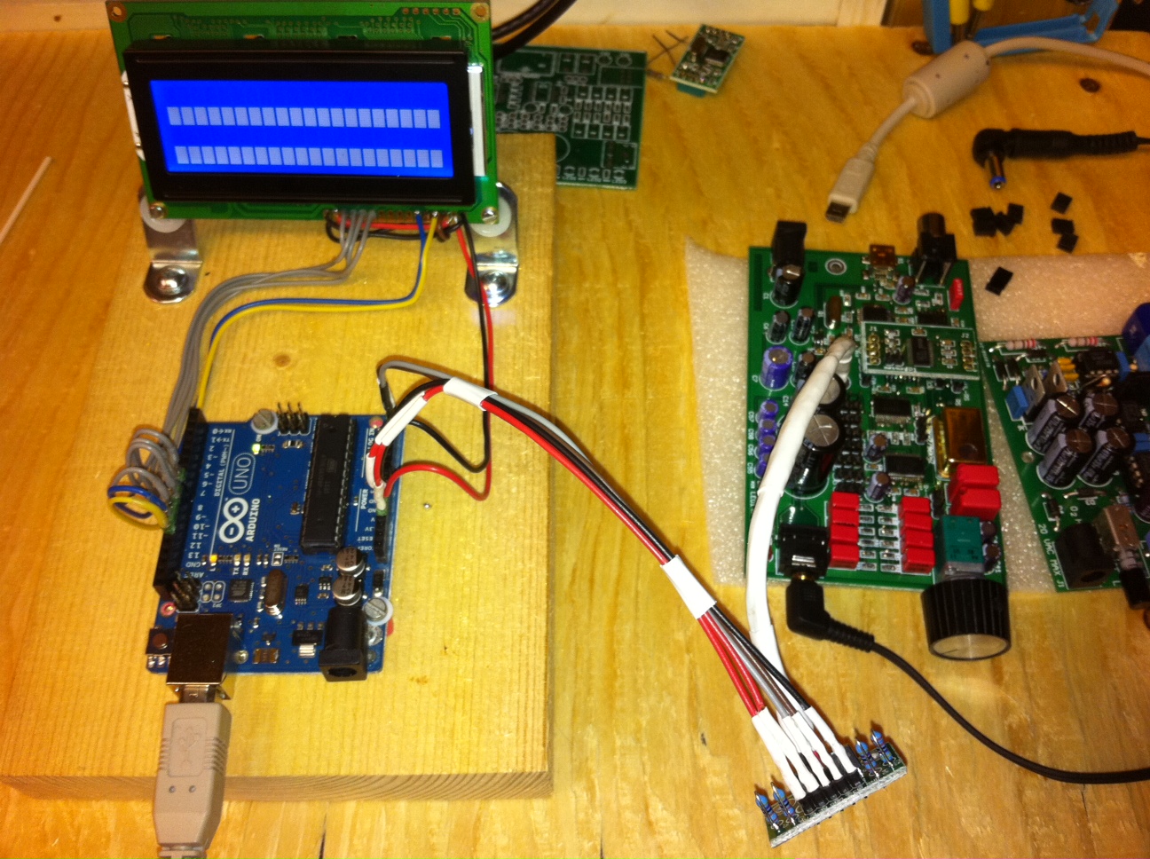

OK, as a test I connected my LCD to the Aurdino, compiled the example "Hello World" and uploaded it - worked at once. Now the connectors which appears to be on the bottom of the LCD actually is on the top... My hello world came out upside down

Very well, compile succeeded at last after fixing a bug in Wire.h - replacing a lot of Wire.send -> Wire.write - replaced 1 Wire.receive -> Wire.read - included Aurdino.h to the LCD cpp file - replaced a lot of void with size_t... ( I probalbly forgot something ).
Anyway it loaded and now shows the characters of line 1 and 3 fully illuminated (boxes). I don't know if this has to do with that I haven't connected the lines from the DAC yet. That will be for tonight to find out.

I have my LCD connected to the six pin header at the top center of the UNO as you have it oriented.
I haven't checked those pins out but I recon thats another way to do it.
My connections follows our grand gurus drawings.
I will grab the computer downstairs before it gets occupied by the kids and send the files I have tampered with. Save your originals and run a diff to see what I have done. Now, my code compiles without a hitch but does not work on the LCD. This should be rewritten to use the new LiquidCrystal library IF we don't get any more updates from the grand guru.

I connected according to this:
What I did...
1: Get the Arduino 1.0 and install it.
2: Copy my files to where I tell you to.
3: The above would be the way if not the attachment support on this would have prohibited me to attach code...
I will put them in an archive and post them when ready...

One peculiar that I do not understand is this one:
LCDi2cW lcd = LCDi2cW(4,20,0x4C,0); // Initialized the library
compare it to:
// initialize the library with the numbers of the interface pins
LiquidCrystal lcd(12, 11, 5, 4, 3, 2); // where I use 10, 9, 8 and 7 instead of 5, 4, 3 and 2.
The first one is from the provided lib and the second one is from the new LiquidCrystal lib... What is (4,20,0x4C,0) ?

I'm using a serial LCD I bought early on when there was still a discussion of serial vs parallel displays. I think it might be easier to just buy the HD44780.
There are som help at the arduino site in regards of using serial displays - just follow these and after initialization the code should be the same.

In one of the files our beloved guru sent to us there was a include of "Wconstants.h"... Now neither the IDE or I could find the file. Would this be Aurdino.h? I included it to get rid of the "delay not declared" errors and commented Wconstants.h out.

I thought we could just use the code from Hifidina, its the same hardware ?
Hmmm, I'll check it out. Thanks regal - no need to invent something that is invented and working. Isn't the name hifidiuno?
Brgds
Brgds
Yes typo, Hifidiuno.
The hifiduino code for our dac was the same as heartwinter sent to us... Doesn't work...
As a test I downloaded the buffalo II code and uploaded it. Works at once (if I had a buffalo dac that is.). It would have been nice of heartwinter wich version of the Arduino IDE he used to get the code to work.
