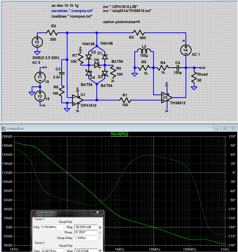

collecting more of my sims here...

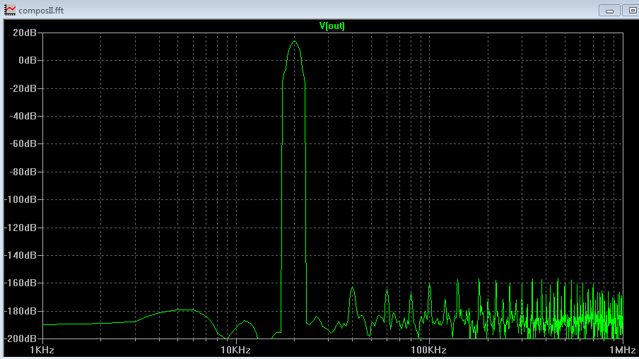

I reworked my old compos.asc sim with new low noise input OPA1611 and the THS6120/TPA6120 for the output
trying for all the loop gain that can be squeezed to the outer loop I get 20 kHz THD <-160 dB 7 Vrms/50 Ohm load - for whatever the sim # is worth
the simmed loop gain shaping gives near 60 degree phase margin while having over 120 dB loop gain to 30 kHz
the modified integrator feedback and the 100uH inductor shunt push all the gain that can be had from the CFA output op amp into the outer loop for the extended audio frequency range - haven't tried the inductor trick in the real world - but I did choose a model that has a parasitic parallel C so maybe its not too unrealistic
also used noise gain shunt at the input to improve the loop gain intercept region
I find LTspice convergence problems with these ridiculous high loop gains - if you mod the circuit much you may have to retry the .savebias/.loadbias (un/re comment the lines on the schematic, possibly esc out of long startup stepping)

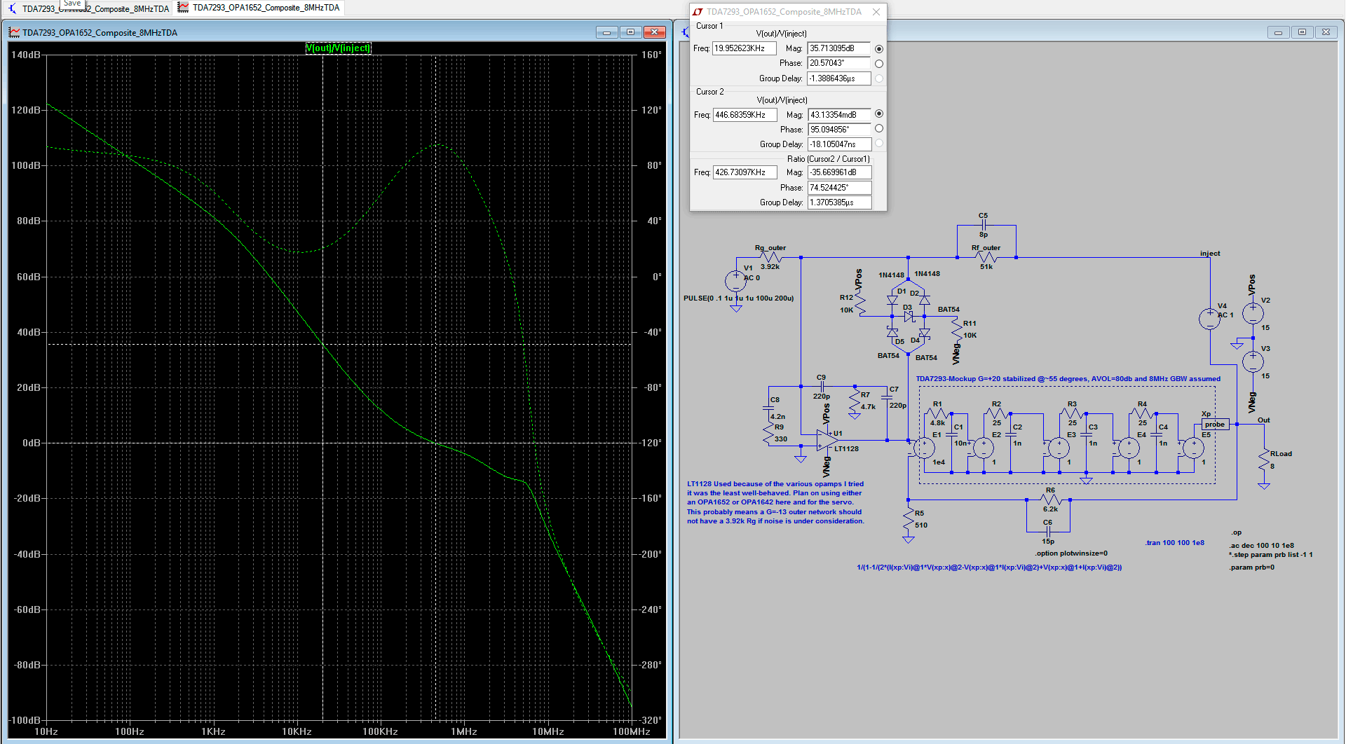

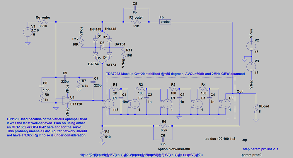

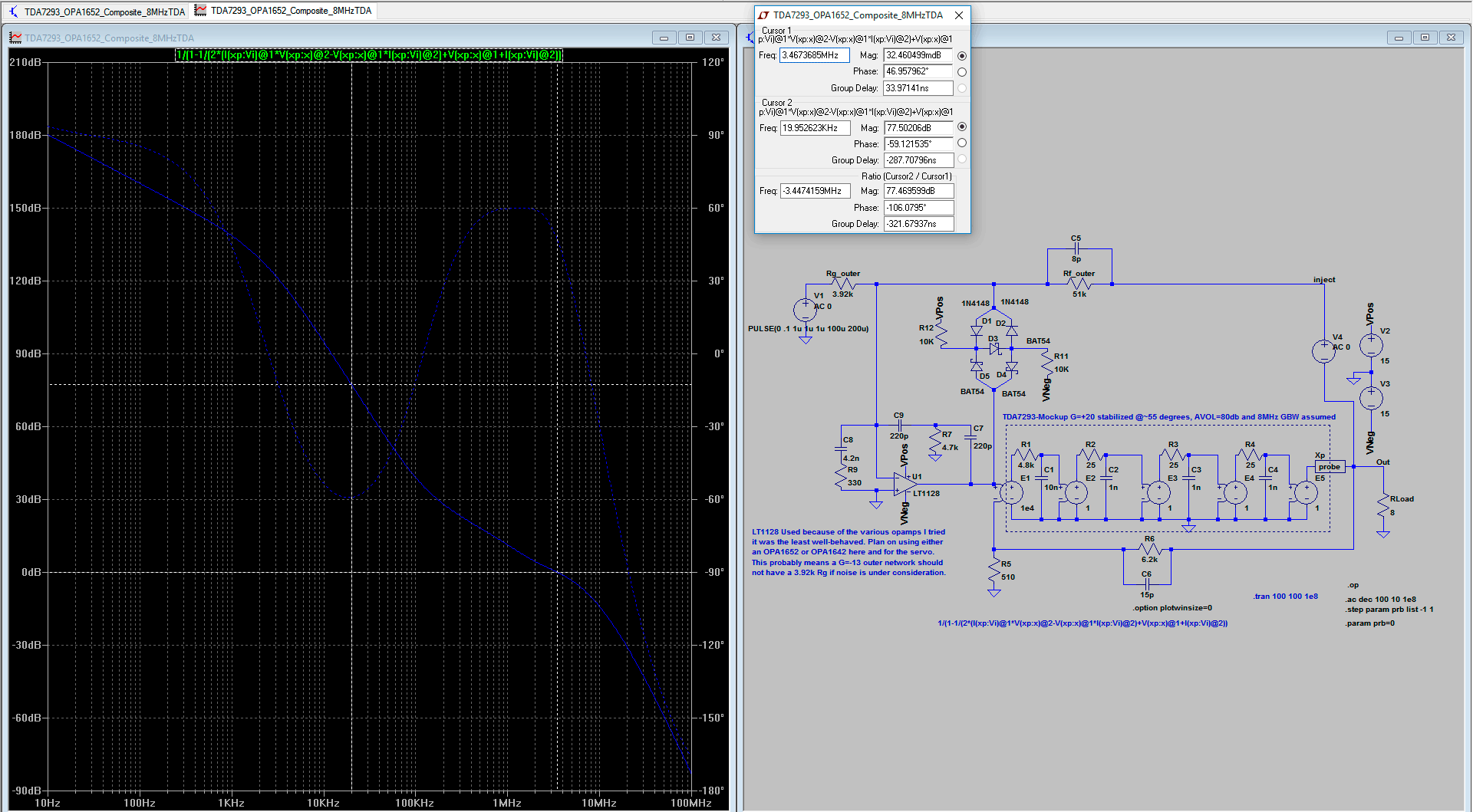

With a bit of trepidation, and given I hijacked a bunch of jcx's ideas, I offer my (present) composite idea. Still a bit of a ways to go (servo, probably a balanced line receiver, power decoupling, etc), but here's what I'm thinking so far. Would love any comments, etc. Seems to pass a square wave fairly well, but of course I'm using a dummy macromodel of the 7293 that is hopefully pessimistic enough!
It's hard to get any gain into that outer loop with the loop intercept where it is, or whether it's even worth using that 180pF on the 7293's inner loop versus just running it straight at G=20.

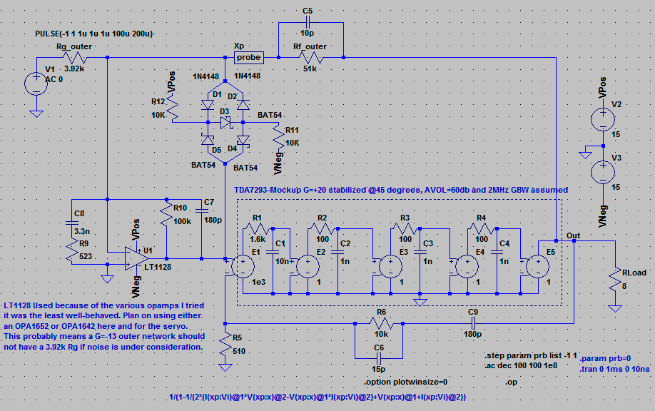

  • TDA7293_OPA1652_Composite.asc
David,
No need for worrying about tact (although you were!), I appreciate candid responses and am eager to learn. 😉

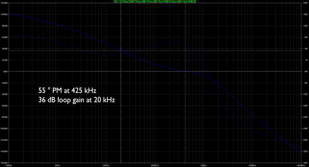

That small a loop gain and phase margin that's what I'm sitting here worrying about. Now, admittedly, I made the macromodel for the TDA7293 by reading between the lines of their rather-sparse datasheet (their Avmin is spec'd at G=20, so I worst-case scenario'd it at 45* of phase margin), and their nominal Avol is spec'd at 80 dB, so I underrated it by 20 dB to assume, again, a worst case scenario. UGBW is not even specified, and measurements around the internet are veritably sparse, so I picked 2 MHz, given the low end of where a fair number of chip amps converge. Perhaps someone around my uni department has the right stuff that I could measure my chips in circuit--time to see who's in a high speed analog group. 🙂
Re-configuring the macromodel for Avol = 80 dB and with a UGBW of 8 MHz (maintianing G=20 @ 45* PM) improves the outer loop's phase margin by ~15 degrees and throws (at 20k) about 15 dB more gain into the outer loop and about 10 dB more into the TDA7293's inner loop. And that's without adjusting the specified caps, which are obviously killing all the bandwidth. I'll see if I can get on the computer that has this more optimistic theoretical model and show what *should* be a much better design. But, yes, it does seem that I'm trying to squeeze blood from a stone with the above macromodel. It doesn't help I've chosen to run it underneath its minimum recommended gain, either.
I'd prefer to run the system at Av of around 13, since the signal source is hot enough to drive into clipping with 35 vdc rails. I already have the 7293's and an appropriate transformer, as they were given to me from a logitech z680 whose controller died. Trying to see if I can materially improve on the bog standard layout of it in non-inverting.
So, with that, I'm all ears for suggestions (critical especially). It's looking more and more like Panson's solution to using the LME49811 as a driver for the 7293's OPS might be a better solution.
...I appreciate candid responses...
OK! That makes it worth the effort to look more carefully at your work.
So I now notice that your probe placement is incorrect.
The feedback splits after the TDA7293 macro-model, you need to put the probe in the circuit before the split, in other words immediately after the controlled source.
Try that and post the results, perhaps some of your problems are only due to bad data, certainly essential before any more work.
Best wishes
David

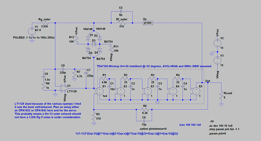

Round 2: major differences are:
1.) I slightly relaxed the constraints (model assumes about 52 degrees PM when the TDA7293 is used, without any compensation, at G=+20)
2.) No integrator on the TDA7293. This alleviates JCX's DC convergence issue (even though using the macromodel makes it an effective farce).
3.) Stabilizing the TDA7293 into G=+13 with lead compensation. May not match up with reality.
4.) 2nd order integrator on the input opamp pushes its forward gain at 20 kHz much higher. This leaves me concerned about its stability (even if spice is okay with it...)
The "guessed" endpoints to the TDA7293 are modeled: (both modeled as 55 degrees PM @ G=+20)
1. GBW=2 MHz, Avol=60 dB
2. GBW=8 MHz, Avol=80 dB
The amount of lead compensation one needs decreases with the higher GBW model, so that's the only change made in the two .asc's attached. I, understandably, pushed the lower GBW model, leaving a lot of loop gain on the table for the higher GBW model, but without knowing what I have, it's *hopefully* a safer bet.
Putting the probe anywhere on the outer loop yields the same result.
Comments/critiques appreciated! I'm here to learn.
Thanks,
Daniel

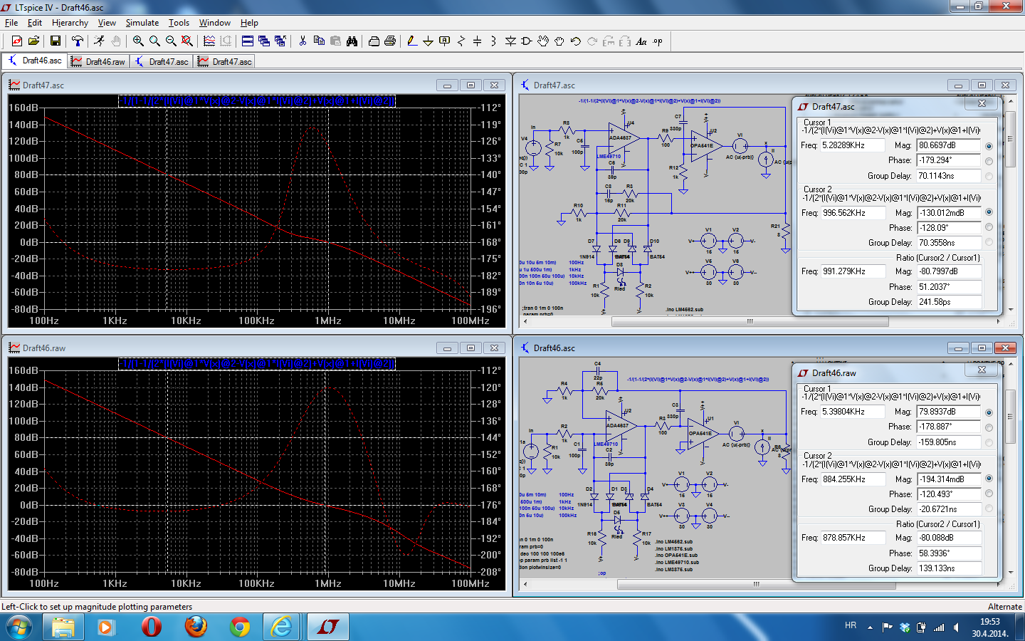

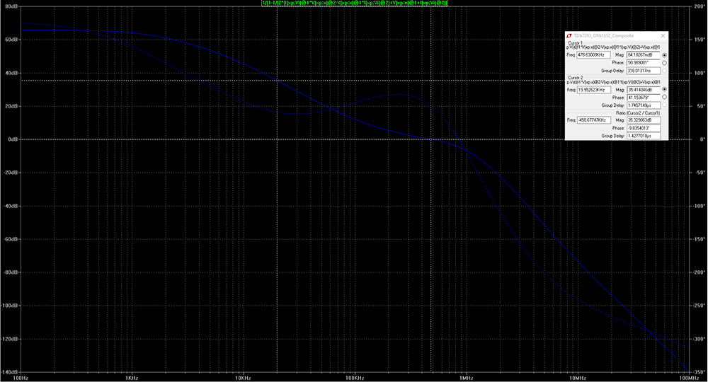

JCX, David,
Thank you guys for your help so far. I really appreciate it! Agree entirely that having a solid set of measurements for the TDA7293 is very important to squeeze, well, most anything out of these chips.
David,
My mistake on the location of the loop gain probe. I foolishly assumed that injecting on any side of the node would result in the same result, but alas, not the case.
Attached are both suggested loop gain tests, along with the appropriate circuit images (modified the least I could do) of the 8MHz GBW macromodel. First image shows the results of the Tian probe and the second image shows the loop gain via JCX's suggestion (which looks very similar to the Tian probe at the same location).
Thanks,
Daniel

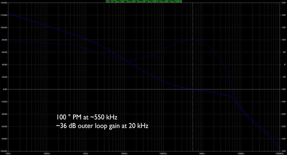

...David,
My mistake on the location of the loop gain probe...
No problem. Probe placement is crucial once you try multi-loop schemes so it is important to be correct.
The results now look much more reasonable so we can proceed.
One point is that the TDA model is perfectly minimum phase.
So theoretically there is no limit to how far we can push the ULGF if we correctly cancel the poles with zeroes.
I don't know what the practical limit for this is.
JCX may have some real data on this.
...which looks very similar to the Tian probe at the same location).
A simple V source probe at this location will match the Tian probe but I don't think it's very useful.
I suspect it's not JCX's recommendation.
Best wishes
David
