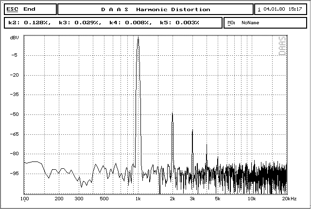

Total Harmonic Distortion Graph of PP-1C
Hi Shoog!
Such distortion THD I want to get around the preamplifier, but with higher 2H> 0.5%. (as in this amplifier: Total Harmonic Distortion Graph of PP-1C).

So then what is the difference between tube preamplifier and MOSFET preamplifier?
If distortions are below the THD <0.001.:eek::confused::rolleyes:
thank you
Many MOSFET amplifiers have a very particular mosfet sound despite their low measured distortion. I personally dislike that sound.
Until you go ahead and build your first tube preamp - you will never know. My experience is that there is far more to the sound of a preamp than simple THD measurements - otherwise we would all be using OPAMPS for everything.
