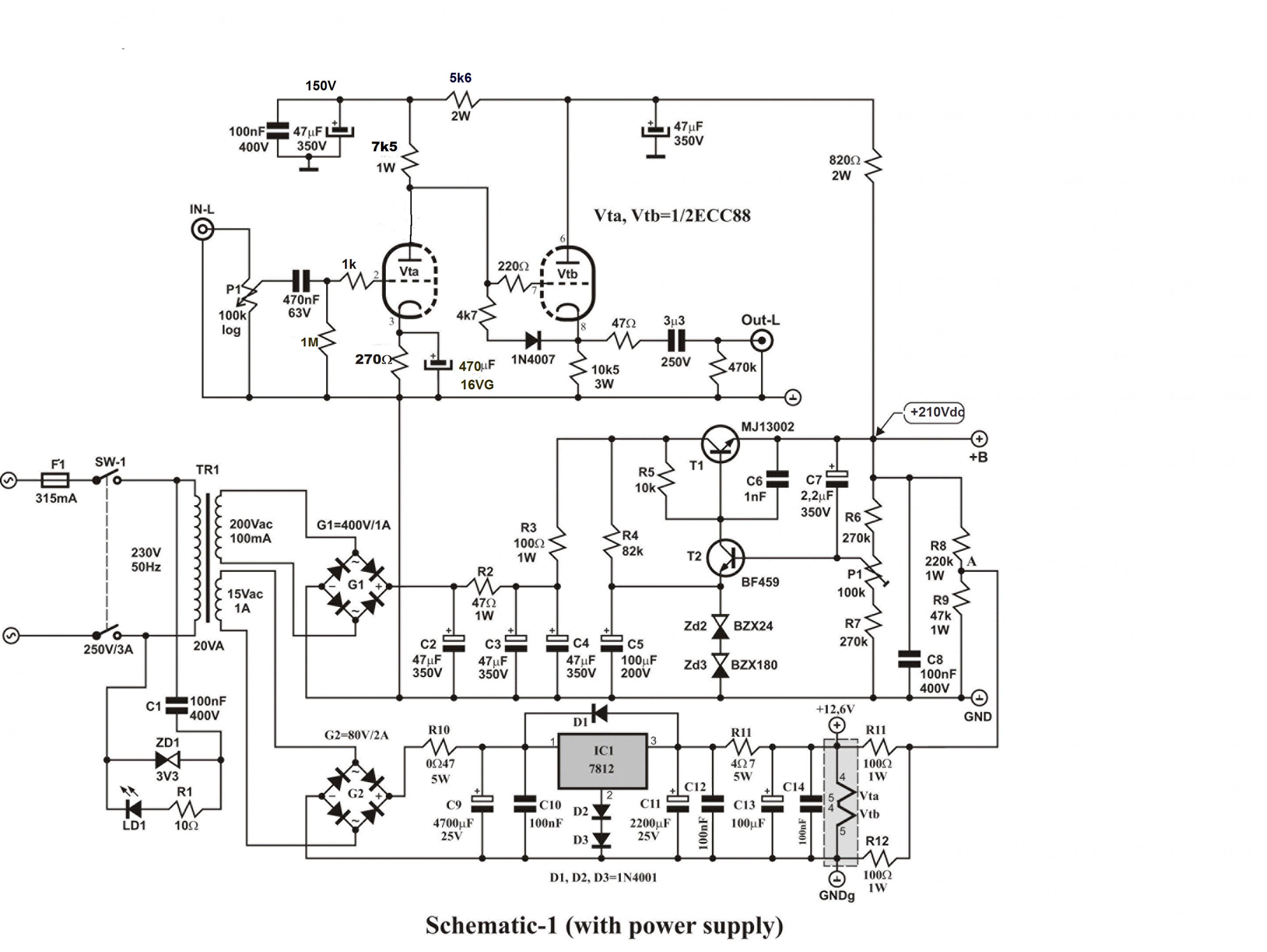

A definite schematic for preamp.
Hi All!
Here's a definite schematic of quality preamplifier with ECC88 (6922, 6jD8).
Build this preamp and then enjoy his sound!!

With 1 Vrms input THD is more than 1.2 %.
So it is not a high-end pre amp.
But after some modifications it would be.

At the output of the second harmonic 1Vrms less than 0.5% (2 harmonic <0.5% and 3 harmonic<0.03).
It is true tube/valve preamplifier!!;):up::violin:
If you have any suggestions about some changes to the schematic go ahead!

If 1 Vrms is sufficient output level, why this amplifier is having the gain of 20 (=26 dB).
1 Vrms is achieved with 50 mV input voltage.
I think that typical input voltage is between 0.5...2 Vrms and if 1 Vrms is OK as the output level, should the gain of the amplifier be something 6 dB or so ?

Mr. artosalo that changes to the schematic you recommend this preamplifier to give a better sound (High-End preamp)?!:confused:
