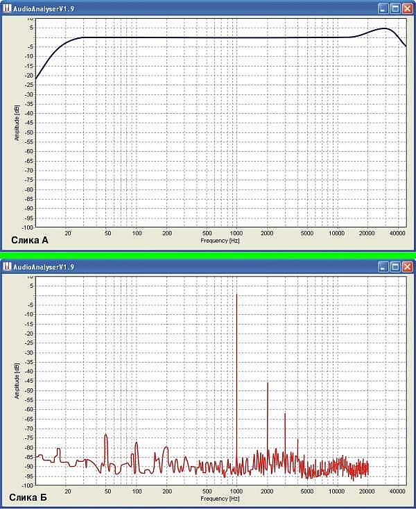

This is the frequency response of the complicated RC-network between the tube halves. There is practically no effect at the audio band.
What is it for, execpt attenuator ?
The frequency response of which?
I do not understand, whose is this frequency response?
And where are the measurements of harmonics?
The network R12, R13, C3 and C4.
Those I would like to see too. Have you measured ?
Sorry, I'm confused. In what sense of "high end" is this a high-end preamp? It uses high gain valves, but then attenuates much of the gain away. It has a relatively high (and variable) output impedance so cannot drive long cables. It has an equalisation network, for no apparent reason (except perhaps to compensate for stray capacitance in the high impedance attenuator?). It has to be high impedance because of the peculiar choice of valve. The only sense in which it might be considered 'high end' is that it is eccentric!
Sorry, I'm confused. In what sense of "high end" is this a high-end preamp? ...The only sense in which it might be considered 'high end' is that it is eccentric!
Bingo. Heavily designed, lightly engineered.
This kind of construction has better linearity due to local negative feedback at first stage. The gain can be reduced by increasing cathode resistor (now 5k6) if required.
The output inpedance is also much lower and constant compared to your circuit.
