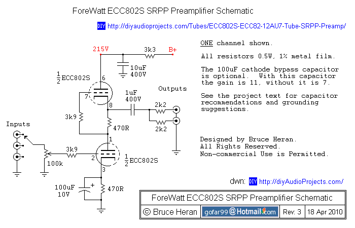

Preamplifier with PCC88
PCC88 and ECC88 (VHF dual triode) are the same valve, but with different heater voltage. KT88 is completely different (output kinkless tetrode), as is EC88/PC88 (UHF grounded grid triode).
DF96, thanks for the information. Please to help and others drafting the preamplifier with PCC88, I need a schematic or project.:confused:

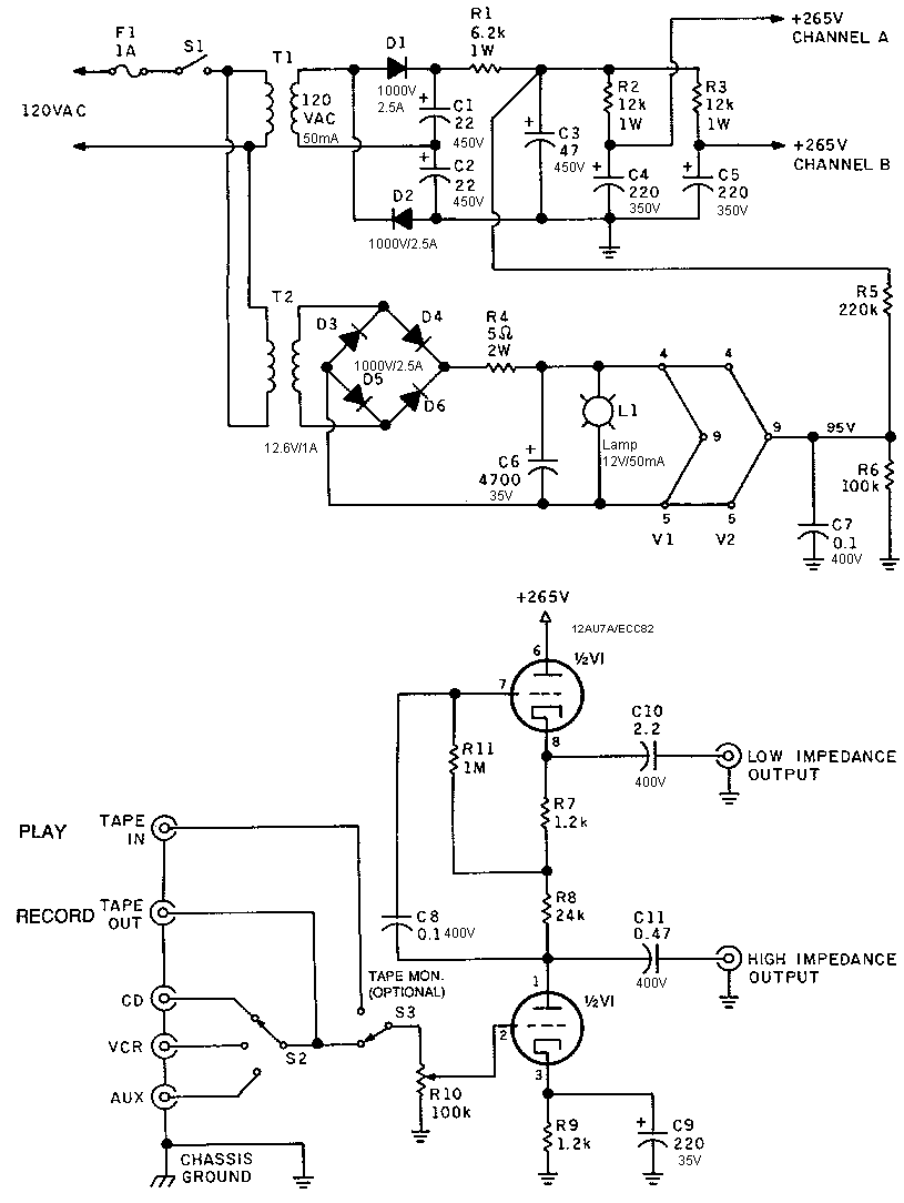

Yes, fortunately valves are so versatile that using the wrong valve in the wrong circuit with the volume control in the wrong place can still result in not too much damage to the sound. As I said earlier in this thread, this preamp is "high-end" only in the sense of being eccentric - it isn't even ridiculously expensive! It would work better as a guitar preamp, for people who really appreciate distortion and lumpy frequency response (-45dB second, +5dB peak just above the audio range, according to its designer's measurements).

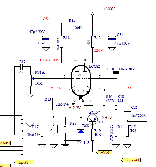

New Line-Stage
Hi
Here they are:
R1=12k, R2=30k, R7=470k, R9=1M, R8=30k R10=100k, R11=2k7, R12=560k,
R13=100k, R14=1M, R15=1k5, R16=100k/o,5W, R17=1k/1W. Out P1=50k/log
all resistors with 1% metal film!!
C1=470nF/63V-MKP, C2=220nF/400V-MKP, C3=5p6/500V-stiroflex, C4=33pF, C5=220nF/400V-MKP
C6=3,3uF/100V-MKP, C7=100uF/350V, C8=100nF/400V.
Regards ;)
Hi guys!
For resistor R11 = 1k2 and cap 220uF/16V
Believe excellent sound gives this Line-Stage pre-ampamplifier!!.;)
